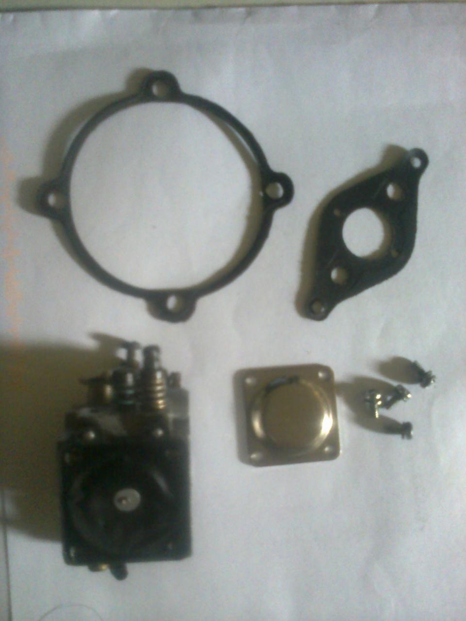

Is fuel meant to enter between the membrane and the metal plate with four screws in the photo below?
I opened the carburator up again today and although I can't remove the membrane and gasket on this side of the carby, I noticed they get moist (some fuel remaining in the carby from yesterday) when I press the membrane. I thought this may be normal (overflow release or something) as there is a little hole on the plate which aligns with where the membrane gets moist. I can't see the perforations in the membrane so they may be very minute.
On the other hand, if this is not normal then I may have found the source of the leak.
You may, Jonez, we need to see some pictures to even guess. There are two diaphragms on the carburetor: one for the fuel pump, and one for metering the fuel. The one with the punched steel cover with the hole in it, that is retained by 4 screws, is the metering diaphragm.

Joined: Jan 2014
Posts: 23
thanks grumpy, yes the meetering diaphragm is the one that permeats fuel. Is this normal?

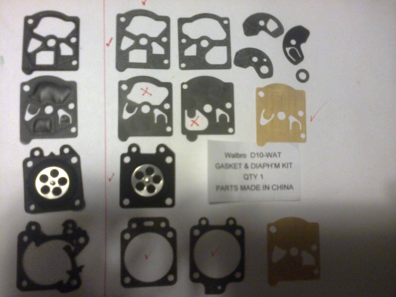

If the fuel is coming through the metering diaphragm, it needs to be replaced. This is easily done - that is a Walbro WT carburetor, and a standard kit for it looks like this:
http://www.ebay.com.au/itm/Walbro-c...DefaultDomain_15&hash=item19e3ec1005
This fits both WA and WT carburetors (the two most common types), and contains diaphragms and gaskets only. For a higher price you can get replacements for more parts. The bits that don't fit your carburetor will be for a WA. Just put them back in the ziploc bag and forget them.
Note the kit has both conventional and mylar fuel pump diaphragms. The mylar ones are used for American fuel, which commonly contains ether (MTBE, TAME, or whatever). Ether destroys conventional diaphragms.
The kit does not contain a replacement metering needle. Inspect your needle and see if the Viton seating part (black rubbery bit on the pointy end) is worn. If it is, you need a more complete kit.
The two gaskets in your photo are Ryobi parts, not Walbro parts. If they need to be replaced, you may have to get them from a junked whipper snipper.

Thanks very much. I have just ordered the kit in your first link (D10-WAT). only over $7. Checked the needle as you suggested: it was'n black but seemed very good. Checked the ebay store from your the link you posted and realised they also had D10-WTA @ $4.80 which seems to have all i need for now, except that the diaphragm looks made from a different material. For the full kit I see they have the K10-WTA. ($13.50) This would have also been under $20 Thanks again, I will patiently wait for my order to arrive. I will put the cutter together and will update the results then. cheers
The fuel pump diaphragm in that $4.80 kit is mylar - it's intended for use where there is ether and/or ethanol in the fuel, as in the US. I haven't tried using a mylar diaphragm - I've seen scattered reports that it is more troublesome than the conventional one, in that it doesn't always work when installed as casually as a conventional one is installed. Since your metering needle is OK, and you don't have signs of lean mixture, you have a good chance of success just by replacing the metering and fuel pump diaphragms with conventional ones the same as the original ones. There are no indications of any problem with your original fuel pump diaphragm, but since you will have a new one, and they do age, it seems appropriate to fit it in the interests of long term reliability.

Got the kit today and realised it was not the closest to my carby. I know you linked D10-WAT for information only but that is also the kit Walbro recommends for WT-148-1, which is the carburetor that superseded mine (WT 148A).
I had a quick look again and it seems D20-WAT was what I needed. The metering diaphragm is the correct one but the conventional fuel pump diaphragm is not the same. However, the mylar diaphragm suits perfectly. I am now thinking: I could order a new kit, I could leave the old fuel pump diaphragm on or I could use the mylar type.
Looking at the old diaphragm, I see it is not very good flexible so perhaps I will try the mylar type and see what happens.
Sorry Jonez, I had not noticed that the two fuel pump diaphragms for WTs were of different designs. Your old diaphragm has stretched to a saggy/baggy condition and I would not re-use it. In that situation I would certainly use the mylar diaphragm. Just be careful to fit it correctly, it is a lot thinner and more easily wrinkled/folded/ creased than the conventional type. With correct fitting I'll be surprised if it does not work properly. Please let us know how it goes of course - I don't recall a thread featuring a mylar diaphragm, so a lot of people will be interested in your experiences with it.
