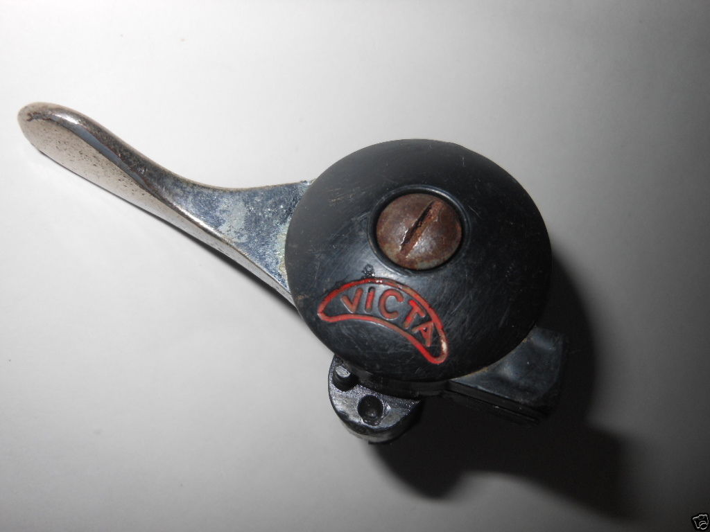

have got a question on throttle, what Model or engine # change had the bakerlite? or Plastic? & steel throttle like the one below?
Cheers.
Are you sure that throttle lever is steel jonesy? It looks to me as if it could be diecast zinc.
Posts: 539
Grumpy, you are most likely right, I should have said metal not steel, it's just not plastic like on my M2, I also noticed the same one in post #49161 of Unkie's on a M5 series 3?
You can tell whether parts are zinc (or if they are not plated, perhaps aluminium) in various ways, but usually I just look to see whether it is a die-casting. Iron and steel are not suited to die casting because of their high melting temperature, though they can be sand cast. Zinc is even easier to die cast than aluminium, and is stronger. Incidentally, for some reason Americans like to call zinc "pot metal".
Of course steel or iron, unless it is an austenitic variety of stainless, is magnetic and few other metals are, so you can usually detect steel and iron with a magnet.
Something we need to research better for accuracy I think.
This is all the info I have from memory,see what you think,we can make adjustments as we gather more concise info:)
Mk 1 and 2 fan,Std Villiers throttle control.
Model 1 and very early model 2,chrome over copper plated cast alloy.
Model 2 full plastic (Black)
Note I am unsure whether the use of a bi material(as per your diagram) throttle control was Victa issue or a repair option for plastic assy due to base failure? Although I have seen many of your type around.
There is evidence of a green(same green as the groove cover) throttle control used on early model 2 rotos but ive yet to come across a real sample.
So black plastic for rotomo 2 and into model 2a. Then the full chrome alloy with the red Victa embossed on the cover which im certain saw out the model 2a.
Model 4 and 5 control same as 2a with the exclusion of the red embossed victa logo.
Fan,Model 1,model 2 are confirmed accurate,just need to see when(IF) your example was Victa issued and also the correct fittment for the red embossed full metal version.
Please feel free to correct any discrepencies,as ive not fully researched throttle controls,only going of what type ive seen on the majority of corresponding models.
