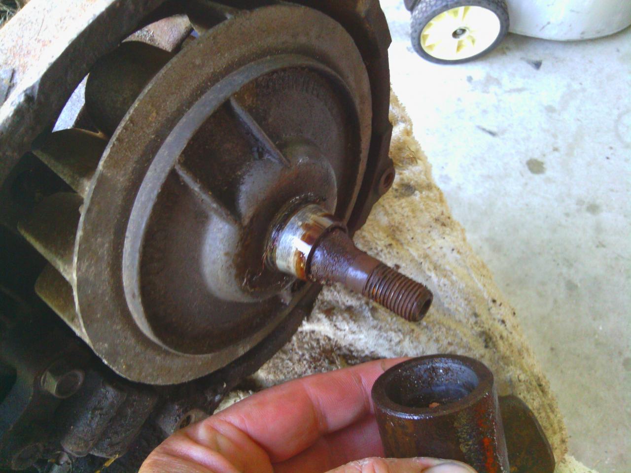

No worries I'll do that today,I will get a photo on as I have another 2 stroke I will be wrecking for parts.

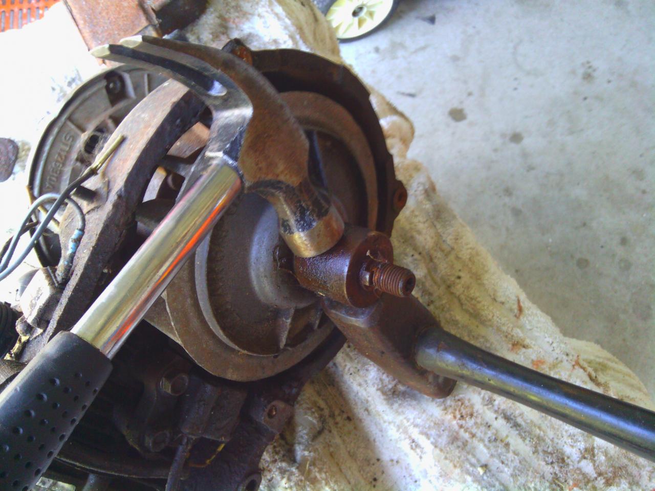

This one took a few more hits because I was enjoying myself. Make sure you sit the block hammer on a very firm base and like Joe Carrol said be very carefull not to hit the flywheel. Cheers.
I'm a bit surprised that little claw hammer did the job, Rob. Looks like either 8 or 12 ounces. To me anything less than a 2 lb ball-peen is a "special light hammer", and anything below 1 lb is a "jeweller's hammer". The only reason I use a 3 lb for jobs like that is that I'm not really all that accurate with the cut-down one-handed sledge.
What I really need though, is a foot of railway line for an anvil. When I search ebay for "anvil" in Melbourne I find a bunch of jeweller's vices with little square flat bits on the tiny cast iron frame. How do you get bits of railway line, anyway?
A claw hammer is definately all thats needed, I used the back doorstep as a anvil until it cracked a while back, I find an air chisel with a modified tip is much better as I dont have to get any other stuff out, just plug it into the air hose and im done...

The air hammer is the go in my opinion because there's a lot less chance of damaging the Flywheel and it's very quick, but the way Joe suggested in the beginning got me out of a spot and is always a good backup.

I haven't tried an air hammer, I agree it is the most controlled way to do it that I can think of though. I'm guessing your method is to use it with an anvil and instead of a hammer, by striking across the boss. I have an idea someone on Outdoorking was recommending supporting right around the circumference of the boss, and striking axially on the end of the crankshaft. That should work marvellously except I'd expect to damage the crankshaft unless it came off pretty well instantaneously.
