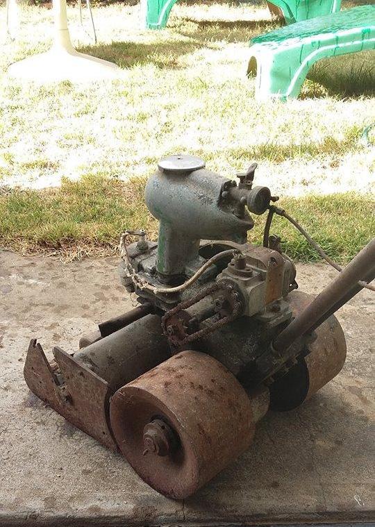

When I had the ads. (but no photos) I could not work out how the rollers were attached. There was no side frame.
How it worked was made somewhat clearer when I discovered the photos (above). There were two rollers at the back
that were affixed to a central gearbox that coupled directly to the motor assembly. This had all-gear drive
to the rear axle! The magneto was external. This was an amazingly advanced mower.
Note how the reel is of a large diameter, thus enabling it to cut taller grass. Also, there appears to be
a quick release arrangement for reel removal for maintenance. The electric machine was a simpler design,
where the reel alone was powered. Only one size was offered for petrol & electric - 14 inches.

An LBL Mower has been found.
Many thanks to Kye Turnbull's BS&S Facebook page for this.

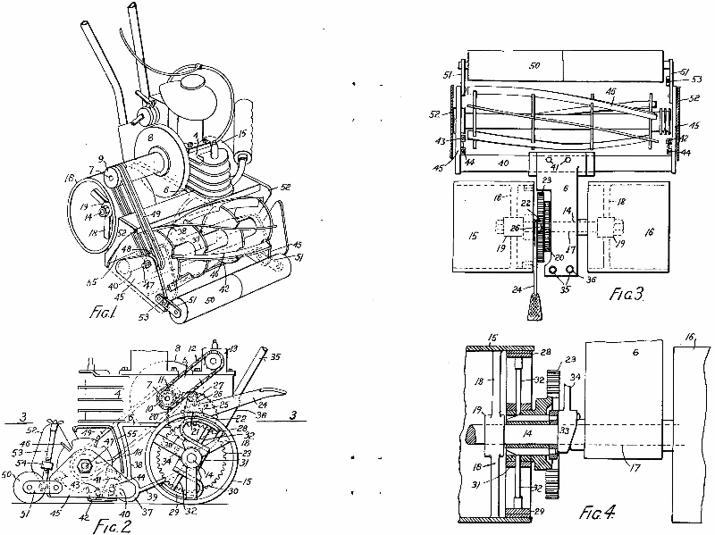

PART THREE - LBL Mower Patent
In 2018 I located the patent for Bishop's LBL lawnmower.
Two inventors are listed:
Arthur Earnest Joseph Bishop and Harold Derwent Lever.
The patent was lodged in March, 1947.
This is the 'B' and one of the 'L's' in LBL!
