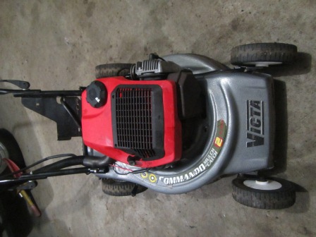

Well I managed to find something pretty decent this weekend in my travels. Well I thought it was pretty good anyway.
A 2 Stroke Victa Power Torque fitted with a key start feature (minus a battery). The mower came with a mulch plug and the new style catcher.
I thought there was no way this engine wouldn�t be scored however close inspection through the exhaust revealed no scoring at all, so that made me really happy! All for a total of 20 bucks!
I fixed the pull cord and bought a battery today. Upon connecting it up the starter motor tried to work however it�s not engaging on the fly wheel. I didn�t get a chance to test the pull start as it was too late however I�m confident it will start manually without to many issues.
I would appreciate some pointers before I start playing with the starter motor to try and work out what is going on.
I would also appreciate some advice as it appears I am missing a piece of the battery mounting gear. See the photos.
Looking forward to any thoughts.
Yes it is a good score for 20 big ones well done. Yes you are missing the top cover for the battery bracket. Which is kind of important as it holds the battery in place. With the starter motor strangely theirs not much different to a car starter. You would really have to pull it off and make sure the throw out gear is engaging and spinning freely. Possible may just need some lubbing up. As it could have been sitting for many years. Also check the flywheel make sure it is clean and free from junk. Oh also make sure it has teeth on it as I have seen some with no teeth. Hope this is of some help.

The best bit of luck you have had there is the key itself, I've seen enough of these pop up, in various conditions, roadside, or at tiny's, however 9 times out of 10 the key is missing, which, well, you could always buy an alternative key switch, but really, it's a lot off hassle that comes from a small peice of missing metal.
As blumbly said, your start point is the motor, it could be as simple as gunk jamming the drive cog, causing it not to descend, engaging with the toothed rim of the flywheel, or a matter of the teeth having work or broken on the starter motor, or even a segment of the flywheel (although this is less likely)
or, the gearing system within the starter motor could have failed, the starter motor can be broken up to three active area's, the motor, the reduction gears, and the engagement gears.
The Motor is a high torque electric starter motor, the reduction gears lower the speed of the output drive, and increase the torque, and the engagement gears lower down when starting, engage and turn the flywheel, then retract after starting.
In this diagram, (A) is the Motor (B) is the Reducing Gears and (C) is the engagment gears.
