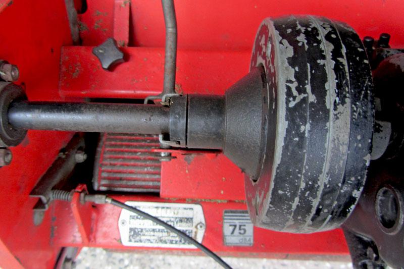

Here is a picture of my Rover also..
Almost all parts are available from the OutdoorKing store and are competitively priced. The thrust pad is available
HERE. The early SB45 thrust pads were made from brass, but the plastic ones are fine if the adjustment is correct. I'm not quite sure what you mean regarding the drum clutch release lever but you can see it in my photo also. If you'd like some pictures from inside the chain case, just let me know. The exploded parts diagram will also help.

Yes, the thrust pad sits inside the clutch fork and doesn't touch the inner clutch cone when it is engaged and cutting. When you disengage the clutch, the fork moves the thrust pad along the drive shaft until in contacts and pushes the inner cone in.
And I agree it looks like you're just missing the nut from the drum clutch lever.
