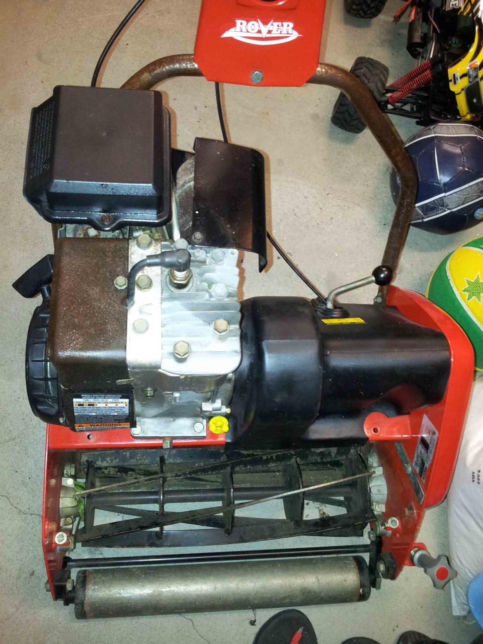

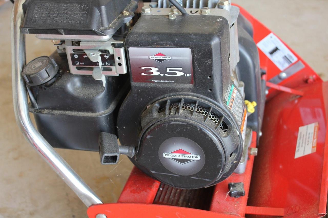

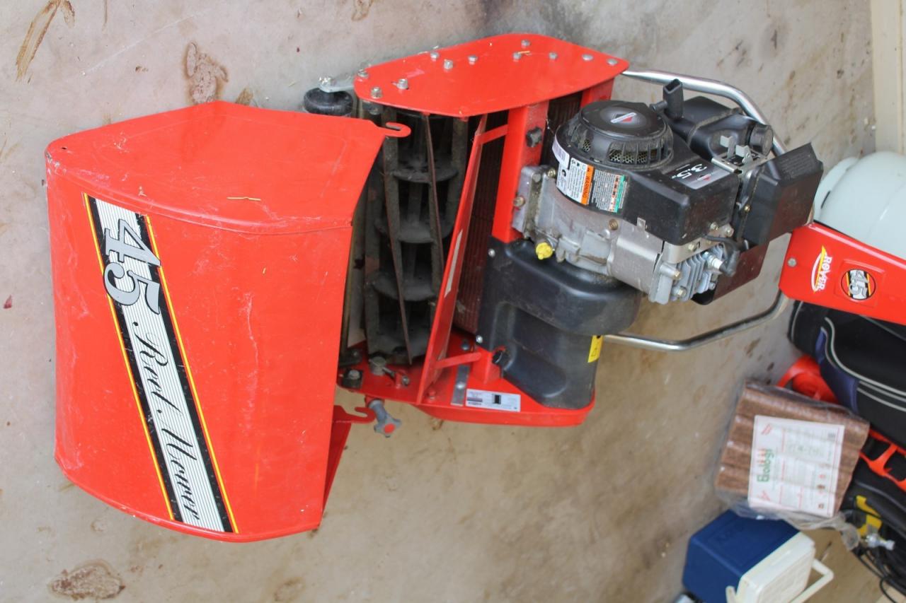

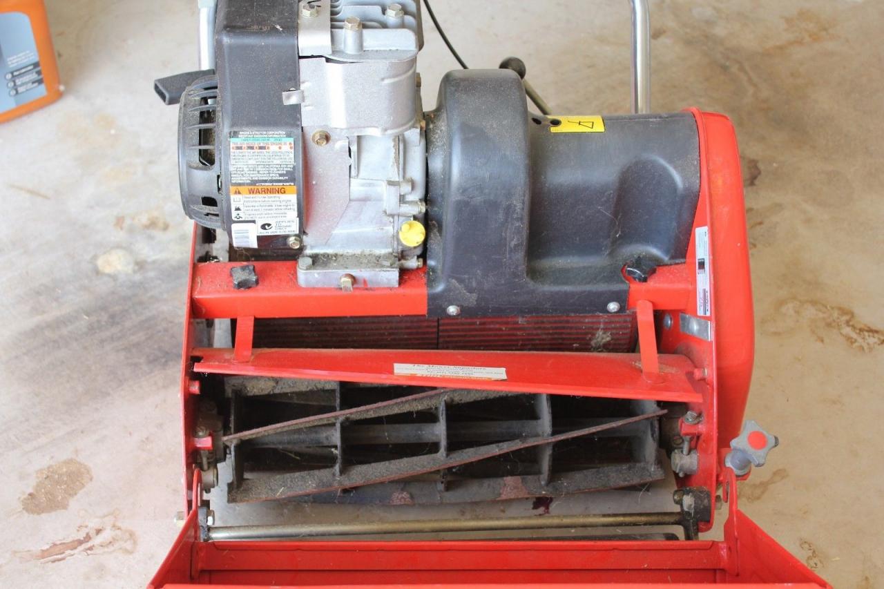

Please see the photos here. One of the blades look slightly bent & reel is rusted from not used but other bits & pieces look clean.
Probably need servicing on the reel and bedknife, may be $100-$150?
Hi again lovemygreen, and thanks for posting the pics.
Overall, it seems to be in good condition. wink
Some things I have observed:
The grass deflector is installed incorrectly...on side is hooked under the catcher attachment lug. Just release the other side and straighten it up.

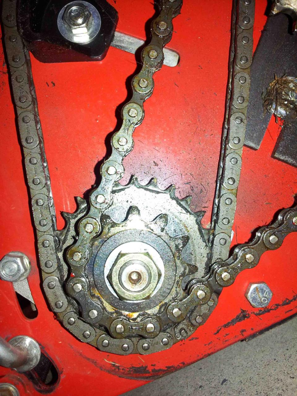

I also would like to see a pic of the bent blade....one of the chains and all sprockets (especially the small top primary chain sprocket). These are located in the chain case on the left hand side of the machine. Just remove the cover.
Please take a pic where the sprocket is not covered by the chain...so as we can see the teeth. wink

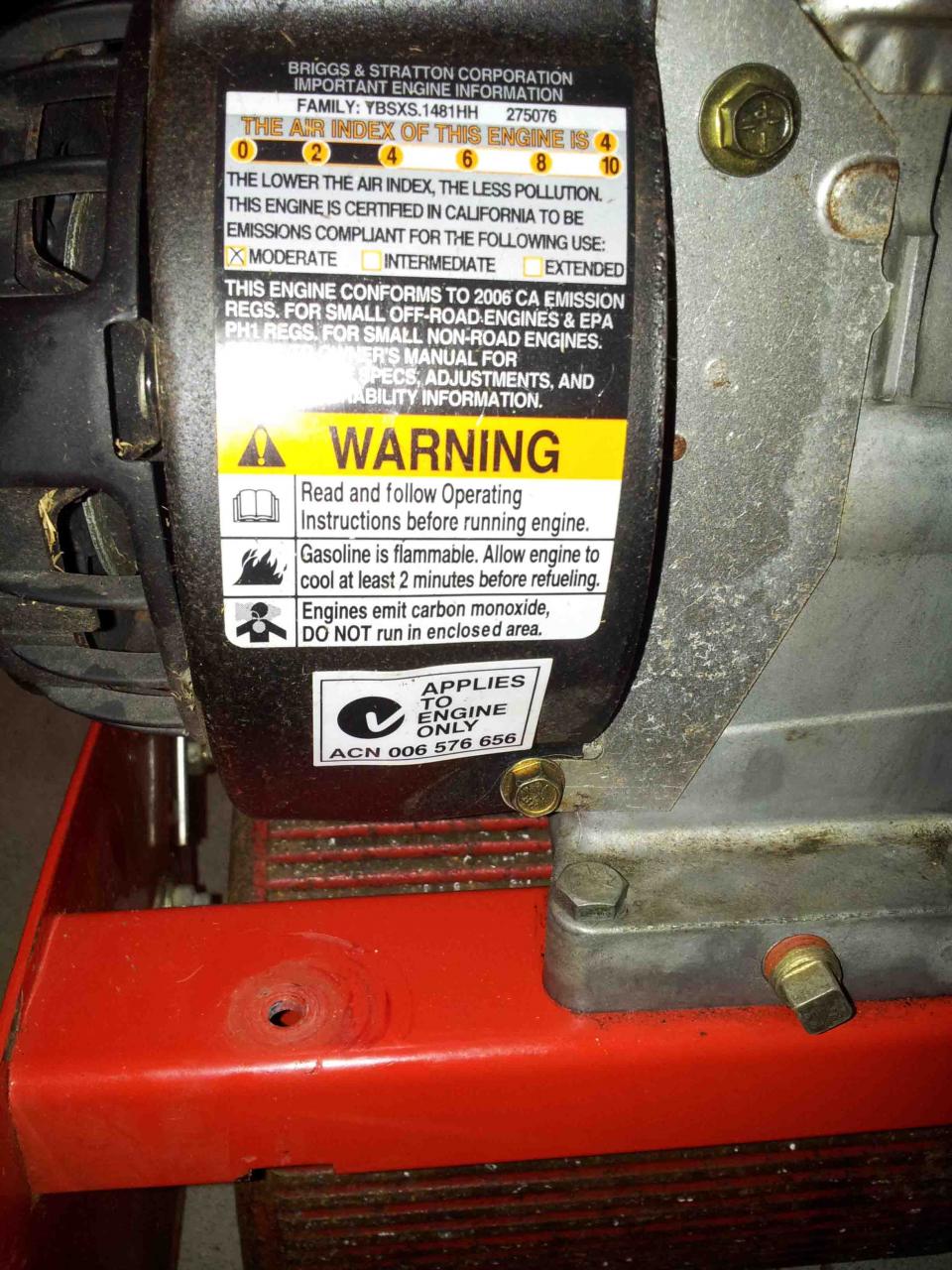

Finally, the complete string of the long series of numbers stamped on the cooling air cowl of the Briggs. They will be grouped into Model, Type, and Code. We can then tell the date of manufacture of the engine.
As for price...$500 -$700 is about right and $100+ for a spin grind. The engineer will be able to straighten the blade if it is not damaged beyond limits. wink

The Rover 45's were all made locally. As Darryl has suggested, the string of numbers stamped onto the side of the Briggs engine indicate configuration and date of manufacture. The numbers are grouped into 'Model' 'Type' and 'Code'. The first two numbers of the code are the year of the engines manufacture and will give you a rough idea of when the mower was made.
Appearance wise, it's consistent with a late model Rover. It looks like a later model Briggs engine, has the newer style Rover logo on the decals, plastic cover over the clutch assembly and ID sticker on the side of the frame (rather than ID plate riveted to the rear rail).

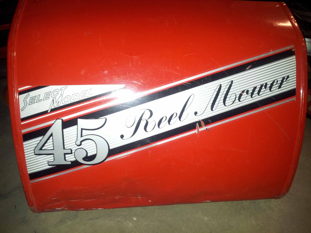

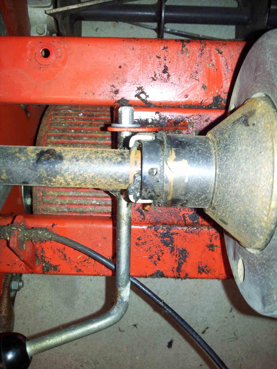

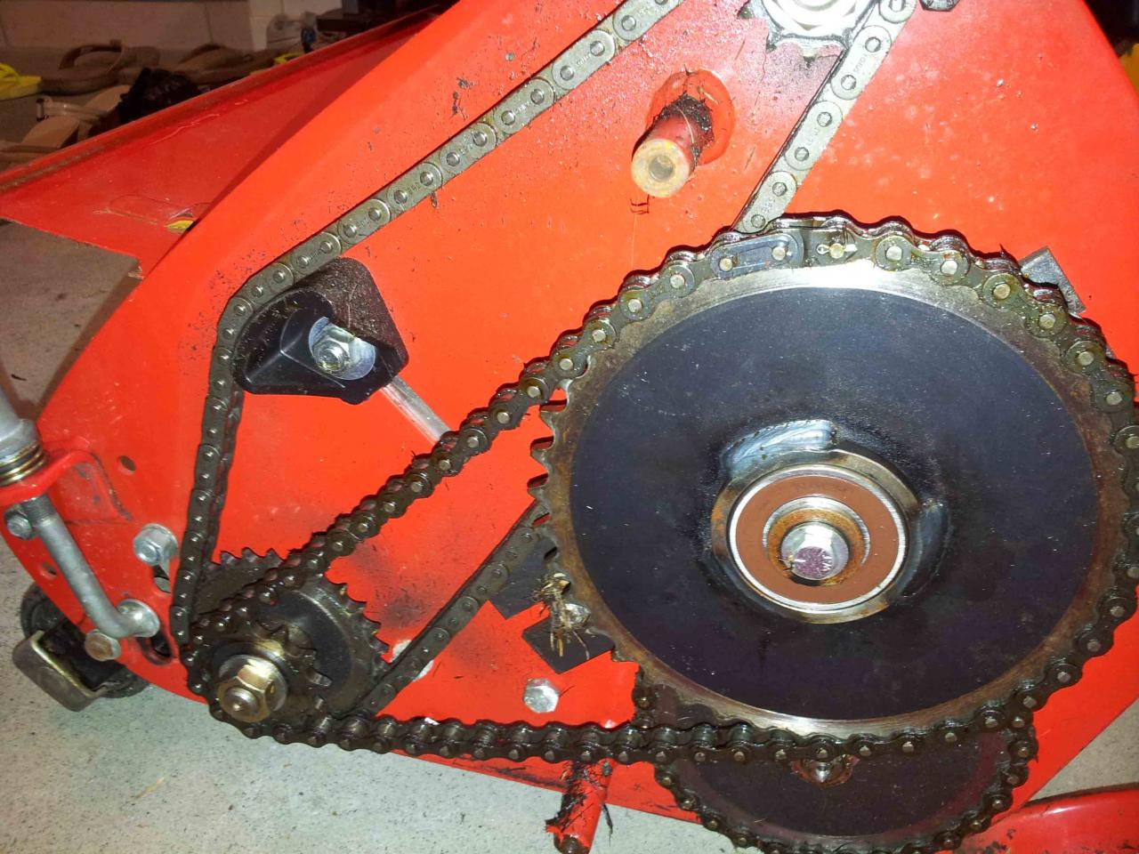

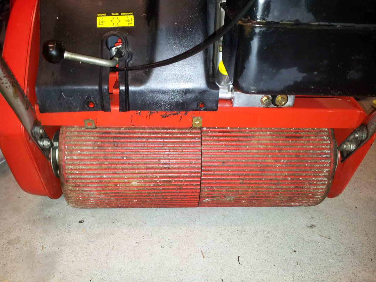

Thanks Michael for the reply. Went a bought one.. not the one above.

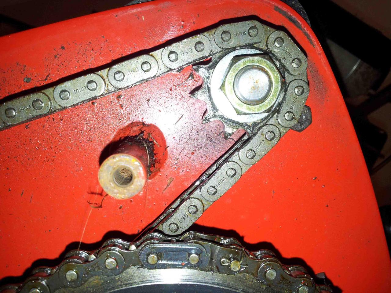

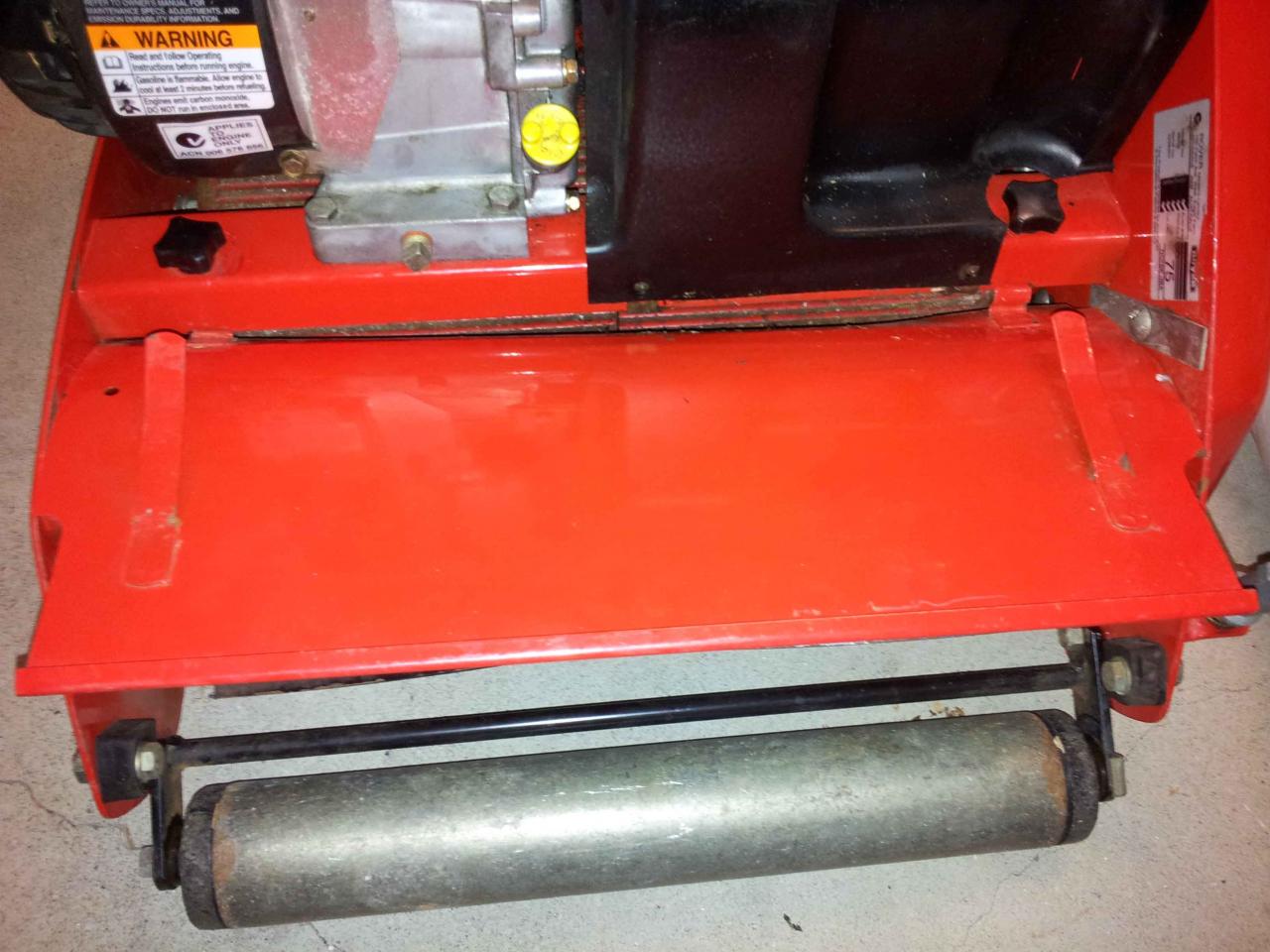

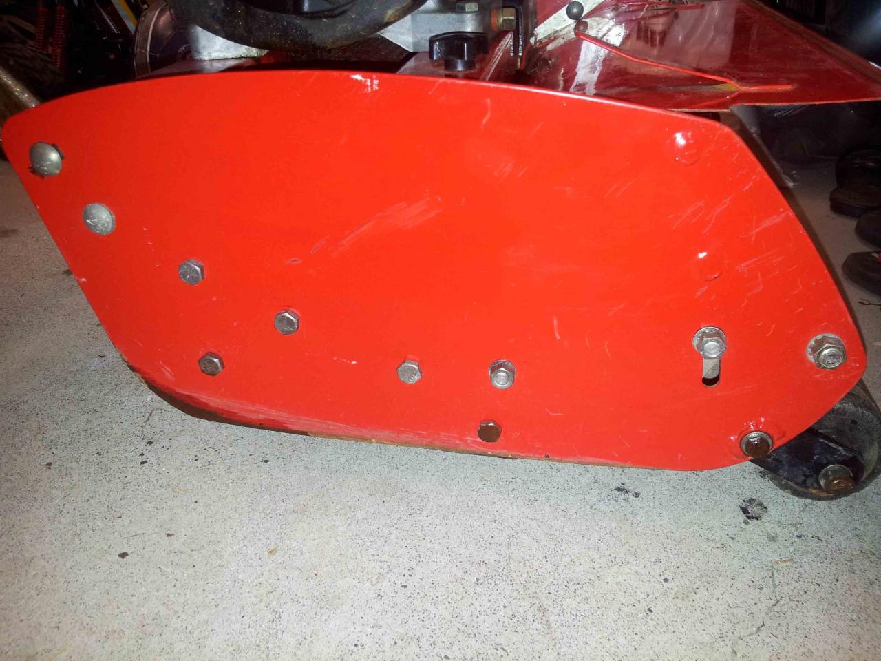

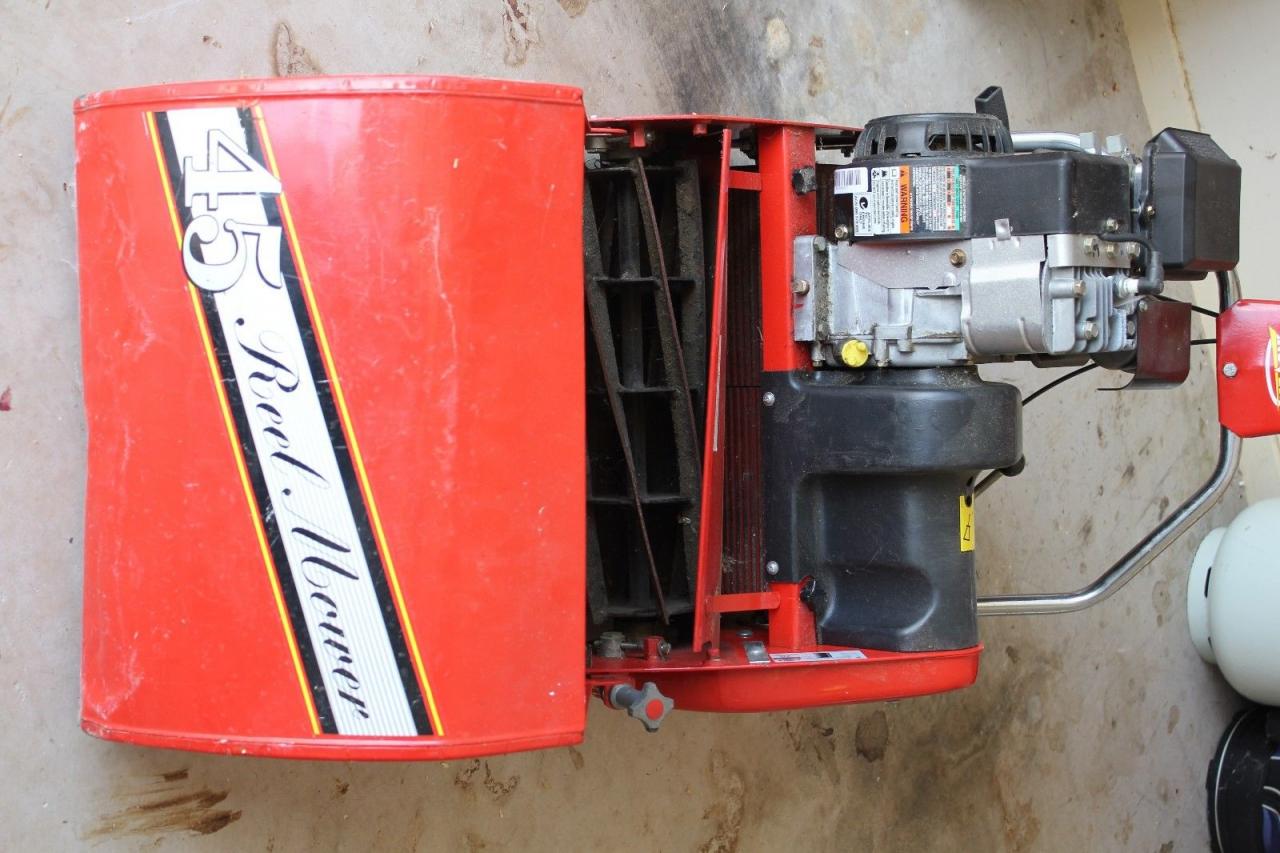

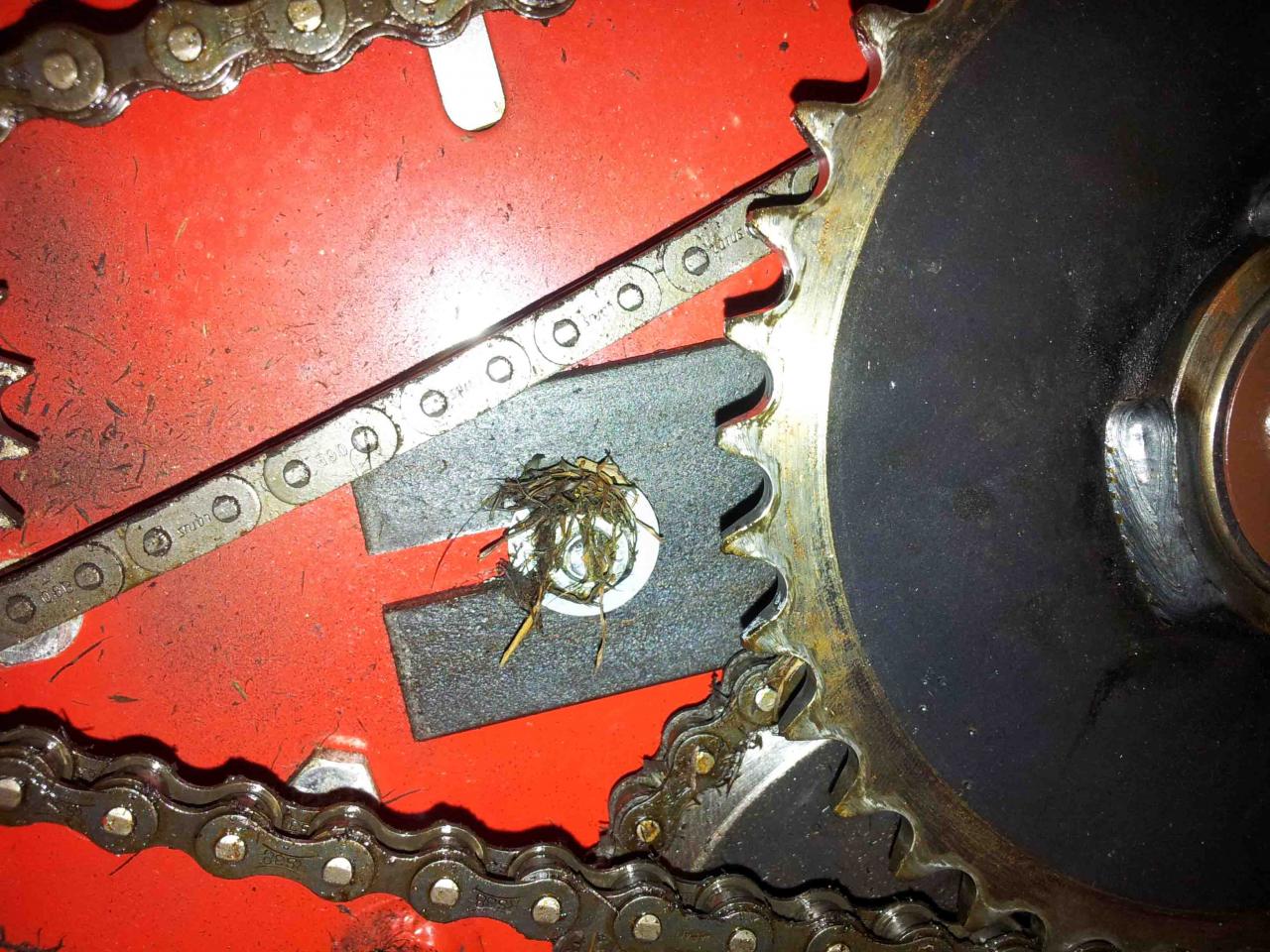

Please see photos. Looks quite 'new', engine cover is a little rusty prob because it was not used for a while.
A few questions please:

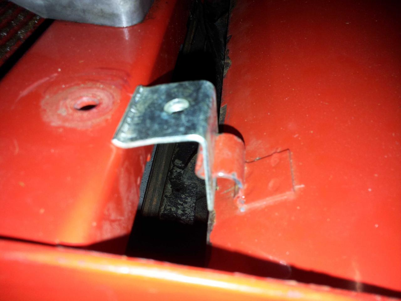

1. The grass catcher, I could not push it low enough to hook the two tabs or blades to use the screw to hold it in. Is it because of this model?
2. The clutch cover does not have any hole on top for oil. Can I just drill 2 holes there? If so do I need to cover it up with tape or something? You can see that owner has not oiled it so the clutch thrust is melted a little

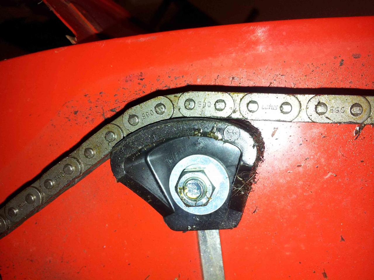

3. manual says use chain oil to oil the chain. What type of oil? The photos show the chain & gears are quite good condition, you think the teeth are in good condition?
The chain tension plastic on top hardly have any wear on top.
Handles are a bit rusty, prob owner left it in shed for too long.
Thanks again.
Hi again lovemygreen, Firstly, congrats on your becoming a Rover 45 owner. good1 Can you please post the Model, Type and Code numbers stamped on the air cowling of the Briggs....we can then give you the date of manufacture. wink
Now to your problems;
The silver tag you are trying to fit to the bottom of the grass deflector goes underneath the front rail in the position of the hole and the black screw knob fastens it there.
You then roll the grass deflector behind the reel and the 2 short tabs on the bottom secure it to the top of the soleplate (the bottom blade holder) and the 2 longer tabs at the top of the deflector slide through the small cut outs in the front rail and you adjust it to the correct position.
Here's a pic, this is not my machine, but you will get the idea. wink
The catcher then hooks to the 2 fixed lugs attached to the chassis side frames. You can see them in the pic at the front edge of the deflector.
I have had a look at the chains and sprockets, and unfortunately the small (top) primary sprocket is reaching the end of its life, as is the double cutter sprocket (the inner primary side especially). These will need to be replaced as will the primary chain. This has been caused by the chain being way to tight and incorrectly adjusted
The cutter clutch is also out of adjustment causing the plastic thrust pad to melt...this pad will need replacing, and you will have to remove the engine and clutch assembly to complete the task. wink
We can help you through the procedures to complete these tasks yourself. All parts are available through the OutdoorKing online store. grin
Re: drilling the protective cover...I myself wouldn't, I would remove the cover to oil the machine and inspect it for serviceability at the same time.
I personally use a good quality grease on my chains, you can see my video...Click HERE

The little issues with the machine that Deejay has gone over are fairly common and easy to fix. I've just purchased sprockets and chains for my SB45 resto and the OutdoorKing store is competitively priced. You shouldn't have any problems keeping the parts costs to under $150 and once they're replaced and adjusted correctly, they'll give many years of service if maintained. If you're planning on getting the reel and bedknife sharpened soon, I'd wait until then to change your sprockets and chain, as they have to come off anyway. The clutch thrust pad is cheap and easy to change so you may as well do it asap.
cheers2 Michael
Hi Michael, and thanks for confirming my diagnosis. grin
Lovemygreen, Just to give you some info when ordering;
Primary Chain: (engine shaft small sprocket to inner cylinder reel sprocket) : 3/8" pitch
All the other chains are 1/2" pitch
To remove the engine and clutch assembly to replace the thrust pad....check out the video....Click HERE
