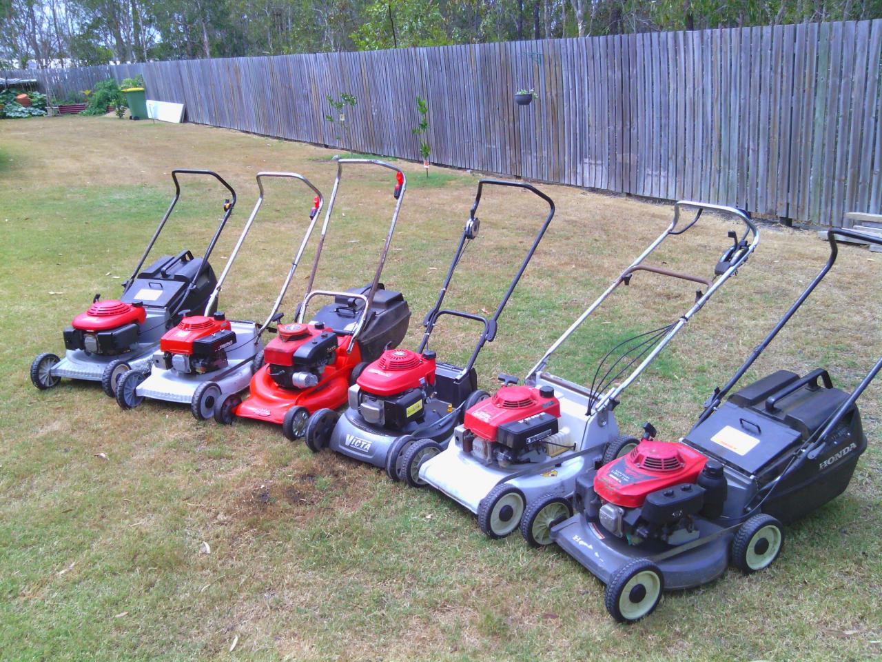

Those are good-looking mowers, roebuck. The one second from the right looks like a 21" self-propelled with the 4 hp engine, which would be an unusual choice I'd have thought. My favourite engine, but there has to be a limit to what 4 hp can do, especially on hills. I think the other 4 hp, second from the left, would be my choice, but the 5 hp on the far left is probably the nicest to mow with. Now, if it just had a foam pre-filter ...

The 21"self-propelled (hru 214 /gxv120)second from right, I picked up for $50 and boss has made it hers. It has a mulching plug a soft catcher and a tin grass box that fits like a catcher but it throws the grass to the left and does a nice job. On the far left (hru 195/gxv140) and your spot on it is the best to mow with, very quiet and smooth. The (hru194/gxv120) second from left was the last one I worked on and does a very nice job. They all leave the grass looking good ,even the (hru196/gxv160) on far right but its a work tank and a bit more effort to push around.

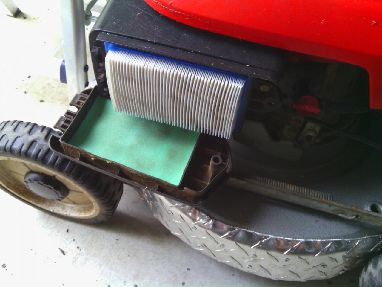

Grumpy, I'm sure I put a new pre-filter in the gxv140 ,I'll have a look .cheers.

That GXV140 air cleaner is the same as mine (there have been two designs, the side-mount and the top-mount), but I've never seen that sheet of foam between the filter and the housing. I'd better take another look - if I can put one in, that engine's last bad feature (apart from the plastic camshaft) will disappear. Well, I don't like the starter either - compared with the GXV120 and GXV160 starters, it's a bit tin-pot.
