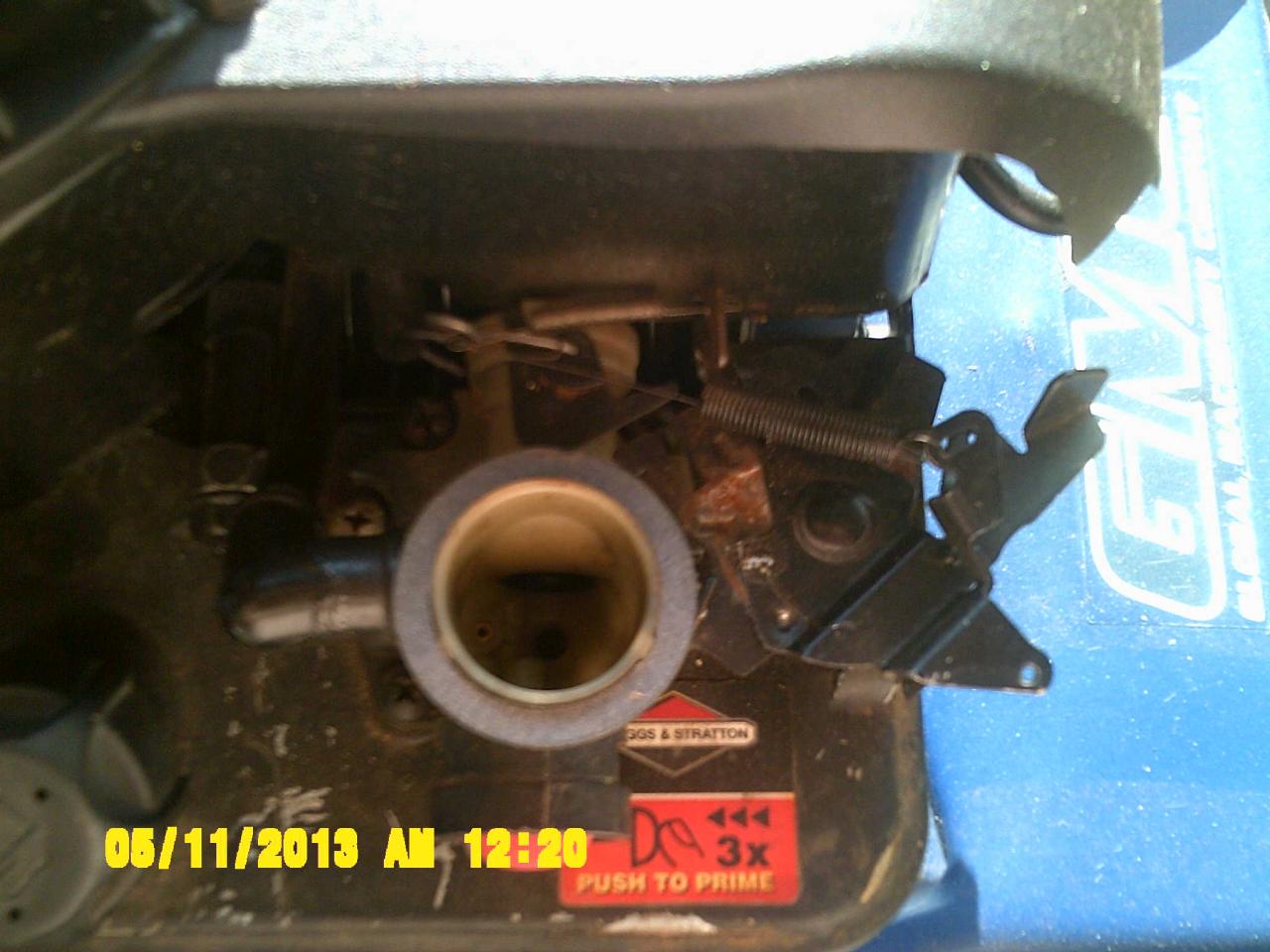

i can now get it to run if i put pressure on the spring that connects to the carby butterfly but it stalls as soon as i let go
how do i adjust the spring so it holds the butterfly open so this will run?
so you have had the tank off ? make sure the bellcrank is on the right side of lug on inlet tube / manifold or it will run flat out or not at all . try for a good picture of the carb and linkages , east to tell then might be adjustment as they do still have a little smile [Linked Image]
Joined: Jun 2008
Posts: 202
I Brew The Beer I Drink
well i finally got it to run
just had to bend where the spring is connected next to the throttle cable
kind of hard to explain without photos but camera is on holiday with friends that dont have one.
cheers, Daniel
Cheers, Emmo
is it beer-o-clock yet
Sounds as if you adjusted the governor speed setting, and Dave's diagnosis was correct.
