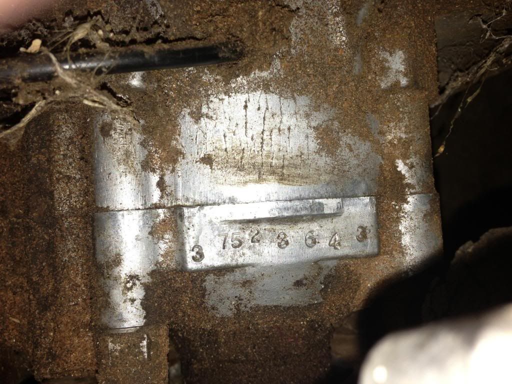

this is the engine number
[Linked Image from i24.photobucket.com]
can anyone identify this mower as it sits?, I think it may be a bitza
can anyone confirm this the wrong engine for this mower?
what engine should a 509 Utility have had in 1964?

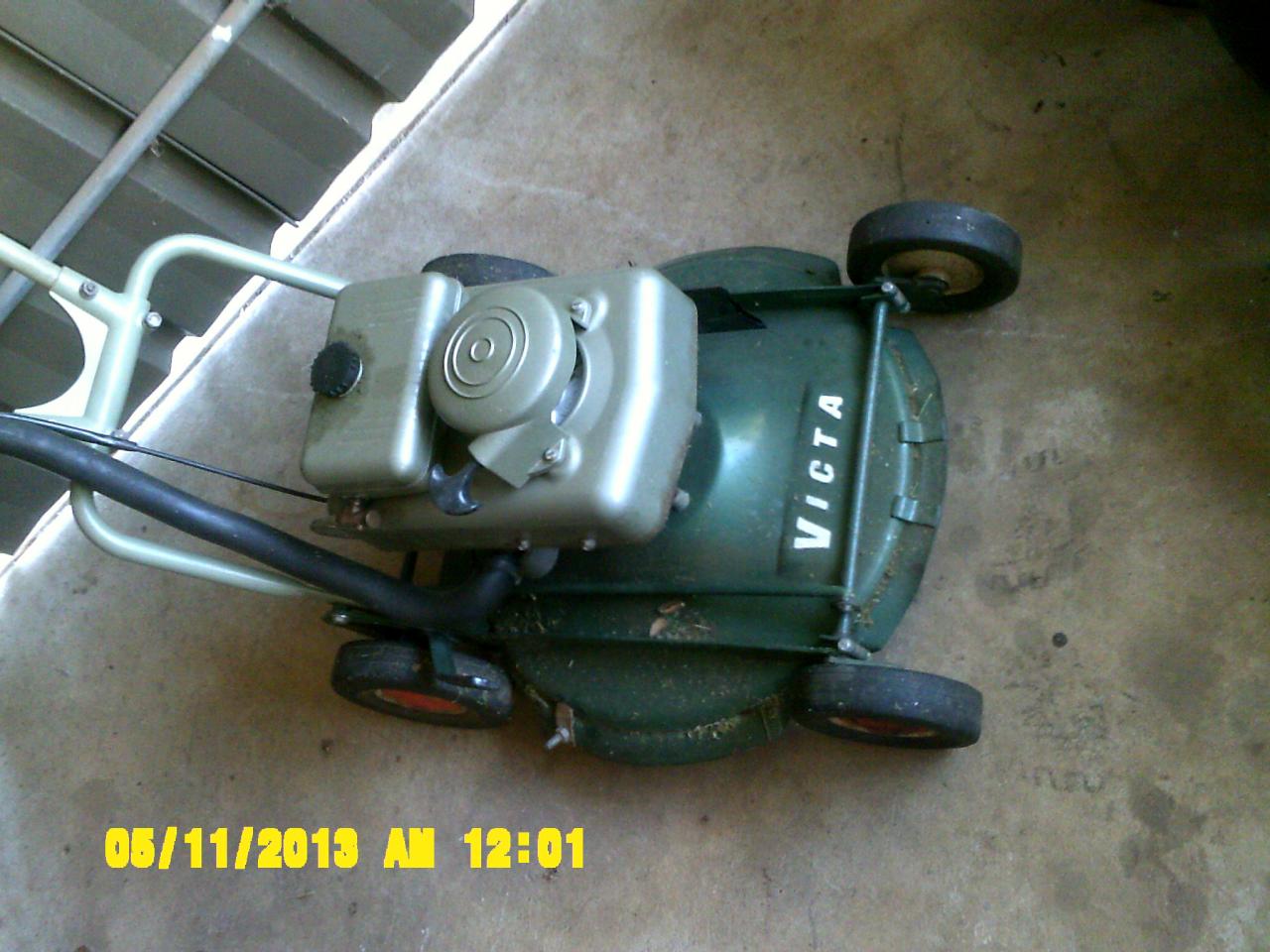

as best i know , mine is a 67 540 might help maybe smile [Linked Image]
all correct as far as i know too , just been used lately a great machine so i hope yours do as well cheers2
it wouldnt have had a decompresser im sure , 2 corvettes i have dont and they are 67 68 . one i just picked up 2 weeks ago , seemes all orig' too

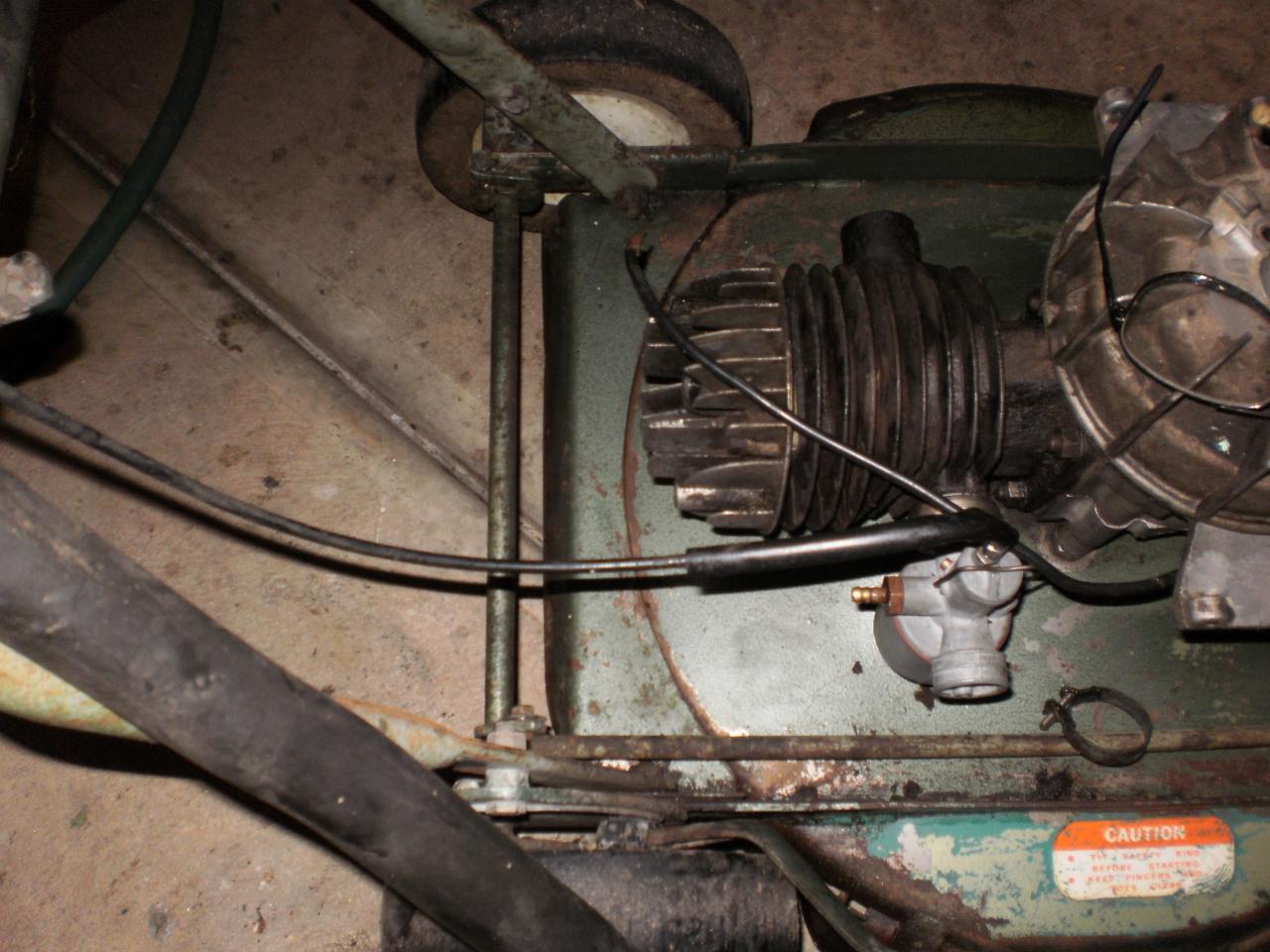

Paul
Paulwolf350 #50204 03/11/13 05:52 AM
sorry , its the best i can do without pulling it apart . but if its needed ? cool
looks a lot like that yes , and it is a 125

It seems to have the correct, flywheel, cylinder and carby, but the wrong crankcase and head, wither way if you're not after a concourse resto you'd get away with it laugh

Hey paul looking at the cylinder head on your mower looks to be a 160cc. its got the right flywheel ect as the other guys said. but the wrong
size engine.
tomo4192 #50211 03/11/13 07:37 AM
Joined: Oct 2013
Posts: 11
I am going to run the earlier 125cc engine now, as i believe it is period correct (as it is not exactly the right engine) but should be the same type.
The 70 series engine in the first pic is gone, replaced with the one in the second engine pic.
It too is a bit late in the run 1.1 million serial no (prob about 68-69) they should have been about 750 thousand in 64.
Anyhow, that's whats going in unless someone gives me one with the correct serial no wink.

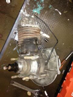

cheers man, if you wanna sell it , trade it or donate it, let me know laugh
I have few of these engines from a parcel I bought on the weekend.
Hopefully get into the resto soon, just waiting on my blasting cabinet to arrive.
Paul

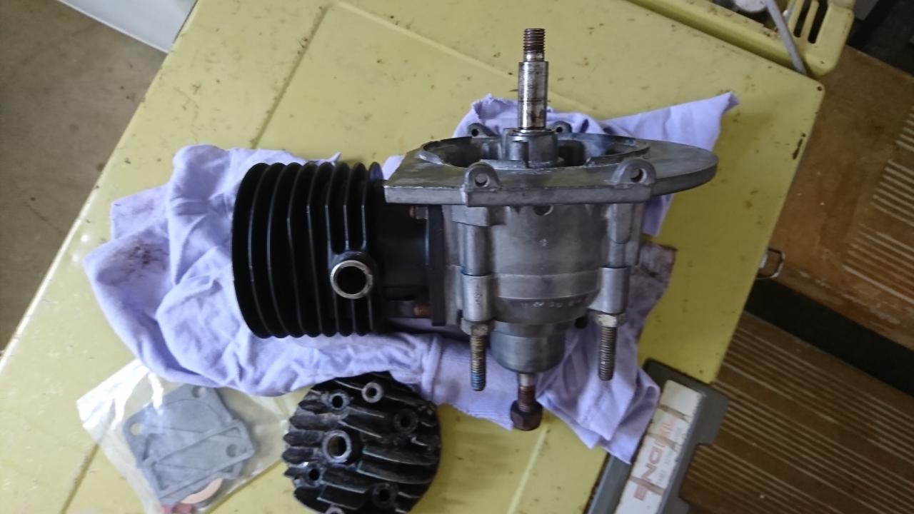

Paulwolf350 #81378 17/01/17 08:22 PM
Joined: Oct 2013
Posts: 11
One of those motors was indeed a 364 serial number, so that motor was put aside for this project. It is starting to come together, finally (lol)
It's far from perfect, but I'm really happy with how it is looking
