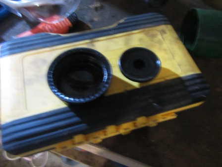

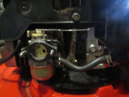

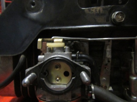

I�d appreciate some suggestions as I think this mower has done very little work. Some photo�s below for everyone�s reference.
Oh and I forgot to mention that I should I bit in the fuel tank that looks like its come loose from the cap�������..

Thoughts on the fuel cap photo's? Something definately looks wrong.

I was also after confirmation if my fuel cap is stuffed. Perhaps this could be contributing to the low speed issue. See photos in previous post.

To make the process easier I have included an extract from the manual detailing the carby setup.
The mower usually starts first pull when cold and if I move it to full speed from the choke position it runs beautifully��.but as soon as I move the thottle leaver it starts to hunt and high and low speeds. I hope this makes sense.

Well I completed the flow test with the carby bowl removed last night and I am now confident I need a new petrol cap, unless of course you think otherwise.
So the result went like this:
1) I opened the fuel tap and the stream out of the carby bowl was steady, then after about 5-6 seconds it started to splutter, however when I took the cap off the fuel flow returned back to a steady stream.
2) When I tightened the cap back up after 5-6 seconds the fuel flow started to splutter again
So from this test I gathered the part of my petrol cap from earlier photos definitely has a purpose. I do apologise for not conducting this test properly in the first place. With the carby bowl removed the results were much more obvious.
Secondly I noticed a feature in the manual about setting the throttle linkage correctly. It specifically referred to the governor arm mount being would clockwise before installation with the throttle butterfly in the open position. I might need to repeat this process if you think worthwhile.
Thanks for that very clear report, Jaffa.
First, it seems certain that your lean mixture problem stems from a fuel cap malfunction. I suspect that by screwing the cap right down without that spacer piece that had fallen out, the fuel cap vent did not operate. You may find that you can re-attach the loose bit and get it working again. Of course a new cap would work even better.

5) Installed my new fuel cap and spacer. This spacer didn�t fall into the tank so that was a plus!
