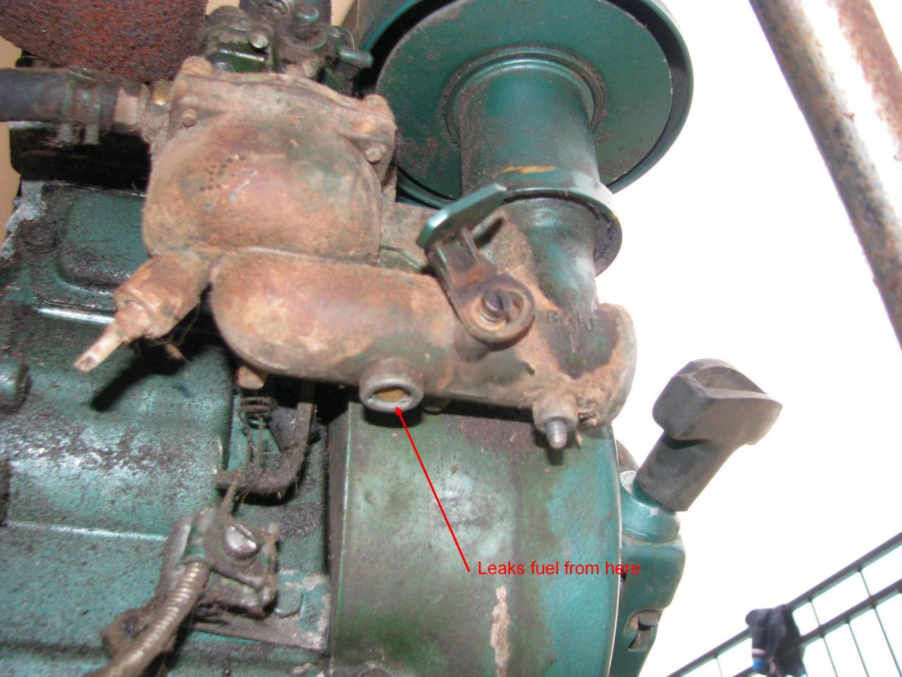

I have a 17" model serial #11961 and engine 81332 0677-01 7806220 which worked OK but haven't used it for a few years. However now I can't get any spark out of it and the carbie leaks fuel (see photo)

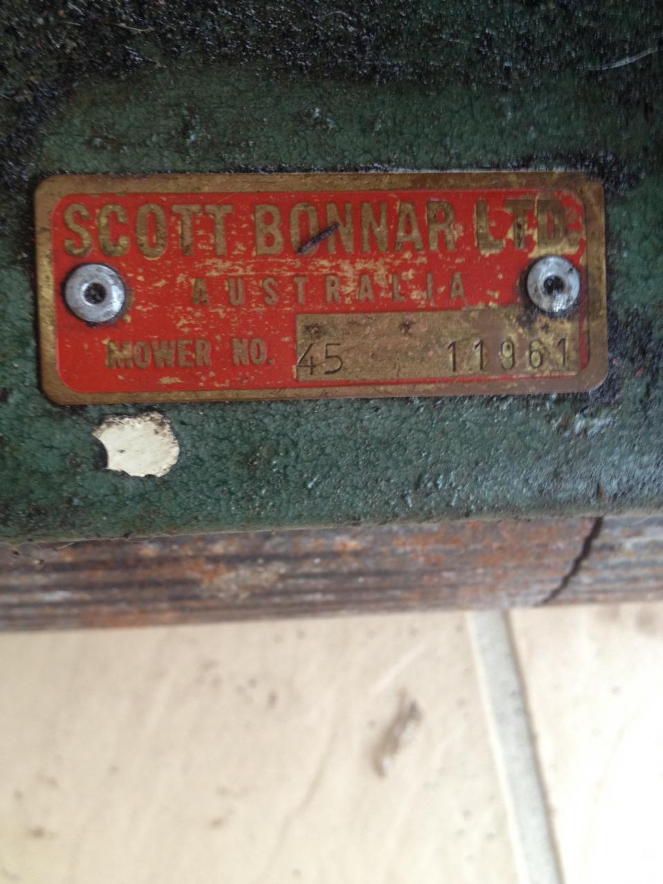

I don't know if it's just the photos but your machine looks wider than a 17", it looks more like a 20" with the 8 blade reel - but I may be wrong. As an early solid deck version it's more desirable than the later twin rail types. Going from your Briggs code the engine was manufactured in 78 and not likely to be original on a solid deck model 45. Hopefully someone else can clarify this for you.

It's hard to say mate, I have a solid deck SB45 here made in 1969 and I have a twin rail from 1974, so I assume the changeover to twin rails was early 70's. Yours is obviously from before that changeover so maybe late 60's or early 70's as a rough guess. Deejay can hopefully narrow it down for you.

You have reported two faults in your engine: no spark, and petrol dripping from the underside of the carburetor.
Your engine will have been made prior to 1982, and hence will have breaker point ignition. From what you said I gather it was working when you took the machine out of service a few years ago, so the problem is probably not due to a failed electrical component. It is more likely to be a corrosion issue, or an incorrect control setting. We can talk about a test program aimed at identifying the fault if you wish.

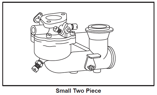

The carburetor is called a small two piece Flo-Jet:
I do not recall the feature the fuel is dripping from, but it looks like a Welch plug blocking a hole in the casting which was used to support a sand core when the casting was made. It is normal to have a small amount of liquid petrol in the carburetor in that location, but it should not drip out unless there is a sealing problem around the Welch plug. However if the fuel is coming out in quantity rather than as a rather slow drip, it would indicate that the carburetor is flooding due to a float bowl problem. If you left it for years with fuel in it, there will be quite a bit of gum throughout the carburetor, and it will need to be dismantled and cleaned. If the fuel you left in it happened to contain ethanol, the damage might go beyond some gum to be cleaned out.

Your machine is an early 20" machine with an 8 blade reel (that was standard fitment) and the 3 segment rear roller and solid engine deck.
It also has the brass SB ID plate riveted to the deck, which again points to an early machine. My best guess would be 1969.

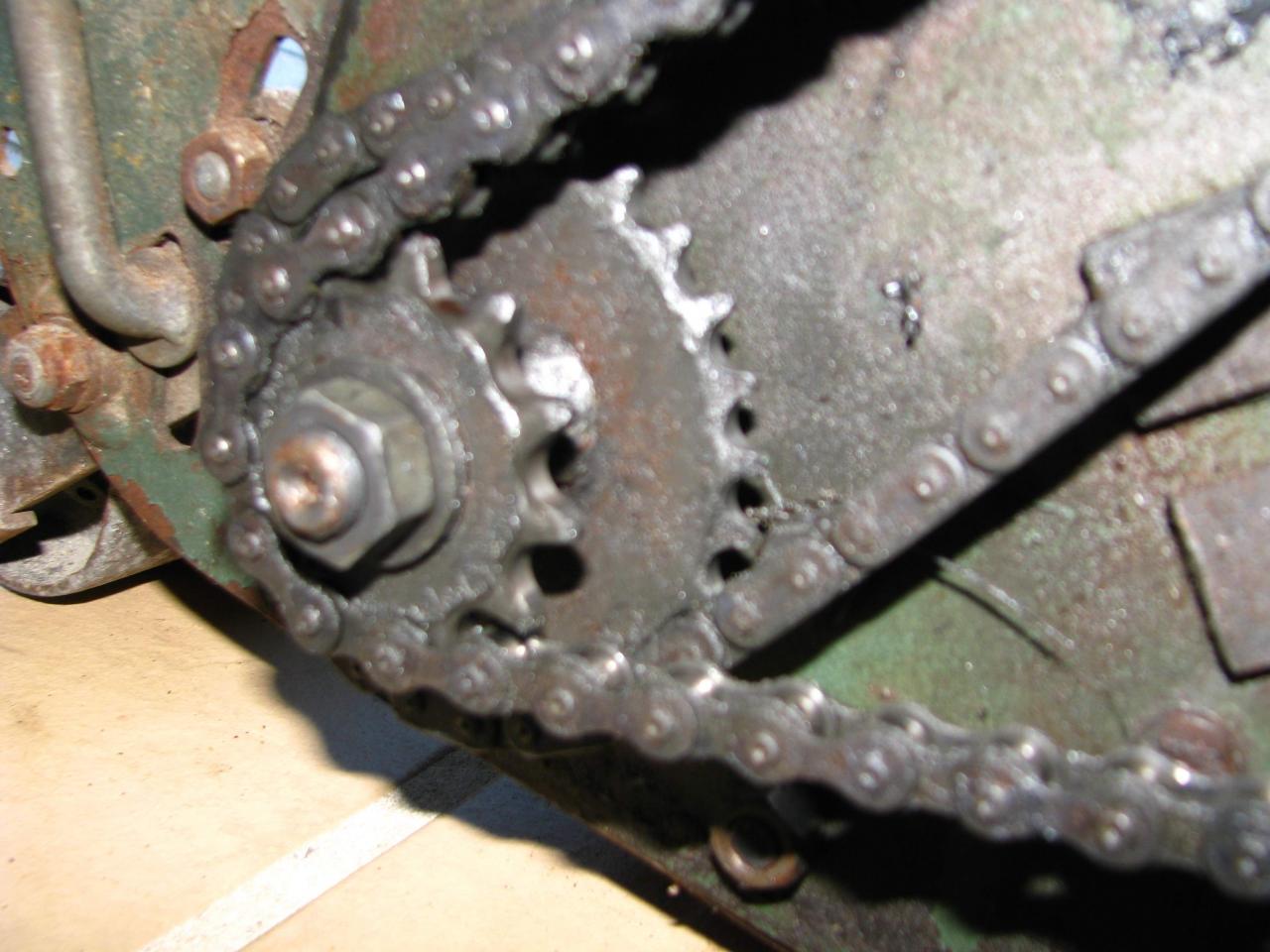

I would like to see some more pics with the chain case cover removed, and some close-ups of the sprockets where they are not covered by the chains...particularly the small top sprocket on the primary chain...We can then assess their condition.

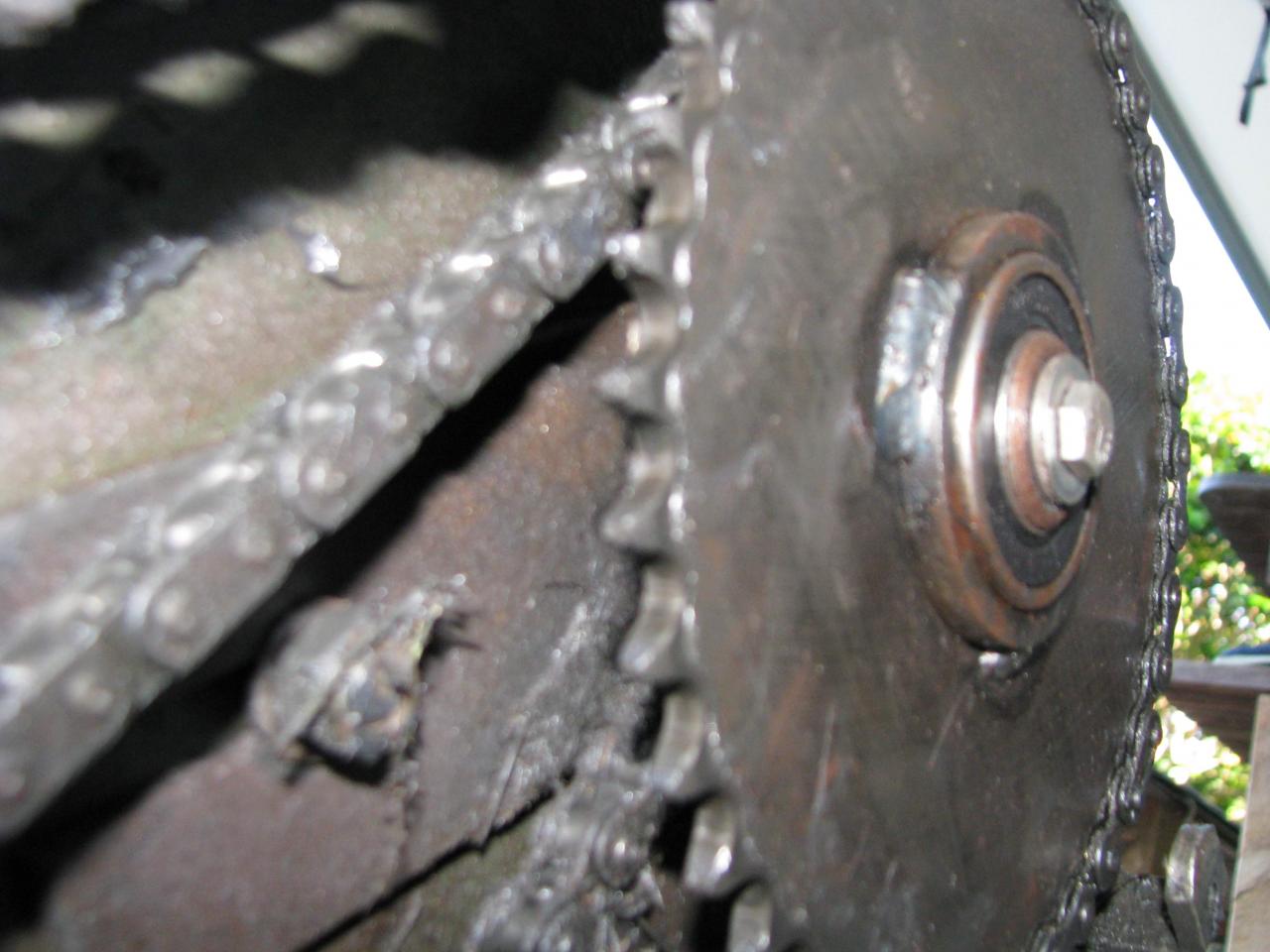

Photo's pf the chain sprockets
Thanks Jim for posting the pics....the top sprocket is worn (as I thought it might be) and will need to be replaced as the tips are 'pointy' and the primary chain will also be worn and stretched. These parts are available.

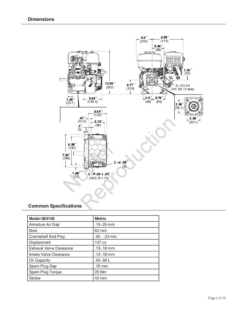

Attached is the B&S product service information for the 550 series I received from the place selling them. Apparently it is dimensionally a straight swap for the old engine. I have the PDF if you want it for the library
