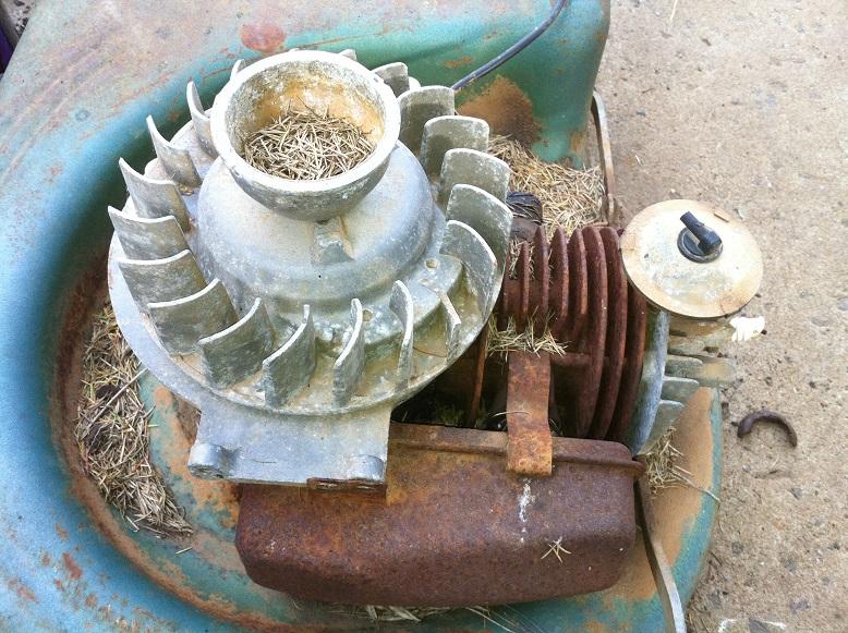

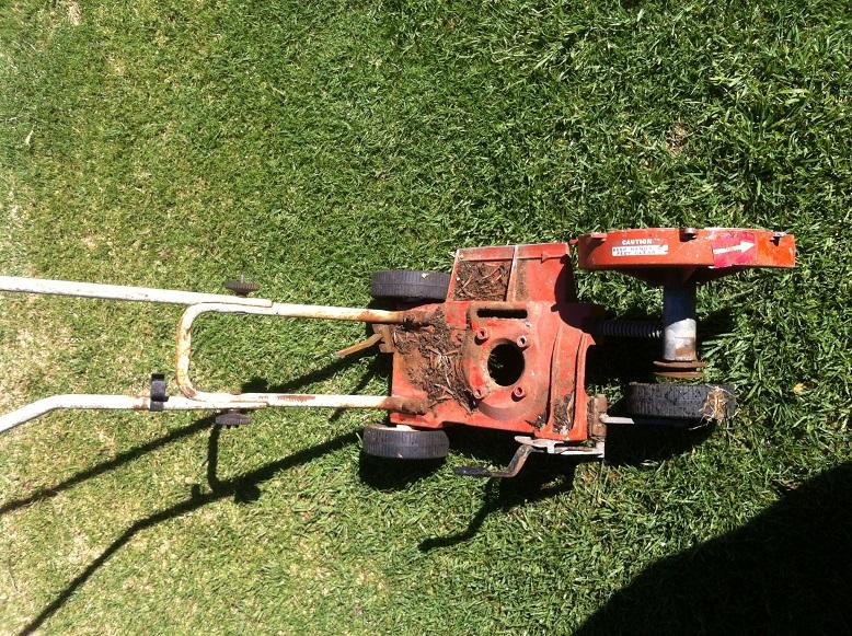

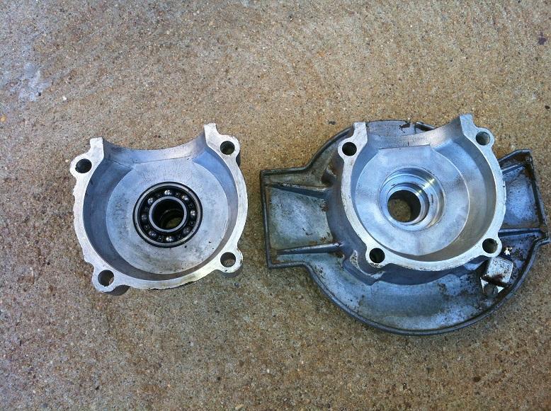

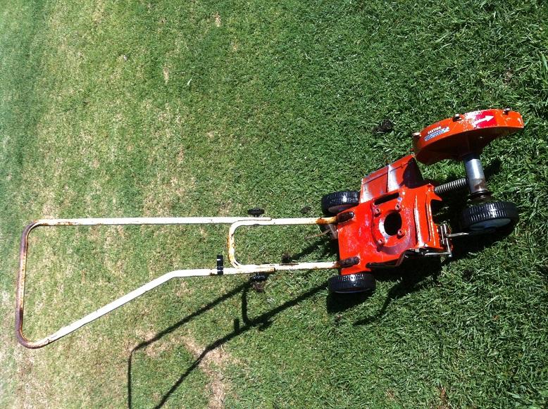

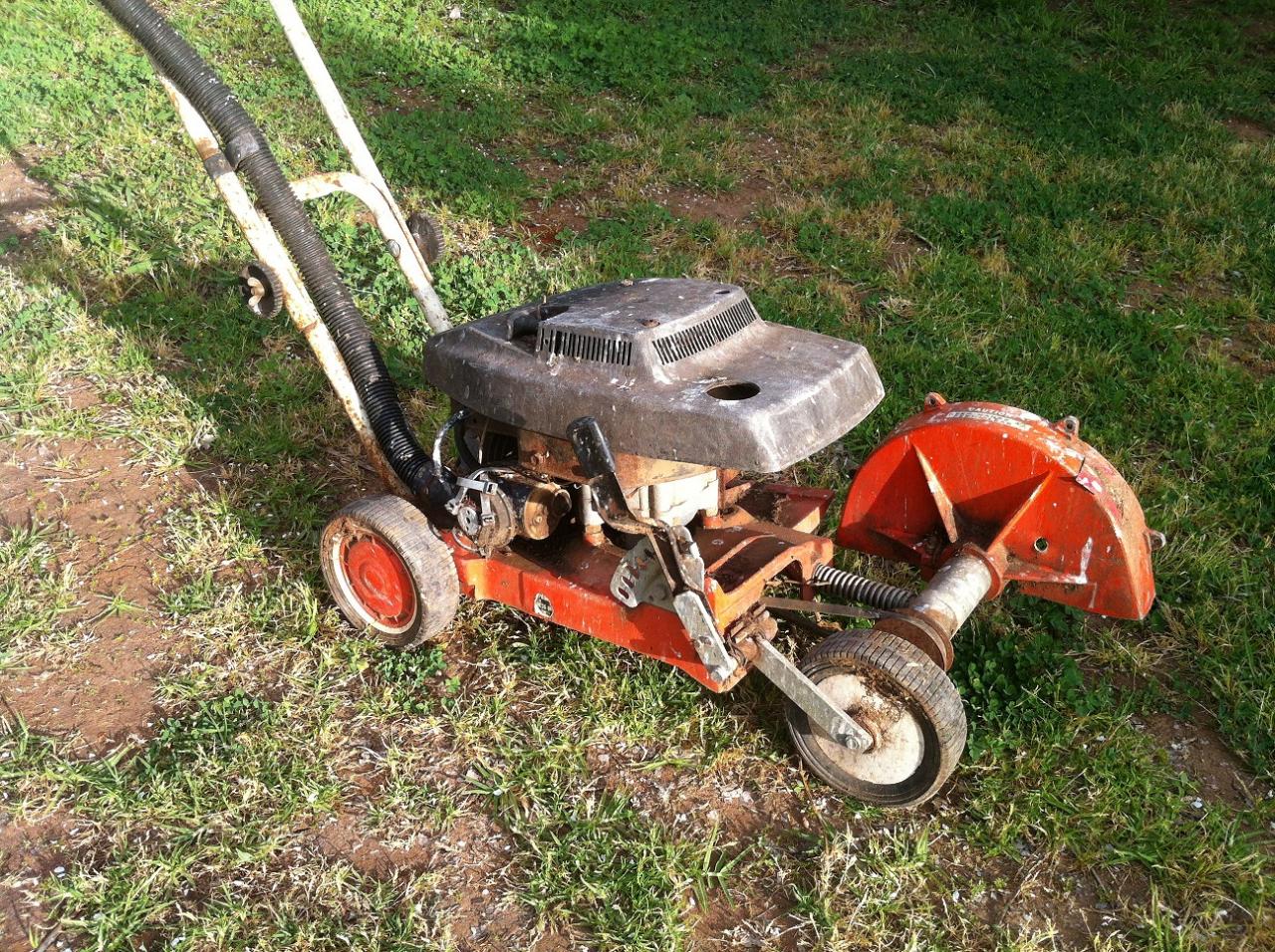

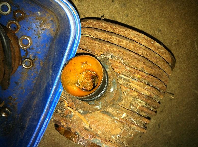

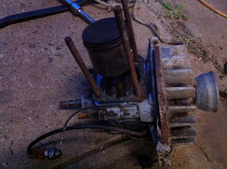

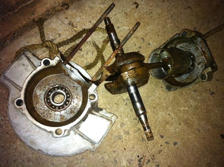

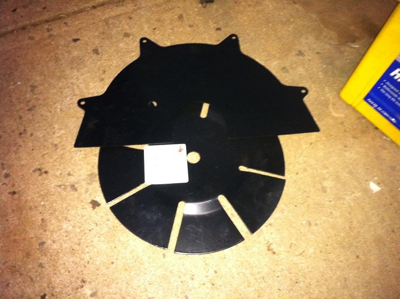

So a few weeks back I bought this from the tip for $10 ![[Linked Image]](https://www.outdoorking-forum.com.au/forum/uploads/usergals/2013/10/full-2055-12855-img_1857.jpg) So first things first, it was missing the blade cover and blade, the new cover was actually cheaper than the blade itself, also straight away got the circular blade.. Cover $14 blade $24 ![[Linked Image]](https://www.outdoorking-forum.com.au/forum/uploads/usergals/2013/10/full-2055-12856-img_1998.jpg) So I removed the engine from the frame and pulled the engine down to see why it was stuck. Not a fairytale ending for this motor, it will be replaced with another series 70 motor from a lawnmower usingthe tilt a cut flywheel. Also broke my damn flywheel puller, just what I needed. ![[Linked Image]](https://www.outdoorking-forum.com.au/forum/uploads/usergals/2013/10/full-2055-12857-img_1994.jpg) ![[Linked Image]](https://www.outdoorking-forum.com.au/forum/uploads/usergals/2013/10/full-2055-12858-img_1995.jpg) ![[Linked Image]](https://www.outdoorking-forum.com.au/forum/uploads/usergals/2013/10/full-2055-12859-img_1996.jpg) ![[Linked Image]](https://www.outdoorking-forum.com.au/forum/uploads/usergals/2013/10/full-2055-12860-img_1997.jpg) ![[Linked Image]](https://www.outdoorking-forum.com.au/forum/uploads/usergals/2013/10/full-2055-12861-img_1999.jpg) One thing thats worth noting is there is no engine number, must be a tilt a cut only thign as I have always seen them on other engines. All 3 main bearings were seized, little end was seized and the big end was pretty stiff, although seeming so much water got into things the magneto still works great after testing. More to follow when I get some more spare time.

I just got the cover from the local shop while talking to them about another matter, he had them on the shelf! apparently the cover is the same for the old ones right through to new. As to your noise, my other one is always noisy, but I know the bearings are very rumbly but still have no play. Im on the hunt for a good motor up the back this arvo, definately will have one, its just a matter of picking through the many dozens of them for a good one

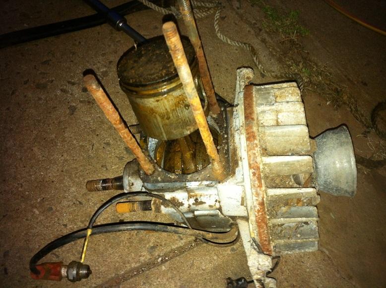

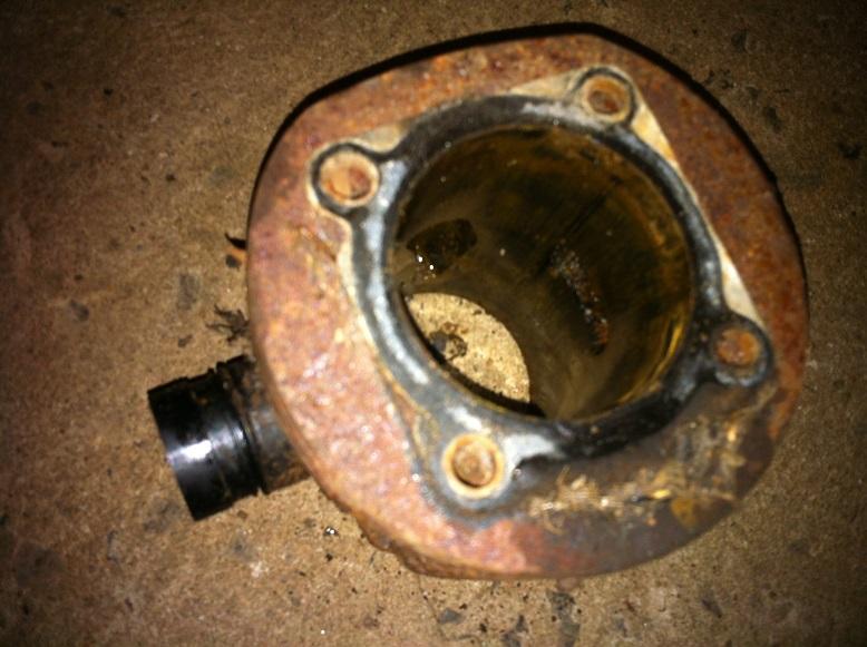

![[Linked Image]](https://www.outdoorking-forum.com.au/forum/uploads/usergals/2013/10/full-2055-12862-img_1990.jpg) ![[Linked Image]](https://www.outdoorking-forum.com.au/forum/uploads/usergals/2013/10/full-2055-12863-img_1989.jpg) New motor, under all the greenwaste all over it its very good, happy with this one, turns smooth, good compression, piston looks like new through the ports. Not sure ill get to tear it down tonight, might leave it until tomorrow, flywheel came off easily, boss came off easily, its ready to strip!

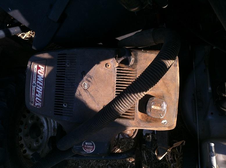

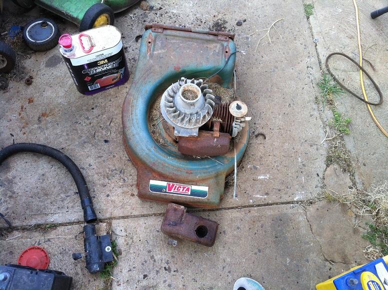

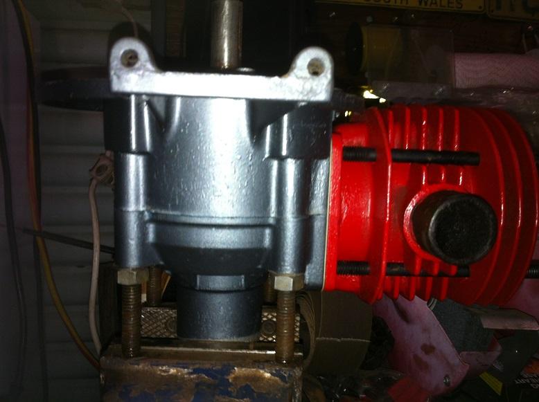

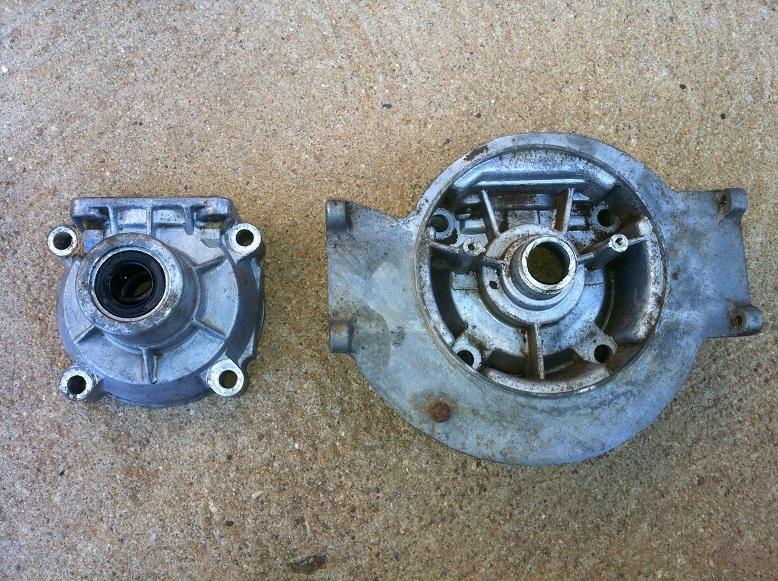

inside the new engines crankcase was very good, its recently been rebuilt by the looks of it 60thou oversize, fresh crosshatching in the bore, as new rings, great bearings.... ![[Linked Image]](https://www.outdoorking-forum.com.au/forum/uploads/usergals/2013/10/full-2055-12890-img_1992.jpg) ![[Linked Image]](https://www.outdoorking-forum.com.au/forum/uploads/usergals/2013/10/full-2055-12891-img_1993.jpg) this is the crankcase with a quick rinse with diesel. Anyhow, I found this attached to a self propelled victa at the tip yesterday.... ![[Linked Image]](https://www.outdoorking-forum.com.au/forum/uploads/usergals/2013/10/full-2055-12892-img_1995.jpg) So the idea is is set in cement, the head and exhaust is coming off the (virtually new condition power plus motor (it looks new without even a wash under the covers, still has all paint on the exhaust) and place them on the new tiltacut motor with the 60thou oversize... A hotted up motor should show some sign..... ![[Linked Image]](https://www.outdoorking-forum.com.au/forum/uploads/usergals/2013/10/full-2055-12893-img_1994.jpg) Enjoy

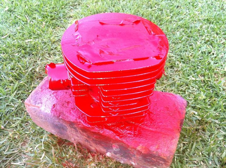

Funnily enough I dont have any edges, I poisioned the lot so I didnt have to get my other one out! that engine red is so bright its near impossible to get a good pic of it. BIggest outlay for the engine will be seals and gaskets... I may have to replace the crank again, it has a little rust right on where the seal runs, I will pay closer attention on assembly, if the rust runs where the lip of the seal does, the crank will take a leap into the back of the ute with my other scrap...
Engine seals fitted today, and sealed up the crankcase, I have to clean the exhaust port before refitting the cylinder properly as its just sitting together...
Stuffed up buying paint, thught I bought silver heatproof paint for the crankcase and had bought "cast iron", oh well it looks pretty good in that colour.

How good does the red look  Nice work Joe!

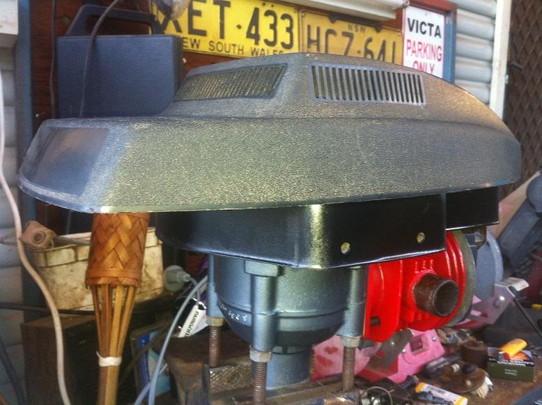

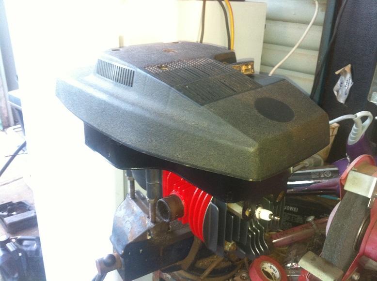

Been a bit slack on this one of late with other bigger projects moving forward, I hope to fit up the ignition and flywheel tomorrow time permitting. That being said, costs on this one have stayed within budget so far....
