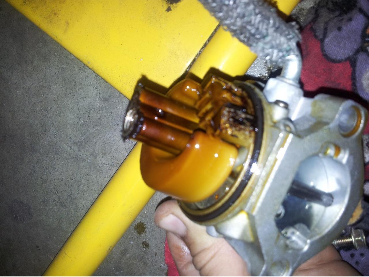

The story with these 3 pictures is a funny one. The carby is off a Briggs and Stratton generator. (Vanguard I believe). Anyway, he said it had been sitting for 15 years with fuel in the carby. He wasn't wrong. As soon as I opened the fuel cap, the whole workshop was filled with the dreaded stale fuel smell. Needle valve was welded onto the carby, had to be drilled out, all fuel line neeeded replacing, fuel tap needed drilling out, swapped with a second hand carby and now runs like new.
I remember comming home from work that day and still smelling stale fuel on my hands, even after washing my hands several times. Just another day in the business of small engines.

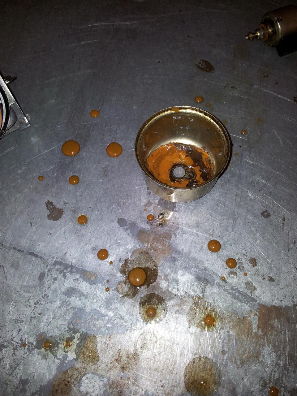

Rust in fuel drum = bypasses fuel filter = orange coloured fuel in carby.

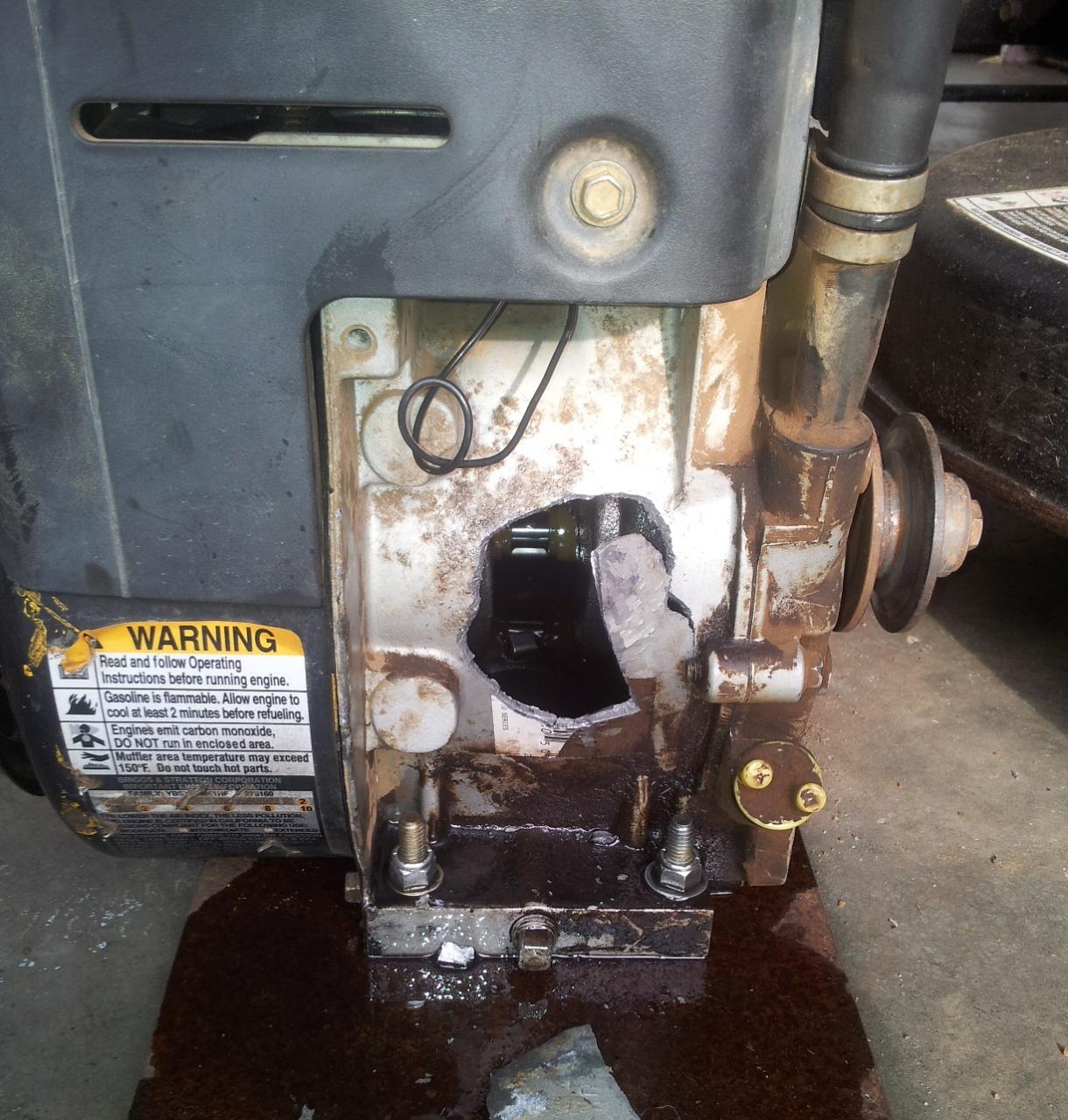

This is what happens when you run an engine wihout oil. At least the customer admitted it.
Topping the oil back up, was not enough to save this engine.

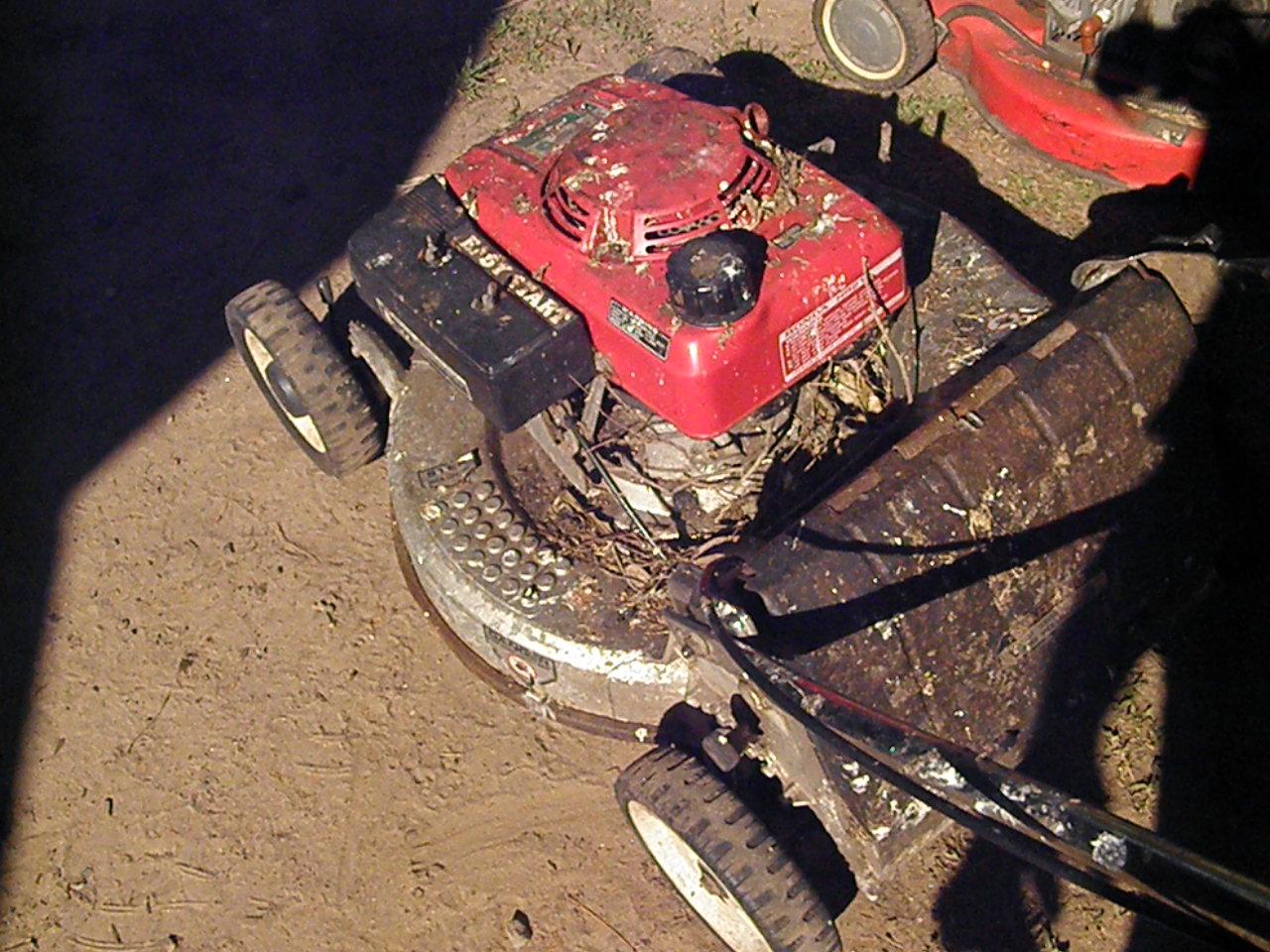

Stored in a Chook House??
Poor Old Honda frown[Linked Image]
Picked this up Yesterday....looks like its been used as a chicken roost??
Life is Hard at the top
I doubt the guano has done much harm - less than would have been done if it had been stored out of doors - but it looks as if its best years were behind it before it was turned over to the chooks. For the base to be plated up like that, on a 4 height lever Honda, it has really done some work or picked up a rather big rock. Should be good for spare parts, though. Pity it only has one hubcap - those things are rare and expensive for that model. Mine runs around hubcapless, like a 1950s hoon's car.

Posts: 119
rockon
hahaha good one , you need hubcaps ? or just a can of red paint !! i think i have some here from a few wrecked honda's . if you want them let me know i'll send 'em too you lol
