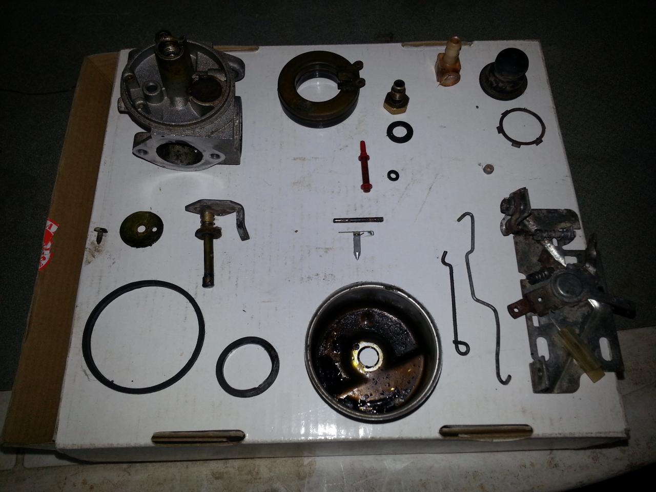

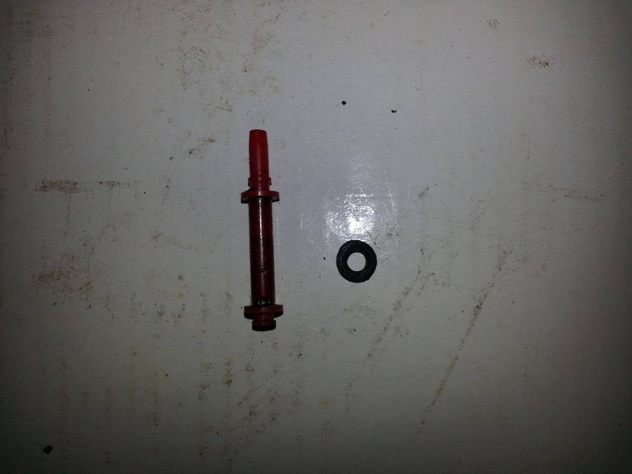

this time I've got Tecumseh tvs90 on victa alloy deck, the mower engine itself is in great nick but upon dismantling the carbie, oh what a gummed up nightmare, but even this is no big deal it will clean up nicely the problem/question here is the o-rings up the main nozzle/emulsion tube, i know they critical for proper operation,they appear to be flat sort of an o-ring i was wondering if a more common readily available round variety could be substituted as they are like chooks teeth to find in AU, plenty in the states around 2 bucks a pop but their postage rates are an outright disgrace.
also are top & bottom o-rings the same.

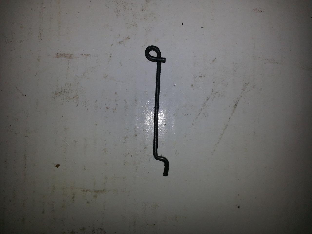

The other item i'm trying to track down is the governor spring, again might as well start for rocking horse dropping.
There seem to be a lot of very switched on people on this forum so thanks in advance for any input [Linked Image]
dismantled carbie
top o-ring fell to bits
spring missing here
spring i need to find

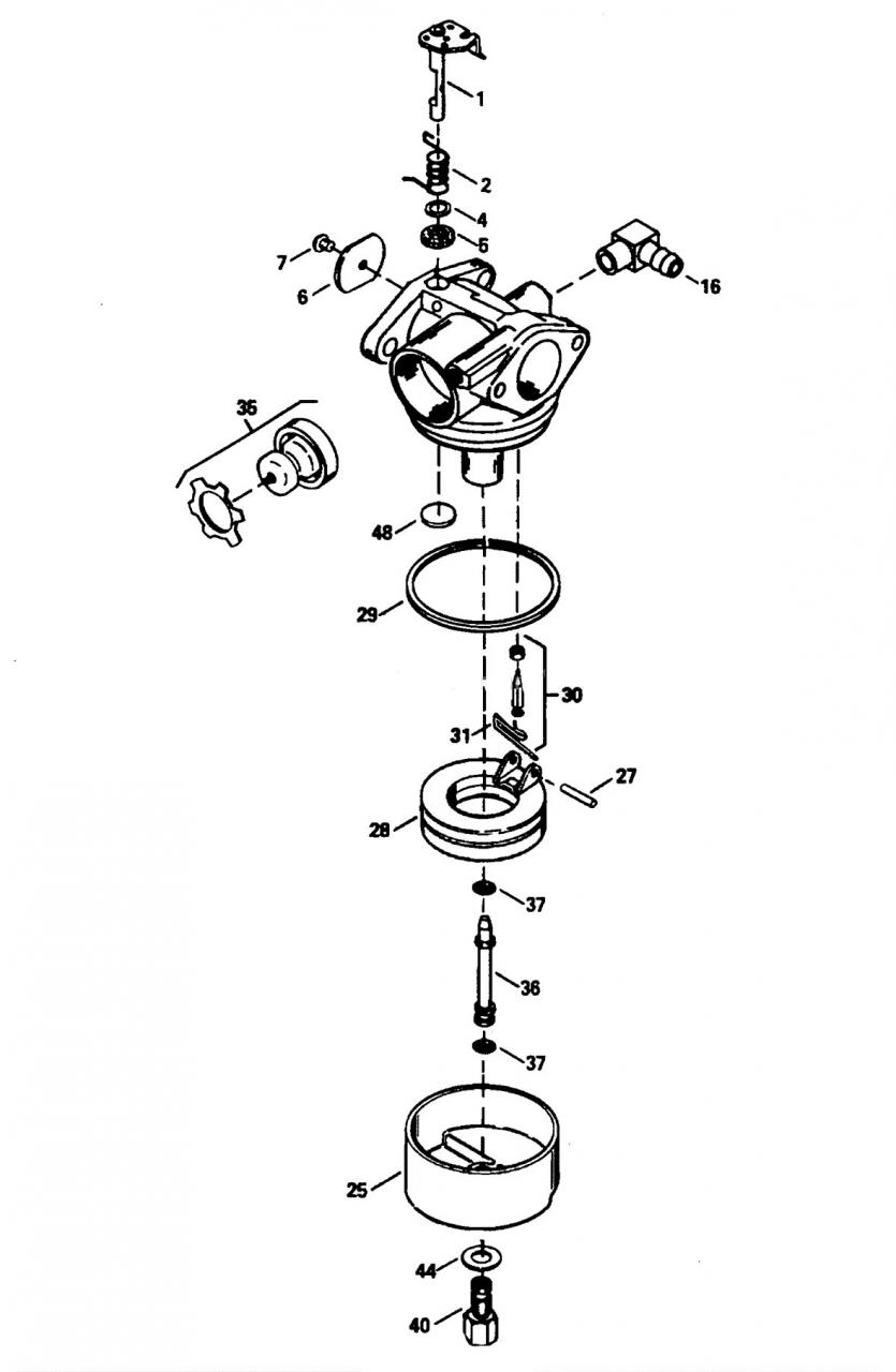

Below is a parts diagram of the carby which is part # 632733 and if you contact the online store either by chat or email (quoting the part # and numbers from the diagram) they should be able to help with the parts that you need.

brilliant thanks for that Bruce.
