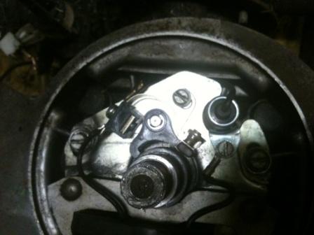

Flywheel came off easily, no puller needed. Bit lost what to do next. The points were fairly clean and the condenser looks new. I was expecting there to be dirt and rust but not the case. Gave the points a slight sand with very fine sandpaper. Anything else I should do before putting the flywheel back? Perhaps I should start a new thread on this as it's moved away from the original focus? [Linked Image]
Joined: May 2012
Posts: 467
hey ! glad it came off easy .
the points look fairly healthy . one check before you put the flywheel back on is adjustment . pull your spark plug out and stick a screw driver on the piston at top dead center, mark the driver shaft then mark 3mm back toward you allow the piston to travel back to the 3mm mark on the screw driver (anti clockwise) 3mm before top dead center the points should just be starting to open , also just rotate the engine until points are open and check the gap it should be .020" (thou).
should have spark after the points clean

Thanks Tomo! It worked exactly as you described, getting a spark. Now for the compression.

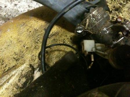

3) The photo above shows how that instead of the conventional spark plug boot there is something resembling an electronic spade terminal, can I stick a screw into the high tension lead (what size?) and get a spark plug boot for it?

the spade terminal looks ok they originally came out with a similar terminal , a victa later model spark plug boot is easy to get heaps listed on ebay and then just a screw about 2cm long and not to fat will screw up the ignition cable, then push boot over top.

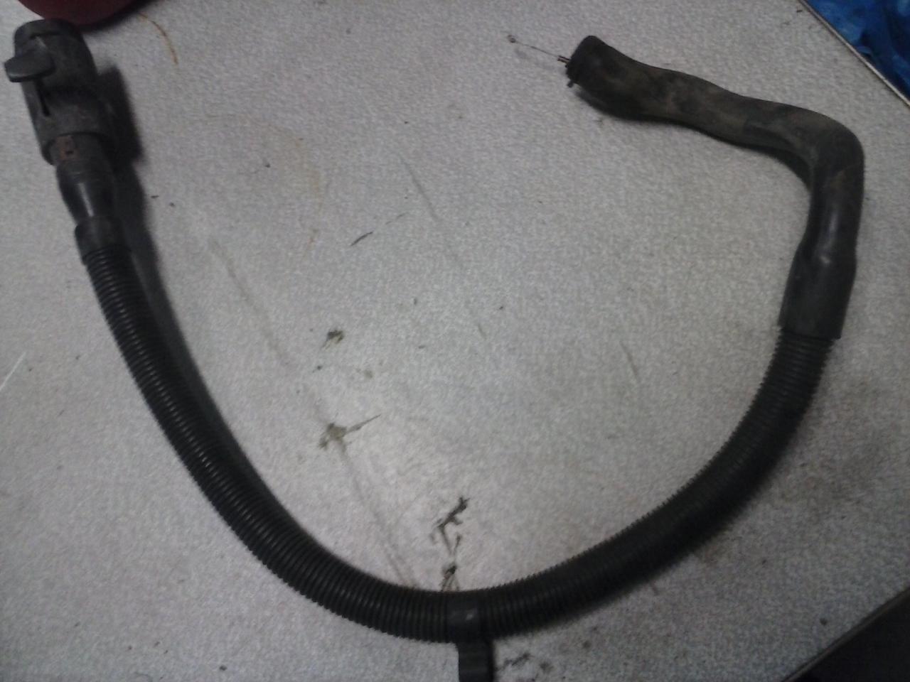

been tinkering with victa 2 strokes for a long time now they were all i ever touched once ! , as far as the snorkel goes the air cleaner pipe is a pretty standard size about 32mm should be able to dummy somthing up.
ill wander out to the shed and take a picture of what ive done in the past.
Joined: May 2012
Posts: 467
ok so this part is off a later victa 2 stroke with whats known as a g4 , its has the throttle cable running inside the snorkel , local mower shop should have one you can use .
remove the rubber end (or trim the rubber and use the bend )
remove the throttle control and cable from the other end .
you can get away with just pushing the pipe on to the carby like pictured and also onto the air cleaner .
make sure you re-use your hose clamp for good measure.

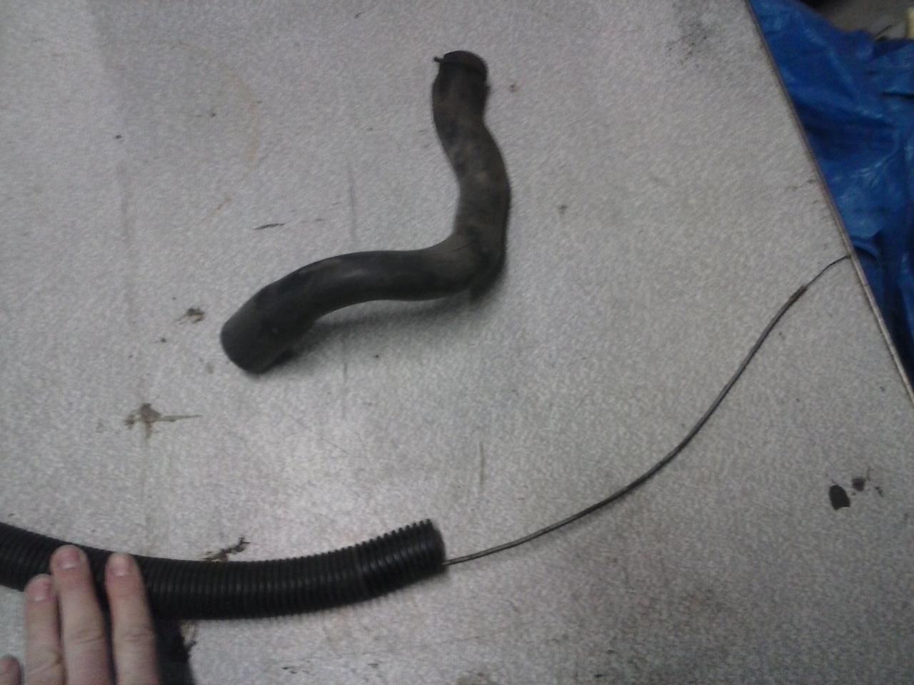

The spare snorkel i have is the corrugated type from the powertorque engines. I didn't manage to get the rubber radiator type hose which was the old snorkel off the mayfair over the corrugated hose, the rubber hose didnt have enough give. Can anything be done to stretch the rubber hose over the corrugated one?
Joined: May 2012
Posts: 467
Hey man . don't think its possible to strech it
over the corriggated one . but the corrigated
one will do the job until you find a rubber one
