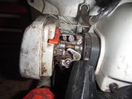

Hi Guys,
I picked up 2 identical echo blowers for $10 thinking that I could at least make one of them go.
I havent done any work on blowers before so I am after a few pointers before I start.
So far after fixing both recoil starters I can confirm they both go but simply die when you press the throtte (suspect lack of fuel).
Both engines have good compression and spark.[Linked Image]
Thanks
PJ

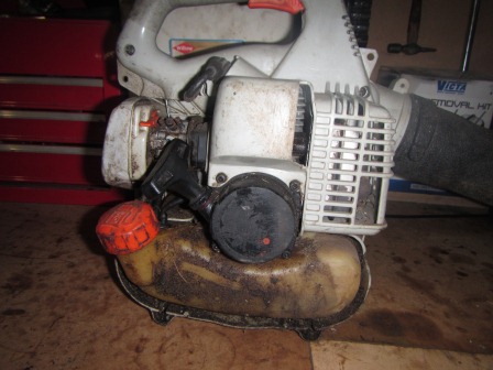

Ok so I have the machine running a little better but it is still not quite right.
The cylinder and rings were pretty spot on ie no scoring.
I cleaned the exhaust and fuel lines/ filter and it does run better but it still bogs down occassionly and when left at idle it will stall after about 30 seconds.
Before replacing the diaphragms could I get some help with the mixture screws?
If you think that wont solve the problem I'm happy to get the diaphragm kit but want to know the correct model. From what I can see it is a zama carb.
Any tips associated with these carb would be appreciated.
I am pretty sure this is worth fixing unless others have an alternative view. Echo seem to build a decent product
Thanks guys
Pj

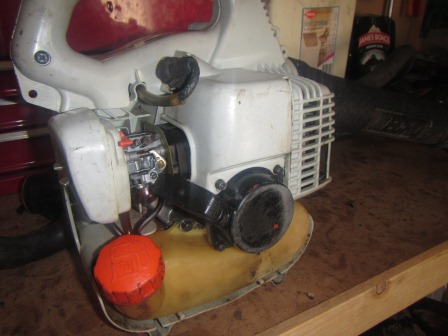

Well Blower number one is now running just about perfect. Starts easily good idle and full speed without bogging down.
Bruce thanks for your advice on the fuel filter. That was the problem. I also used a bit of carb cleaner and now she's running perfectly.
I am fairly sure I have the mixture screws adjusted right, however Id appreciate an explanation if the more wiser members wish to share.
For $20 all up its a bloody good blower.
Fuel mix is 25/1 right?
Phot of the finished product all clean.
Thanks
