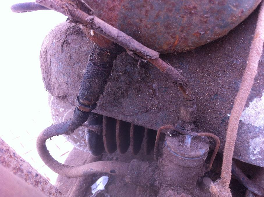

So here are my Autos.
The next one.
the next one.
the last photo shows a small slit in the front axel housing, but after looking at my other axel housings this one seems to have been done by a hacksaw, it does not go in as far as others or be as neat, it is crooked and at an angle.
last one.

This last one seems to have had the later model engine as by the No and the wrong engine coweling and tank rubber under the strap as well as later fuel tap etc.
