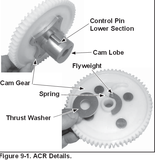

The other aspect I am a bit wary of is that the engine uses two camshafts inside the crankcase, operating the OHV rockers through pushrods, rather like some of the 1950s British motorcycles. In Kohler's case however this has enabled them to use a metal cam, riveted onto a plastic cam gear, pinned to a separate steel camshaft. This picture from the Kohler workshop manual also shows the automatic compression release mechanism:

I would be interested to hear how your Kohler stands up to commercial service in the long term.
