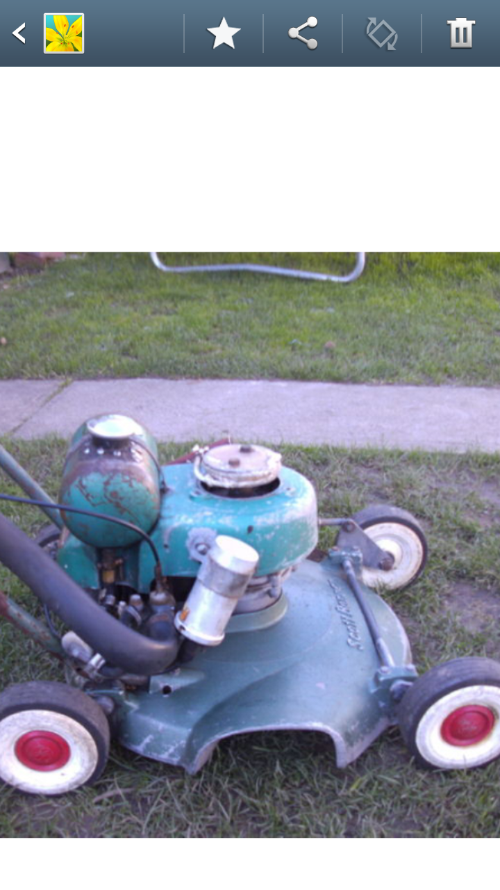

Iam thinking of fixing up my sb 35 rotory. An a mate of mine has this one iam thinking of buying for the parts. But iam no expert on these models so my question is are these parts original or has it been rigged up? Cause mine is missing the magister
So curous to know if those parts are ment to be there lol

was that on ebay? looks like an early holden coil hooked up to it, are they 18 wheels? base looks in good shape, sorry dont know anything about these but the coil is a definate add on I would say lol.

Yea I think ur on the money. They normally have a magister but this one rigged up with a coil. Yea it was on ebay but he was dreaming with the price lol

Nice Coil assy and fuel filter,guess when his holden died he transfered it all over to the mower...Lols.
This 35 Is missing its Magi,starter(sure start" Impulse) and has the wrong cap.( looks like another neck has been welded on to the tank?). Thats just from what I can see. The wheels and caps are correct SB35.
The ebay one was very highly priced and inncorrect also. They are a good resto Nathan,but without the Magi,maybe put it on the back burner? as they are near impossible to get. smile

Yea the fuel tank is buggered lol. Yea it was over priced. I know the guy an its a bit lower in price now. But yea its also missing the same parts my 35 is.
Yes it is missing a lot. I hope it's a lot less than what it was on eBay. You could run it without a magister but you would need the bigger coil.
