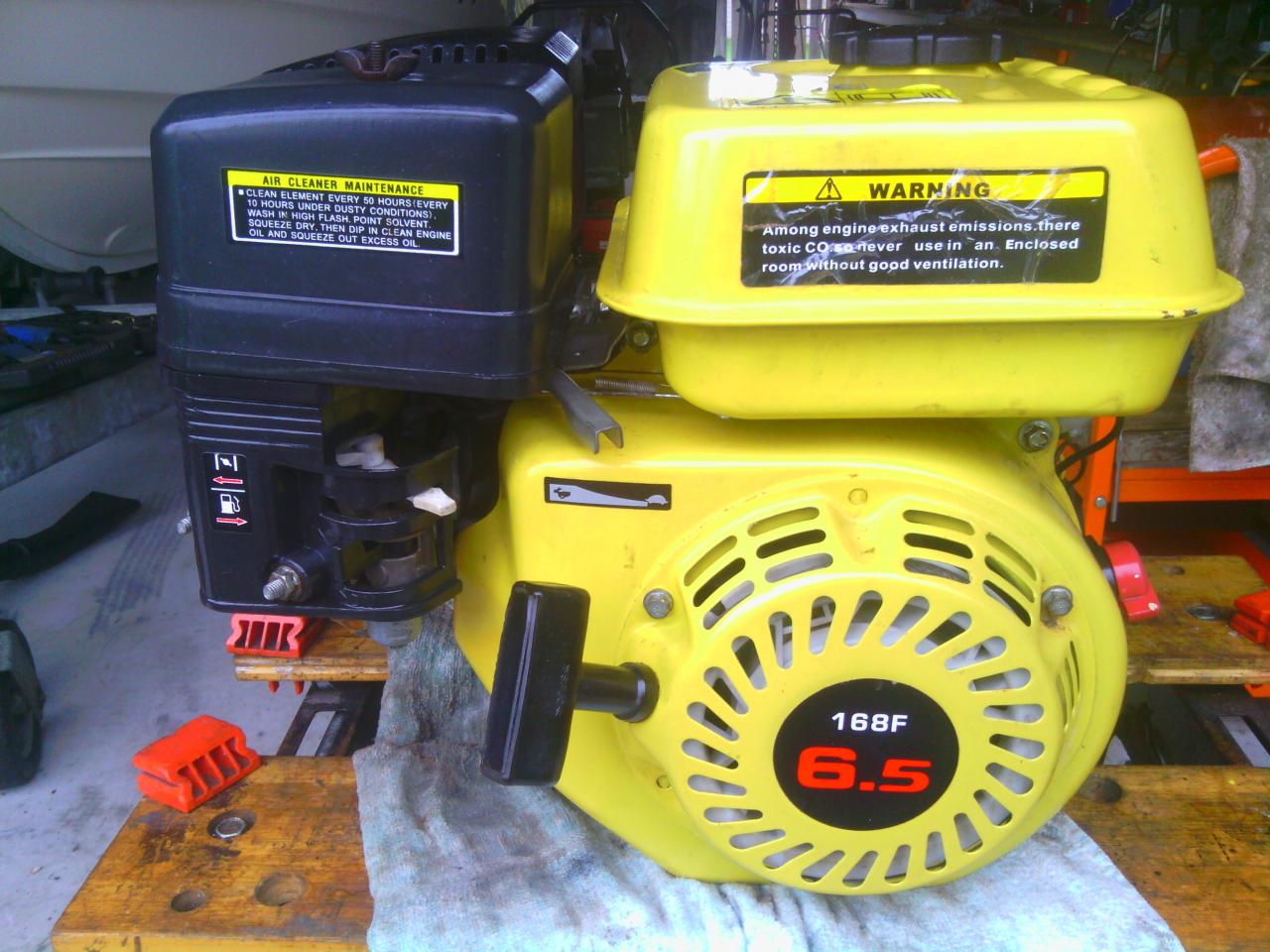

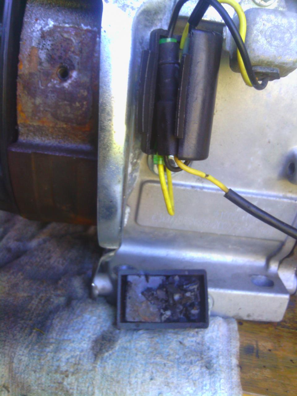

Gday from hervey bay, I have a this motor which has had a good clean . [Linked Image]

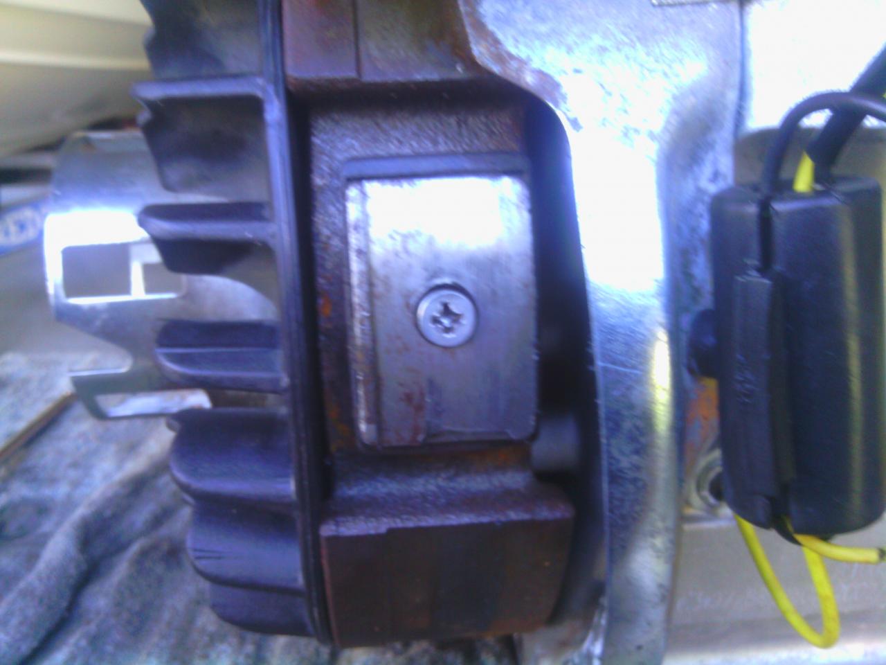

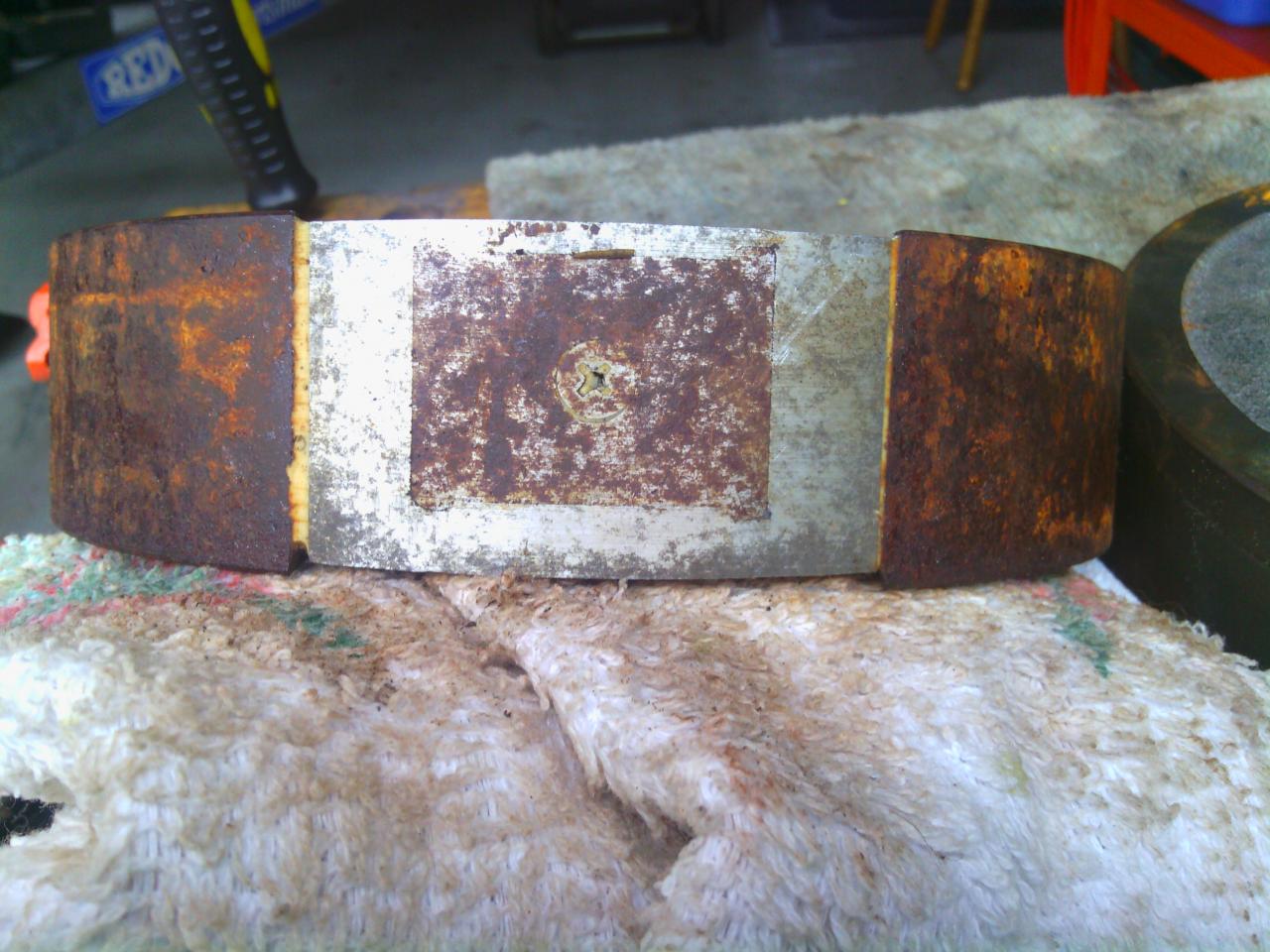

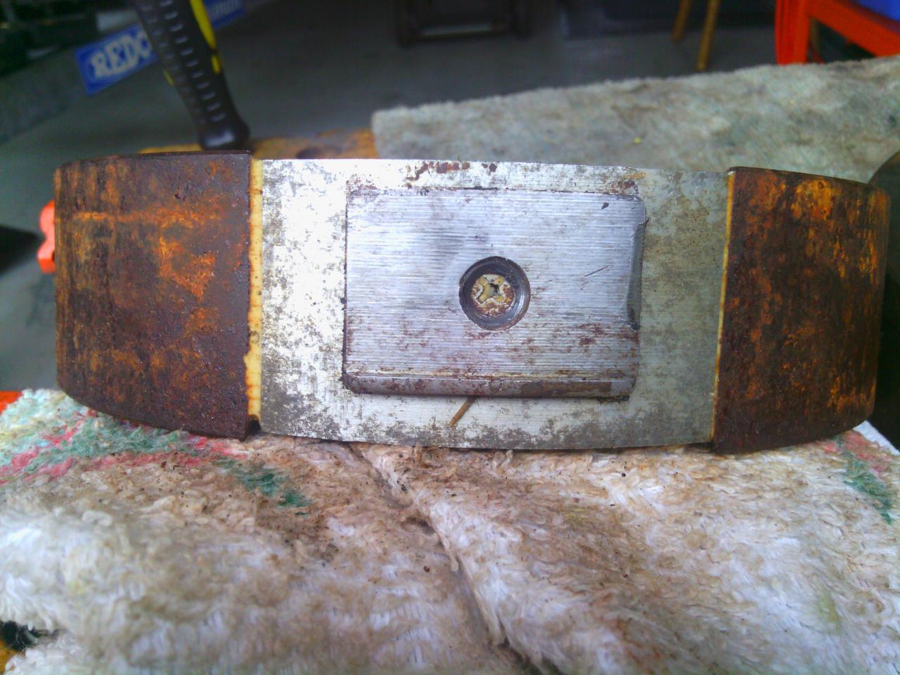

The numbers on the motor are g200f. 1005031168. e13*97/68sn3g2/88*0155*01 I had this motor running beautiful and then a small clicking noise come in to it . I then shut the engine off pulled the cowl off checked the coil. The coil was still tight ,I clanced over at the flywheel and pushed the plate where the screw is in the photo and noticed it was a bit loose so I undid the srew and the magnet underneath the plate was shattered. Please tell me I can buy this part sitting at the bottom of the motor in the last photo. Regards roebuck.

The 168F is one of the clones of the Honda GX160. Honda claims 5.5 hp (gross) for the original, and the 168F's manufacturer describes it as 5.5 hp but puts a 6.5 hp sticker on it. Remarkable marketing practice. You can get some details of it here:
http://www.alibaba.com/product-gs/999192129/168f_1_6_5hp_honda_type.html
You may be able to get a magnet from one of the importers of the engine. Otherwise a Honda GX160 magnet will probably fit.

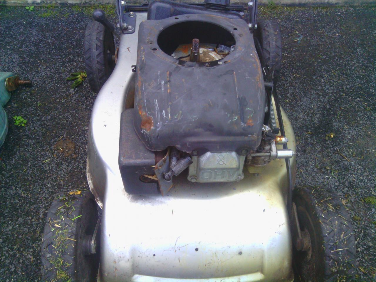

Well grumpy ,though I had got one but it turns out the shaft size dosent match . This is the mower I got . [Linked Image]
They match up in circumference the original a little taller but not a match sure what brand of engine is on this . 1P64F5Y25585. Never mind I will come across one I hope. banghead

That is interesting roebuck. Can you just change over the crankshafts as well?

I wouldn't like to do this because it isn't mine but I'm going to ask what might be a silly question . The new Flywheel shaft size on the bottom is the same as the original but the top shaft size is slightly smaller so it wouldn't be practicle to drill a bit out of the top about a mm? So that it could drop a little.

I haven't understood the question yet roebuck. Is the taper the same? (Will the new flywheel sit on the taper and lock onto it when you press it down, with a large contact area?) Is the problem that the new flywheel has a smaller bored taper of the same angle, so it sits higher on the shaft?
It is essential that the taper has the same angle as the original, so if you put blue on the shaft, then carefully sat the flywheel on it then pulled it off without moving it, you would have close to 100% blue transfer to the inside of the flywheel's tapered bore.
roebuck #47443 18/07/13 06:05 AM
Joined: Apr 2013
Posts: 336

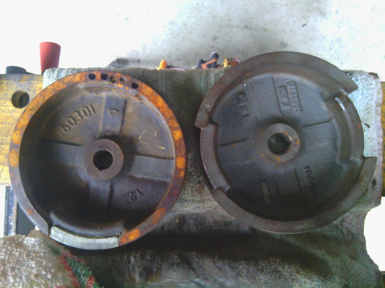

Fits on nice but just won't go dowm far enough. It has the same taper so no point in drilling . They are not the same diameter across the bottom.where as before I said they where my error.
roebuck #47444 18/07/13 07:48 AM
I'm slightly surprised they have made the diameter different - I don't see what the point was. However the outcome is that the flywheel won't fit on the crankshaft you have. Did you take a look at the magnet in the new flywheel, to see if it is the same except for not being broken?
roebuck #47445 18/07/13 08:16 AM
Joined: Apr 2013
Posts: 336

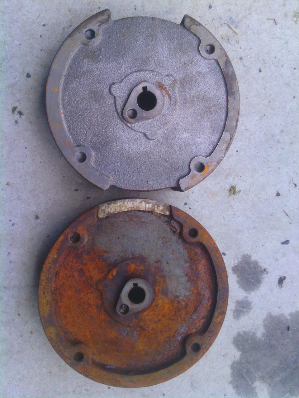

Grumpy the magnet appears to be exactly the same size. 3 pics the first one of the flywheel with the original magnet plate just sat over the other . The second pic the Flywheel with good magnet in it . The third with both flywheels underneath side faceing up. Idont know how to go about getting the good magnet off as it looks really well glued. [Linked Image]
