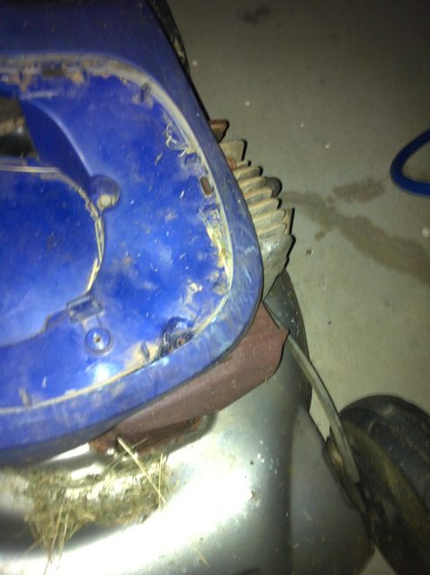

A couple of months ago I inadvertantly ran my 8 year old Victa Tornado with fouled fuel in it for about an hour, which pretty much killed it. A friend of mine offered to take a look at it, and he replaced the fuel filter, air filter, carby, and spark plugs. Got it back a couple of weeks ago and it started up straight away and seemed to run fine.
However, I shut it off after running for about 1/2 an hour to get a drink, and I came back downstairs, and the motor was smoking and it had melted some of the plastic at the top. There did not appear to be any debris around it or anything that was on fire. I left it an hour and tried starting it again, and it wouldn't start, and the pull was very hard, and I could see the flywheel was kind of seizing a little as I pulled it. Since then I've given the starter a pull, and it seems to pull okay, but I am reluctant to run it until I can work out this over heating issue. I'd ask my friend but he's gone on holiday, and I'd like to get it sorted as my lawns only had a line trimmer going over it for the past 2 months now and is looking a little sorry.

Hi Robchap, a photo of the melted area and surrounds will go a long way in helping to identify your problem. If you could post one that would be great.

Its part of the blue plastic on top that is over the starter assembly. Pic shown, unfortunately iPhone pic taken in my shed at night - won't be able to take a pic in the day til this weekend

Hi robchap. From your picture I can see your mower is a Victa 2 stroke, a powertorque engine. I would say there is a good chance that mower has been run on straight unleaded and not 25:1 premix. If this is indeed the case, you may have caused some serious damage to the engine.
Posts: 962
Yes Robchap, i have to agree with with rusty.ute, it sounds like you've fried the piston and rings at the very least. The excess heat from the exhaust has melted the plastic caused by the the engine running alot hotter than it was intended as a result of the lack of lubrication. I had one with the same symptoms a couple of months ago. once it cooled down, it would run again, and after 15 mins of running flat out would heat up, causing the metals to bind and stop dead and cease up til it cooled down again.
Pull the top cover off and remove the 2 clips holding the muffler. Once off take a look inside and you'll most probably find lots of scoring on the piston and the rings ceased onto the piston. You can check this by pressing on the ring with a screwdriver, you'll find that thre'll be no give as they've locked into the piston.

I had an almost identical problem with my mastercut 460 a few weeks ago. While I was using the mower, I could feel the smell of burning plastic. I saw then that the the plastic just above the muffler was completely burned. After removing the mufflet, I could see that It was out of order. There was a hole at the rear leaving the exhaust gases to escape. After replacing the muffler by a new one, the problem was solve.

Detonation is a possibility if run on off fuel,Ive never seen it in a 2T Victa myself.....The over heating does seem odd the mower looks to new to have a hole in the muffler but it may or be leaking..To check for detonation pull the head and look for what looks like bubbles on top of the piston and in the combustion chamber you will have to give them a good clean to see it..Basically it gets that hot in there they strat to melt from pre detonation...but my money is on a hole in the muffler .Cheers
