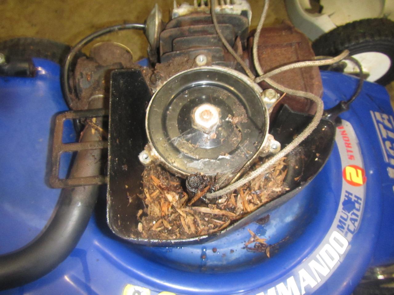

started taking apart a Victa Powertorque I throught was siezed because the blade plate wouldnt turn. It turned out to be a pretty easy fix after a couple of hours work.
Check out how much crap was jammed in the flywheel and plastic cowling. I took engine apart and cleaned it all down. No scoring on the piston or rings so an easy fix. Thought you guys might appreciate it!
It amazes me how people dont look after there gear
