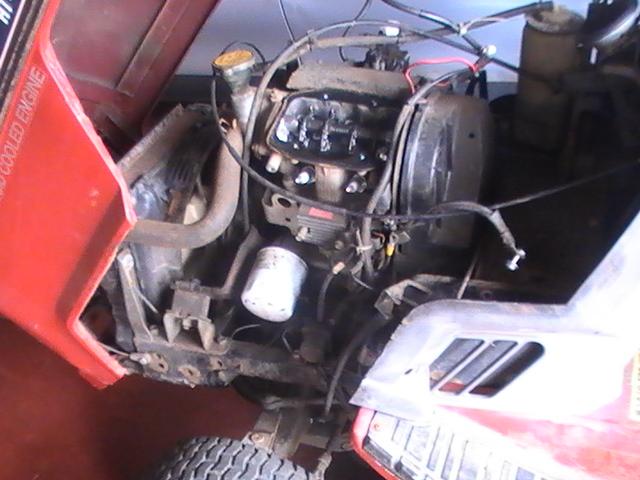

the clutch looks clean and good not at all blackened and the oil smoke seems to come from somewhere below the exhaust manifold and not thru the muffler engine block is thick with grime and the only leak i can find is a small(4"square)housing to the right of the clutch and level with it thanks grumpy [Linked Image]
r4d2 #46468 08/06/13 02:44 AM
Nice picture. Can you post some more, showing the area around the oil leak? The most important points are that the smoke is not coming from either the clutch or the inside of the engine, either of which would have meant a sizable repair job, and at Honda prices for parts, an expensive one.

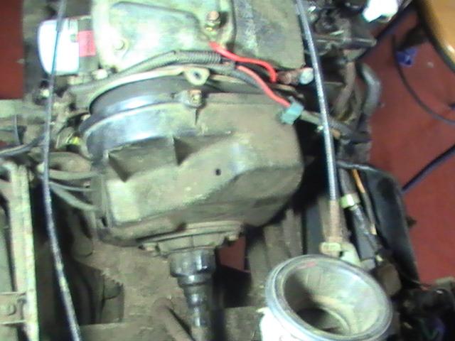

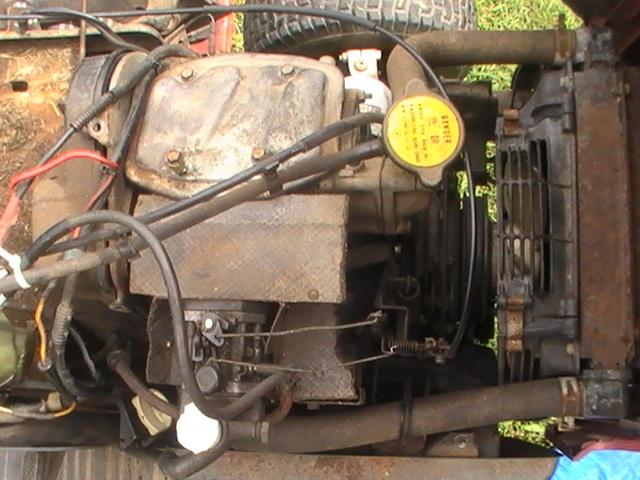

aussieHi Grumpy heres some more fotos of harry360 the oil leak is from a housing above and behind of chassis beam foto isnt great but difficult .. yeh this thing is a bit complex but real good stuff methinks like other hondas ive had 125 trail and 900 bol dor bikes im gonna see if i can download the workshop manual or exploded views of engine tonite thanks for yr help arthur [Linked Image]

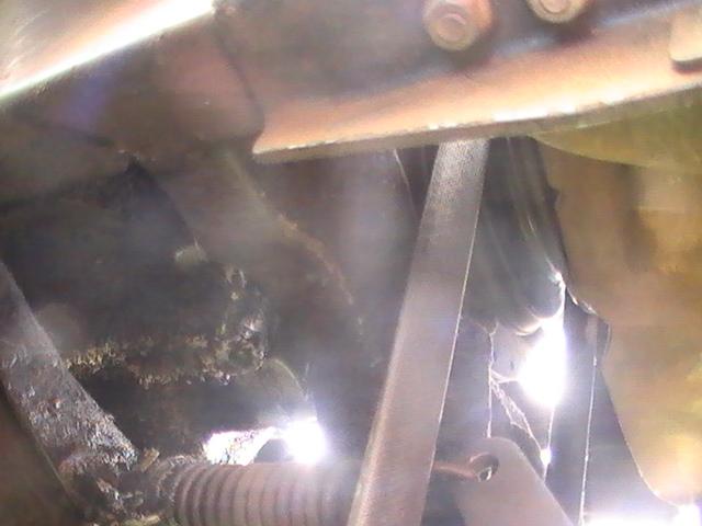

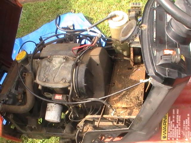

[img]https://www.outdoorking-forum.com.au/forum/uploads/usergals/2013/06/full-6632-11117-pic_0286.jpg[/img heres the foto of chassis beam front of camera and above it and forward of the crossmember is a small ally housing but very difficult to see dunno if it helps much ... dont seem to be able to upload 5 fotos atta time .. operator error i guess cheers arthur

damn forgot to load foto of mag cover n tailshaft ....what do you reckon hey ??? [Linked Image]
r4d2 #46485 08/06/13 11:38 AM

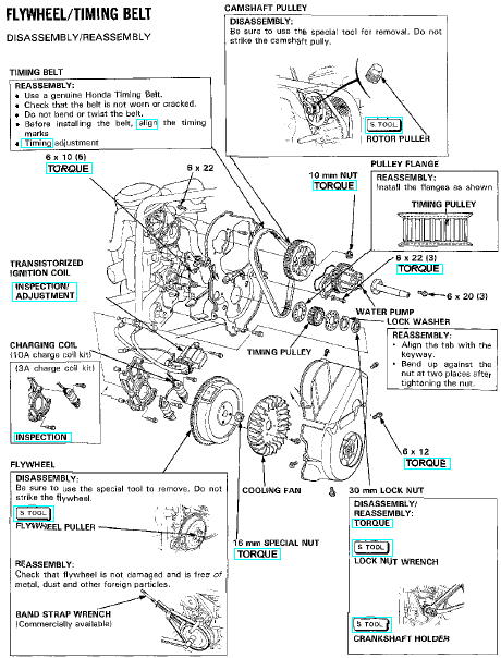

First, if you remove the radiator then unbolt the engine mounts you seem to be able to slide the engine forward on the frame. The flywheel is not attached to the prop shaft, it just slides out of it. Then you can remove the cam belt cover and have a decent look at the magneto, if you really want to do that - I'm not clear on why you want to. The alternator is back there too, but it is separate from the magneto and is a bit more difficult to get at.
Are you saying the oil leak is coming from the area in the yellow circle below?
And is that the bottom of the engine? I think it must be because the cutter drive belt runs vertically downward, and that's the way it seems to be going in the picture. I'm having trouble working out what the pictures mean. It would be best if you could put an arrow or circle in this diagram (using MS Paint is the easiest way) to show us where the leak is:
I think you need to wash down the engine so you can see the underside of it where you seem to be saying the leak is coming from. Bear in mind that the oil pump is right near your leak, and if its gasket is leaking, that might be the source. However I don't see yet how it would get onto the muffler.

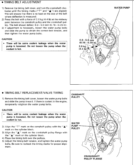

While you are there, be sure and check the tension on the toothed belt. If it is allowed to get slack it will jump teeth, and you'll have to pull it apart again to replace it. You adjust the tension by sliding the water pump outward:
Note that the water pump seems to be held by four bolts, one of which has to be approached from the back of the water pump (that is the one furthest to the right). If the belt is slack it is sure to be worn, and it would be best to replace it rather than go through the whole process again when it wears a bit more and jumps its timing.
