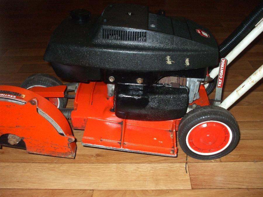

Hi Guys, I was trolling around the recycle yard today and got lucky. I managed to find a Victa Full Crank 2 Stroke Tilta Cut. See below. I have had quite a few people ring and ask if I had any available however I've never been able to find a decent one until today for a good price. $20. The only thing missing was the blade cover/ guard.
I have managed to get it going after giving it a wash. It spills a bit of fuel out the starter bulb which is easy fixed and seems to run alright considering I havent cleaned the carby yet and replaced all the seals.
This is the first edger I have worked on. Always been doing mowers so I would appreciate any tips to get the old girl going at 100%.
I have already ordered one of the round blades.
Thanks guys

That's good advice bigted. Here's the best pic of mine.... [Linked Image]
You can see enough of the cover to get the idea...if you need a better pic, just let us know. wink
Re: the belt....my rule of thumb is...if you think it has stretched....it probably has....I would be tempted to replace it; especially as you are going to use the round edger blade. wink

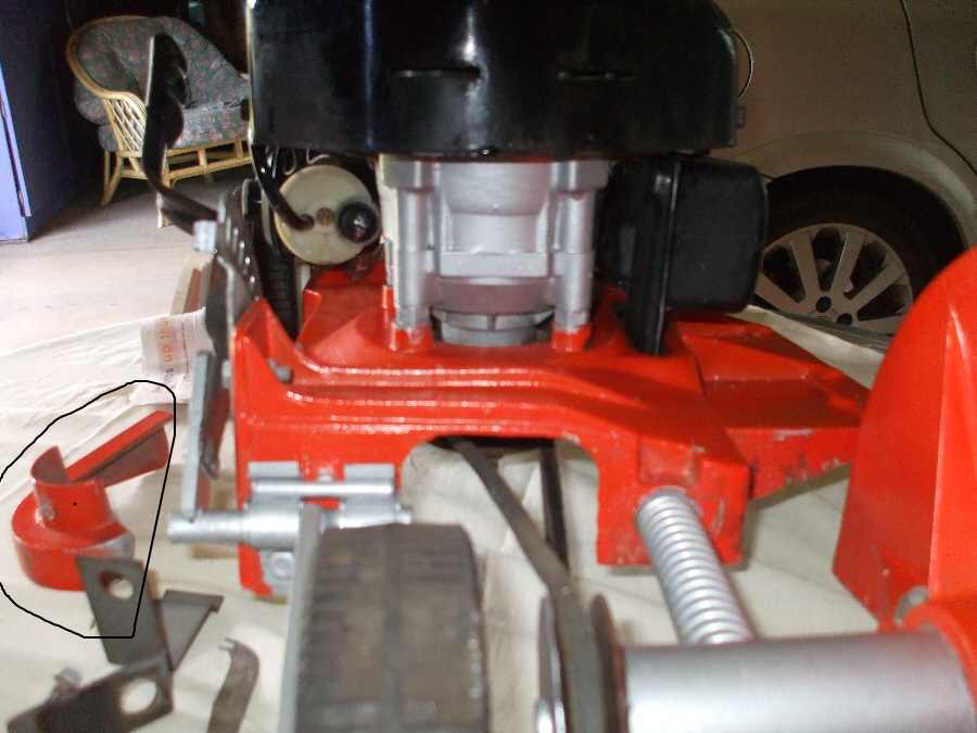

2) How do go about replacing the spindle bearing. It looks as it I will have to take the whole assembley off the frame to break it down.[Linked Image]

I also notice there is no belt guide around the front pulley, try to source one as this will stop the belt from coming off while you're using it. With no load there's not much of a problem but under load they hop and jerk a bit and this is more likely when the belt will come off.
Good luck and keep us posted.
Hi guys, here's a pic of the belt guard (circled)....also Pete, can you please post a pic of your machine from the front as in the following pic of mine....I want to make sure that the front axle support arm is straight. Thanks mate.

Ok made some progress after work. Iv put some photo's below which I hope benefit others and not just myself. I find it easier to learn from posts that have photo�s.
I replaced the outer spindle bearing which didn�t turn out to be that difficult. Once you seperate the cutting shaft from the frame the cutter shaft comes out just like a powertorque crank. The inner spindle bearing was nice and quiet so I left it alone. When I rotate the new blade it is nice and quiet with the new outer bearing. After a couple of swear words I now have the shaft installed back on the frame.
