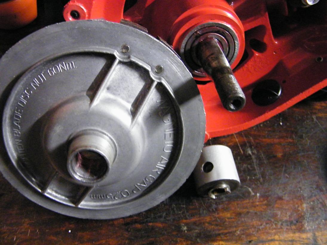

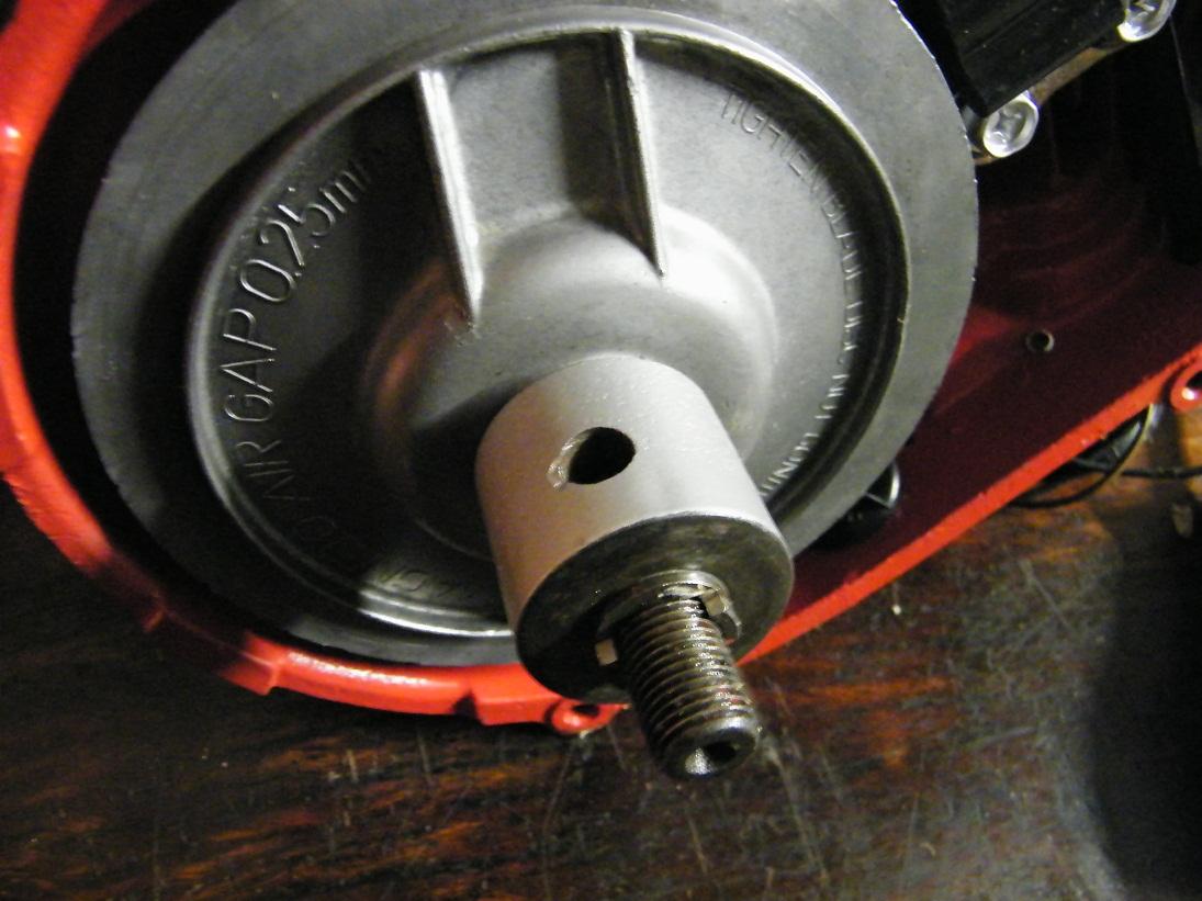

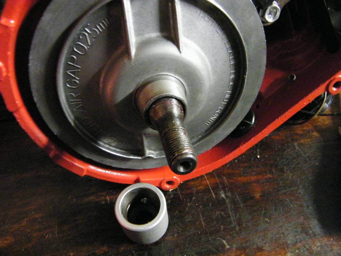

If it's a newer power torque engine all you need is a hammer to give the boss a good whack,same way as you get the boss off a full crank engine...[Linked Image]
r4d2 #45602 01/05/13 05:37 AM
Joined: Mar 2013
Posts: 53
thanks chris thats the one !!! looks pretty clean mate
