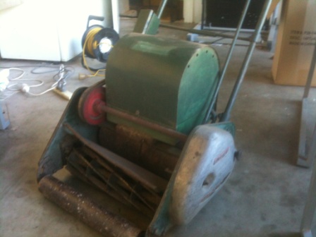

Today I picked up a Scott Bonnar supercut electric mower for less than a carton of beer. I bought it sight unseen and tbh I was a little skeptical. I must say I am pleasntly suprised with it's overall condition. I could see that reel was touching the bottom blade so I only gave it a quick run to make sure it worked before handing over my $30. I got it home and got to work removing the reel and soleplate for sharpening when I came across my first problem.

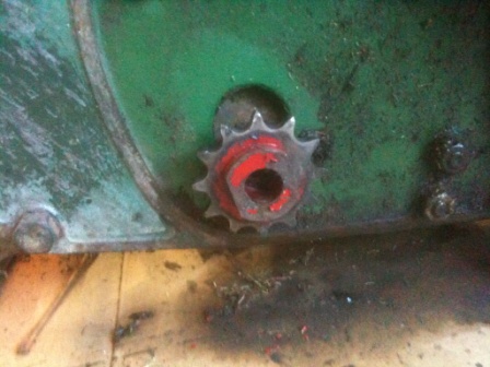

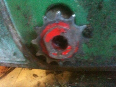

The sprocket for the reel is of some concern as it is different in appearance to some of the other models that I have seen online.
I have included some photos of the sprocket and wondered if it should just come off with a wrench in a reverse thread manner? Any input would be greatly appreciated.

Thanks Joe, for the heads up mate, but as you know, I have a Model 17 Supercut electric myself...and never had to remove the reel....I would hazard a guess that it removes in a clockwise direction (left hand thread) which is the opposite to its direction of travel.
My advice would be to give it a try....gently and see how you go....please let us know how you get on, mate. wink

The sprocket has a flat on it, which looks as if it is intended to suit a spanner. As Deejay said, if it screws off it must be on a left-hand thread or it would unscrew itself in service. Reel sprockets sometimes are designed to unscrew clockwise while a piece of soft wood is threaded through the reel itself to prevent rotation. However the Model 17 was a very classy machine, and I would not be surprised if it had a better way to restrain the reel, such as a hexagon or flats on the reel's axle, or a place to slide a pin through both axle and bearing housing. A picture or two would be useful, showing what is right behind the sprocket, and the reel axle just inside the sprocket-side bearing. If there is nothing there to lock the reel, chances are the block of softwood through the blades is the answer.

Hey grumpy, I managed to get the sprocket off fairly easily with your method. I guess I wanted confirmation from someone in the know before I went ahead and did it. Thanks everyone for your input.
