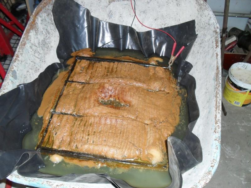

hey jarryd . wasnt kidding about electrolysis. it removes all of it easily. heres a pic of an old rotomo base in my wheelbarrow. the yukky stuff on top is the rust coming off.

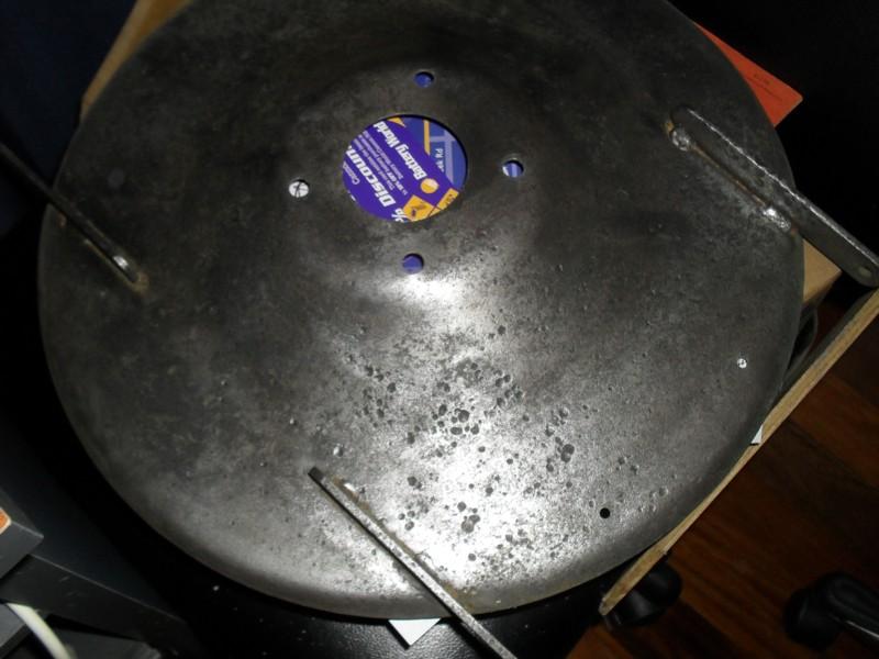

the 2nd pic is finished product with minimal effort.
