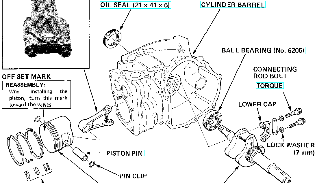

An oil seal is usually described by three dimensions: interior diameter, exterior diameter, and width. Honda says the top crankshaft seal is 21x41x6. That means they think they made the crankshaft to fit a top oil seal with an interior diameter of 21 mm. It would appear that you have been sold 25 mm oil seals up to now, so the diameter of the sealing lip was 4 mm larger than the shaft it runs on. Because that engine has a pressure lubrication system, and one of its purposes is to lubricate the ballrace at the top of the crankshaft, having effectively no oil seal behind that ballrace would inevitably result in rather a lot of oil ending up on your breaker points. Up to now I'd been wondering how you were getting as much oil as you reported - even a sick and sorry oil seal would only ooze a bit, and you were talking about a lot more oil than that. Now it all becomes clear.
Just for interest, here is the assembly diagram for the crankshaft:
As you can see, the oil seal goes in from the top of the crankcase casting, and the ballrace goes in from underneath. The crankshaft must have a step-up in diameter just behind where the oil seal runs on it, because its ballrace is a 6205, which has an internal diameter of 25 mm and an external diameter of 52 mm.
Post edit: As will become clear later in this thread, the Honda workshop manual turns out to be incorrect. The correct seal for this engine is 25x41x6.

To move forward with this top seal problem, I suggest you measure the diameter of the crankshaft, where the oil seal runs on it. If you look at the diagram from the parts list, you can see a parallel section (circled in red) just below the flywheel taper, then a step up to the larger diameter for the inner ring of the ball race:
According to the engine repair manual, the oil seal diameter (circled in red) should be 21 mm, and the ball race diameter right below it, should be 25 mm. If you confirm those diameters, we will know that the workshop manual refers to the engine you have. I can't see how it can be otherwise: your serial number fits for a GV150 K1 (that is, not an early production GV150) but let's just make sure we are all talking about the same engine. So far I have never known a Honda workshop manual to talk nonsense, but we all have new experiences every day.
Here are the production records for the GV150. As you can see, they were all made in Japan:
The reason I want to be very sure about this, is that the Honda spare parts list seems to only show a 25x41x6 oil seal (part number 91201-Z0T-801). This would be the right size to fit on the same diameter part of the crankshaft as the ball race. So, we need to confirm that your crankshaft is like the one in the diagram I've shown in this post, with a step down in diameter from 25 mm where the ball race fits on it, to 21 mm where the oil seal runs on it.
The parts list and the manual could both be correct if there had been a running change in the engine design, making the crankshaft diameter a constant 25 mm, and deleting the step down to 21 mm shown in the workshop manual. Workshop manuals are often not updated when that kind of thing happens. The problem we have is that if your engine is the original 21 mm version, it may be difficult to get an oil seal for it. 21x41x6 is not a standard size for oil seals.
Of course one possibility here is that someone in Honda's Department of Cost Saving Ideas That Only Screw Up the Product a Little Bit, found that the recess in the top of the crankcase casting that the oil seal presses into, was just about deep enough for the oil seal's lip to reach onto the 25 mm diameter part of the crankshaft. They could then substitute the 25x41x6 seal for the original 21x41x6 seal, and warn their dealers to be sure and always press the seals in as deeply as possible, because if they didn't, the points compartment would fill with oil and the engine would stop.

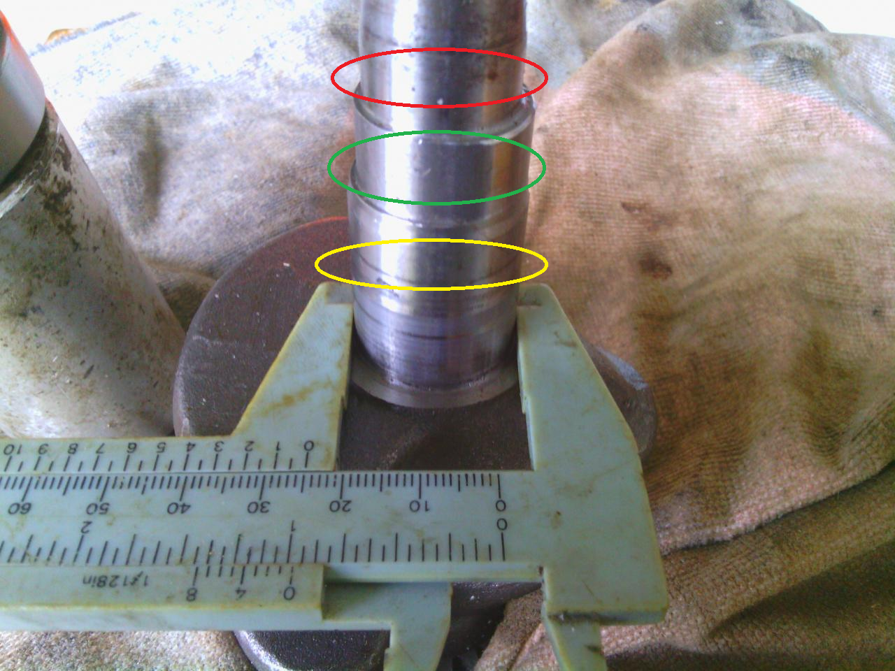

I hope this is what you have asked for. I'm not good on terminology but in the diagram you sent it has a part number 8 a chain and mine does not have this chain if that matters or not. Thanks again .
First, the easy bit. 8 is a timing chain. It runs around a small sprocket on the crankshaft and a large sprocket on the camshaft, so that the camshaft rotates exactly 1 revolution for each 2 revolutions of the crankshaft. This is at the bottom of the crankshaft, close to the large cover that goes across the bottom of the engine. You make a good point, though. Your GV150K1 has timing gears, where the original GV150 had a timing chain. The online parts list is for an early GV150 with a chain.
http://www.ereplacementparts.com/ho...ine-parts-c-37657_37658_38010_38030.html

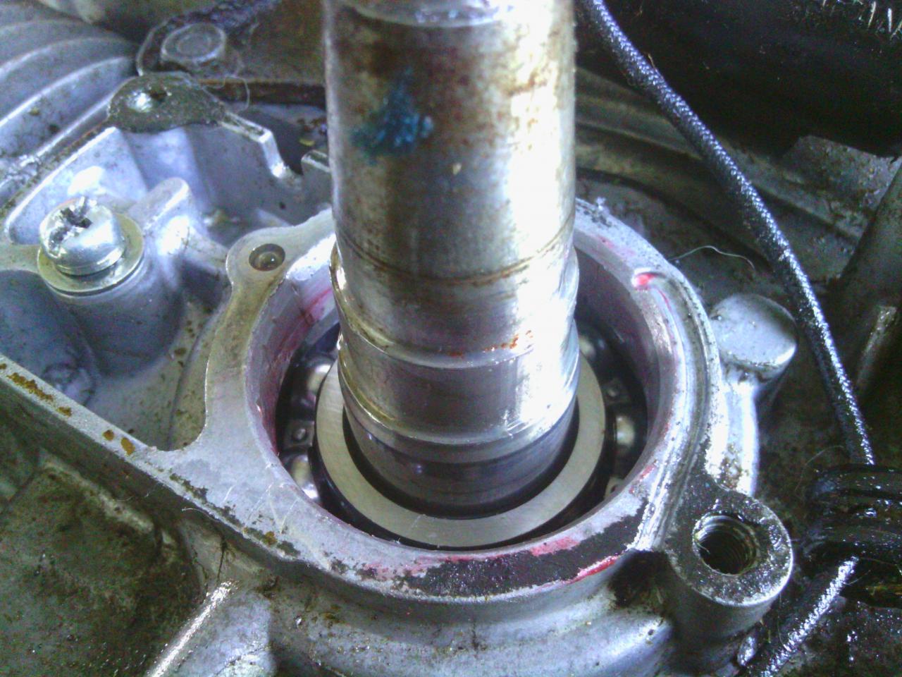

Now, let's talk about the flywheel end of the crankshaft.
1. In your last picture, is the inner ring of the ball race a good fit on the crankshaft?
2. What is the diameter of the surface in the red circle?
3. Is the surface in the green circle eccentric to the rest of the crankshaft? If it is, it is a cam that operates the breaker points. This is a bit concerning, because Honda's manual shows the cam as being the first parallel surface after the flywheel taper - see red oval:
4. There is a narrow shiny surface inside the yellow circle. Is this where the lip of the oil seal has been touching the crankshaft? What is the exact diameter of the shaft right there?

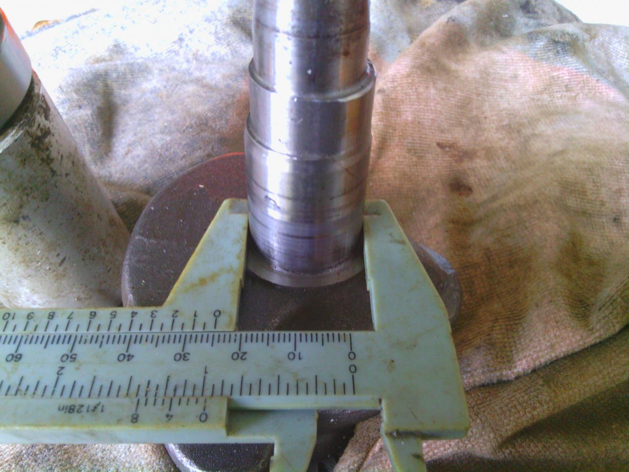

1The inner ring of the bearing fits snug. 2The red line is 16mm shaft. 3The green is the cam that opens and shuts the points.4 yes I'm pretty sure this is where the lip of the seal has been running . Could you show me with a dot where the oil seal lip is supposed to be. [Linked Image]
It appears that the Honda workshop manual is wrong about the correct required size of that seal: it has to be the same size as the shaft, which unfortunately is a bit undersized from 25 mm. Also, I now understand why the counter jockey told you to push it in a long way more than 2 mm below flush: the shaft is tapered, and the further you push it in, the closer the shaft is to the correct size.
The shiny mark, with the yellow oval, appears to be where the seal-lip has been running throughout the engine's life up to now:
Run your fingernail across that shiny mark and look at it closely, to ensure that it is a mark, not a groove. If it is a groove, you need to move the seal 2 mm sideways from that previous position.
Next, I suggest you oil the lip of a good seal then slide it down over the shaft until its lip is right over that shiny mark, and verify that the lip is in firm contact with the shaft, all the way around. Then check that the housing is clean where the outside of the seal will sit in it.
