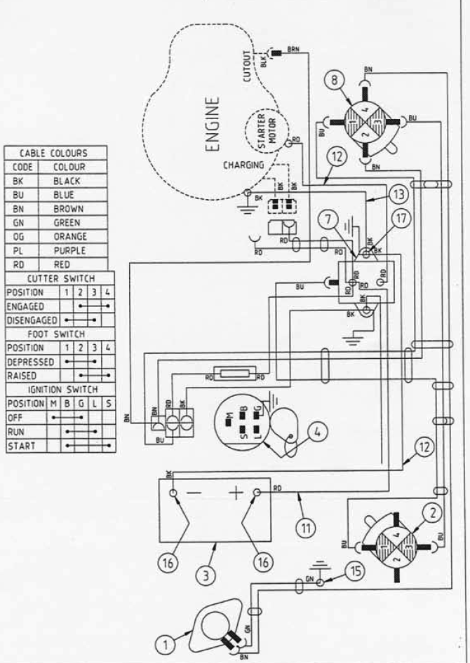

If it has a diode in the wire, I expect that will be a low current alternator. The mower's wiring diagram shows two black wires out of the alternator, going to a plastic connector block. It shows one red wire coming out of the connector on the mower side. The other wire from the engine would carry unrectified alternator output (i.e., A.C current) for the headlight circuit if there is one. I expect that the diode will be in one of the engine-out wires, on the engine side of the connector:
If the wiring diagram were correct, the diode would normally be in the black wire that is connected to the red wire, not the unused (AC) black wire.
Unfortunately, you say that there is only one wire coming out of the alternator, and it is red. This would mean your engine is not the one shown on the diagram. It sounds as if you have the Figure 6 alternator:

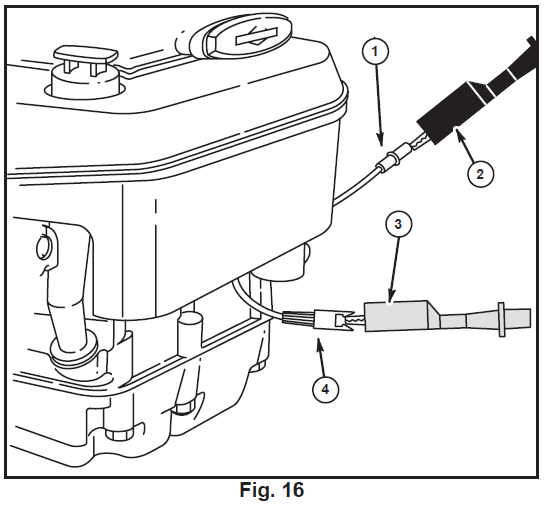

First, the charging system is only rated at 3 Amps at 3,600 rpm. 3 Amps into a not-very-charged car battery isn't going to do a lot in terms of immediate terminal voltage, so I don't think your original test proved that there was a fault. I suggest you perform the Briggs-specified output current test:
System 3, 4 and Dual Circuit Alternators
Alternator Output Test Procedures
Test DC Amp Output
1. Insert RED test lead (3) into 10 A receptacle in
meter.
2. Insert BLACK test lead (2) into COM receptacle in
meter.
3. Rotate selector to (DC amps) position.
4. Attach RED test clip to stator output lead (4),
Fig. 16 (Typical).
See Fig. 17 for Dual Circuit alternator. The RED
wire (5) is DC output. The bump on the connector
indicates the DC output terminal (6)
5. Attach BLACK test clip (2) to the positive (+)
battery terminal or charging harness lead (1).
6. With engine running at specified RPM, output
should be as listed in Table No. 2, Specifications.
7. If low or no output, check stator air gap, when
applicable. See Table No. 2, Specifications.
8. If stator air gap is within specification and there is
low or no output, replace stator.
Extract from Table No. 2 for your system (System 3 & 4):
DC Only Alternator and Dual Circuit Alternator
Output: Between 2 to 4 amps DC @3600 RPM.
Output will vary with battery voltage. At maximum
battery voltage, output should be approximately 2
amps.
If you do not get the specified current, we can talk about what to do next, which will be clean various terminals and set the alternator air gap.
