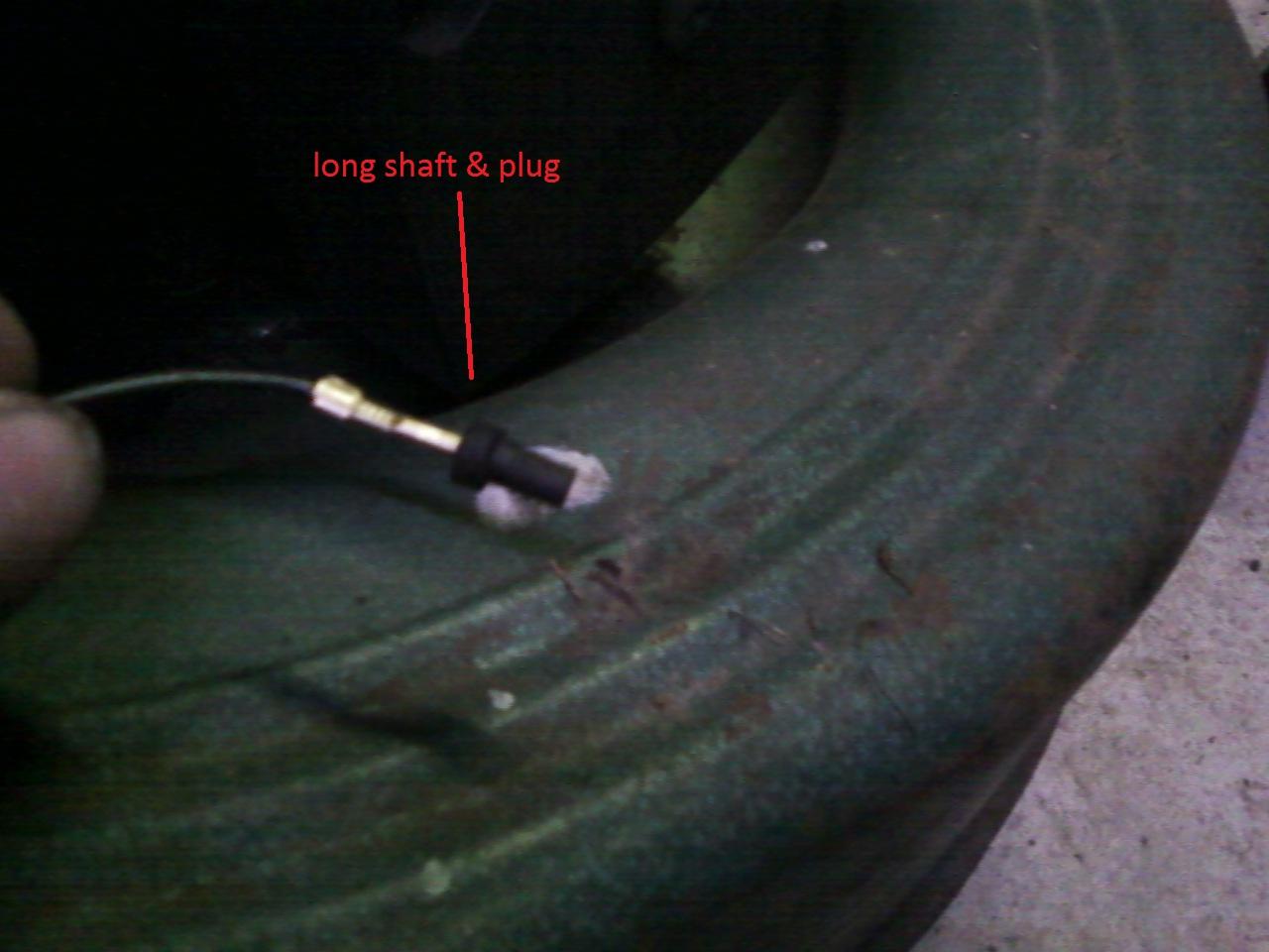

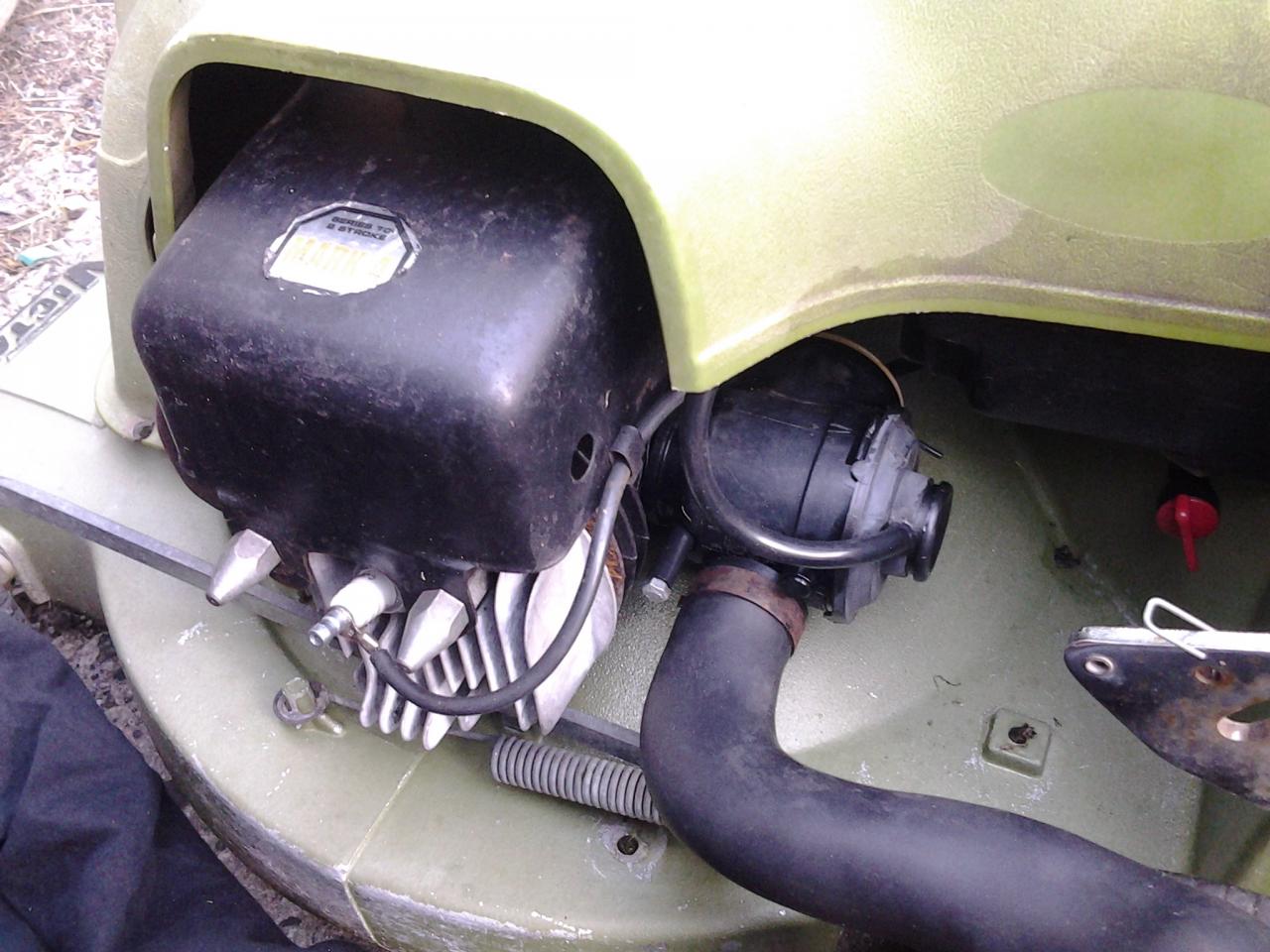

With these engines. To shut the motor off is that controlled by the throttle cable in the carby or by a kill wire? Cause i got it running sweet but wont turn off. An i cant get the cable to pull back any further lok. And theres a cut wire
Posts: 960

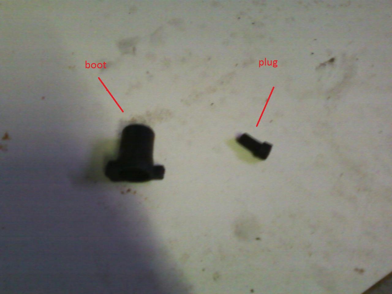

Hi Nathan, there should be 2 wires going to the socket on the RHS of the carby. Its a standard setup for the G4/LM carbs. On the full crank motor, one wire goes to ground on one of the bolts on the blower housing and the other one comes from the coil. You'll need the carby cutout boot and grommet but they're fairly cheap.

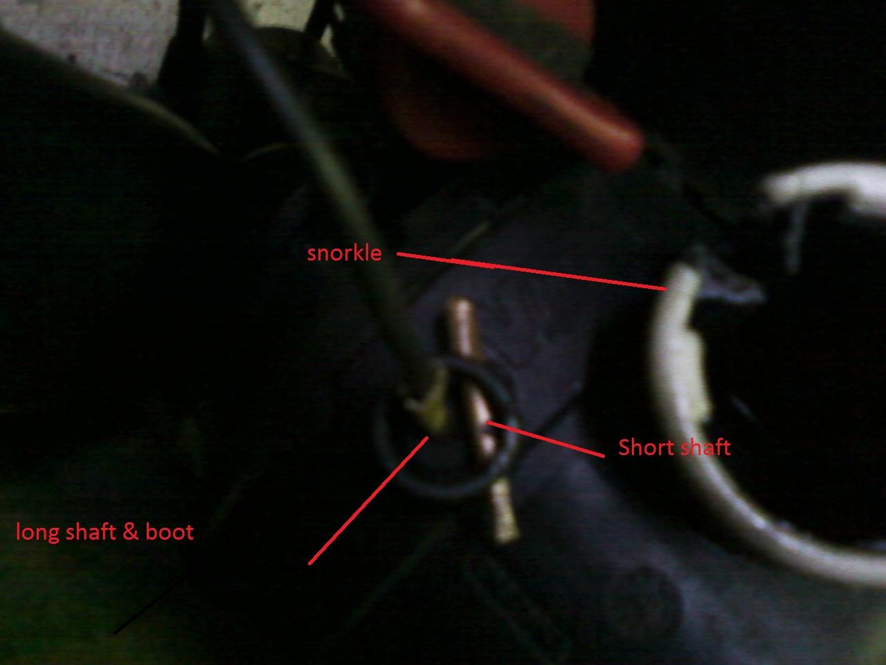

Would you happen to have a picture of the wire setup. Just so i can get a idea smile
Joined: May 2012
Posts: 467
hey it seems your also missing a decompressor.
wire set up pics ,
one wire from under the flywheel and one to ground under one of the cowling bolts
