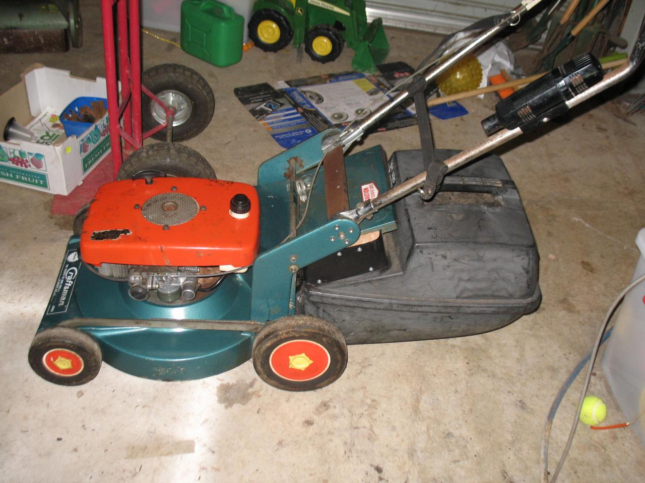

See pics mate! [Linked Image]
wink
EDIT: and a pic of a K11 (a square finned version of a KAV87)on a Craftsman I scored off vccomm! the pride of my Kirby powered collection woot oh for a catcher!!
