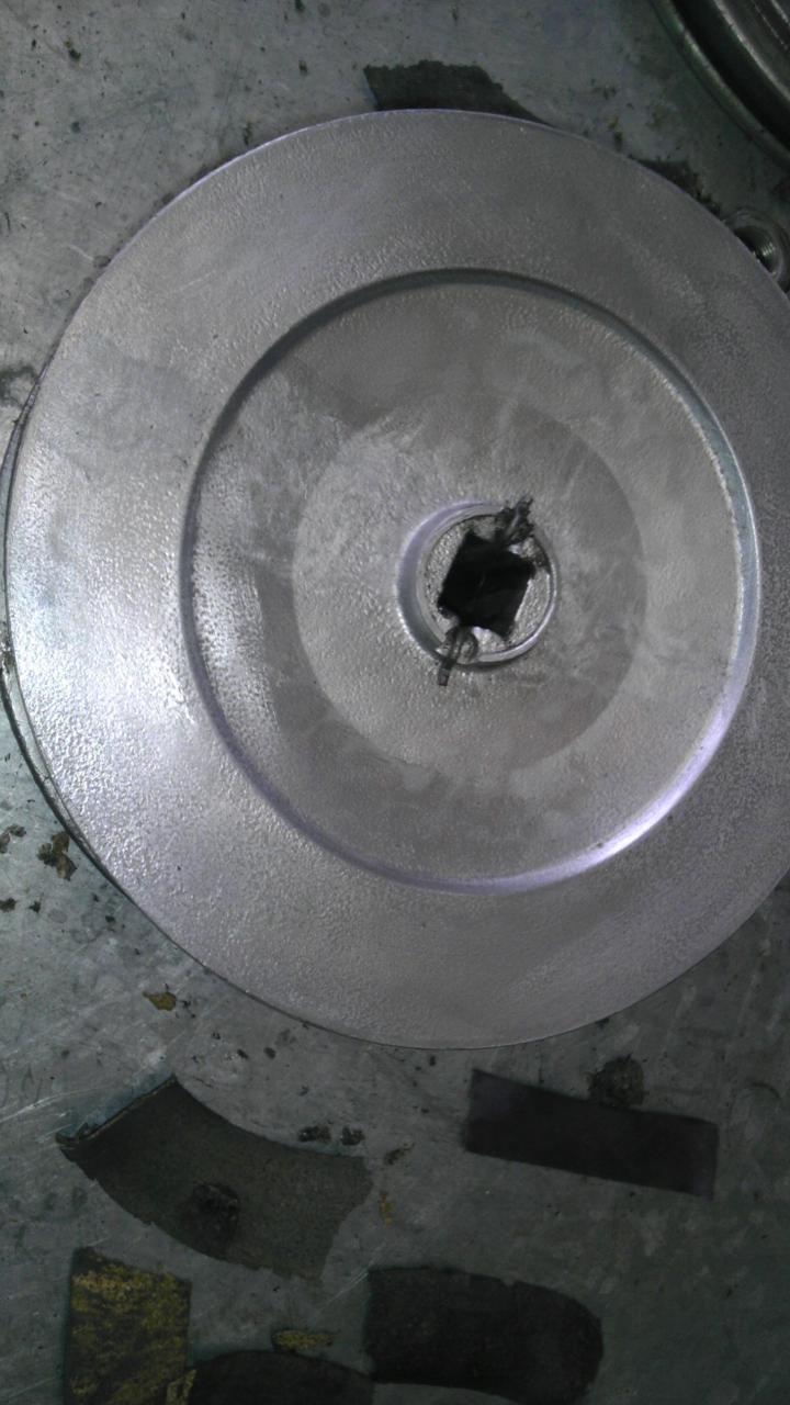

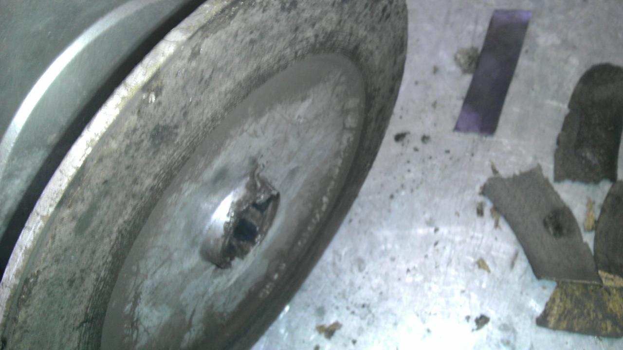

Alrighty i have got the new corks and have cleaned up the disks. I have attached a couple of images. I was wondering what would be the best contact adhesive to use to bond cork to metal.
I have one here that is a loctite automotive adhesive it says it is ideal for bonding most porous materials. I was going to go and buy a spray on adhesive as i have heard they are better but surely the stuff i already have will do the trick.
I just want to make sure it holds as i never want to pull this thing apart again.
I haven't used that brand of contact adhesive Matty. There seem to be several types, with different characteristics. The type I've used, in at least a couple of different brands, is a synthetic rubber dissolved in a mixture of solvents, mainly MEK (methyl ethyl ketone) - the glue is a brown colour and is slightly translucent. It looks rather like the stuff you are trying to scrape off in the pictures. I'm confident about what that stuff does, but when it comes to water based ones or strange green ones, I have no idea.

Can not recommend gasket stripper enough for a job like this. Sprayed it onto the disk once i had most of the cork off then just with a stanley knife i just gently scraped over the disk and it removed 99.9% of the remaining glue and cork, then just gave it a light sand.

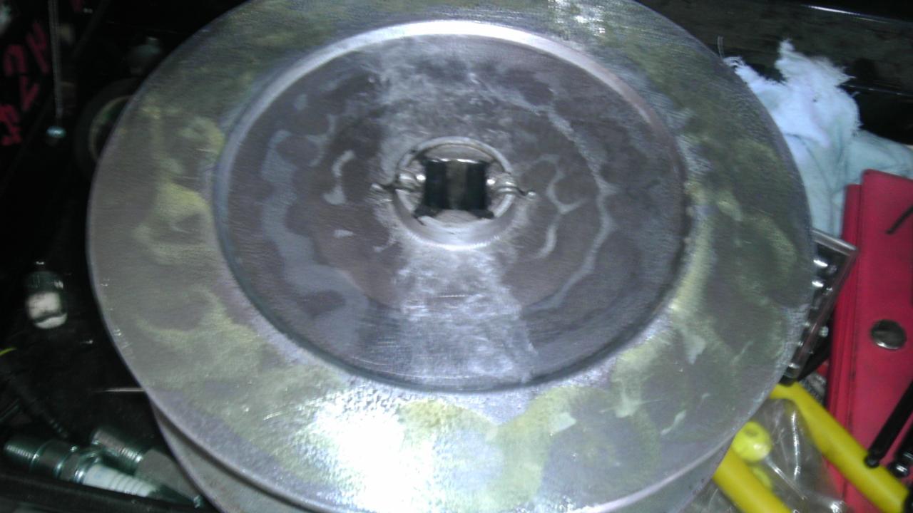

I think i might keep the rest of the pics to myself and do up a Workshop manual on the Rover Auto Drives. Then again i guess this thread could always just be a work in progress. Pity i didn't start with pics from the start. Here are a few pics of the gluing.
One thing to note - USE LOTS OF ADHESIVE. dont want the bugger coming undone.

Second side didnt glue correctly when i pulled the plates apart the cork could still be moved. I think i need to let both the cork and the disc sit with the adhesive for a longer period of time before putting them together
I've always found the last-stage-of-tackiness method to be uncertain. My standard practice is to put the glue on both surfaces, immediately put the parts together, clamp them hard, and wait at least 48 hours. I've never had a failure that way.
Whatever that glue is you are using, it does not appear to be rubber-based, and I probably wouldn't have used it. However it is a respectable brand, it will probably work out.
