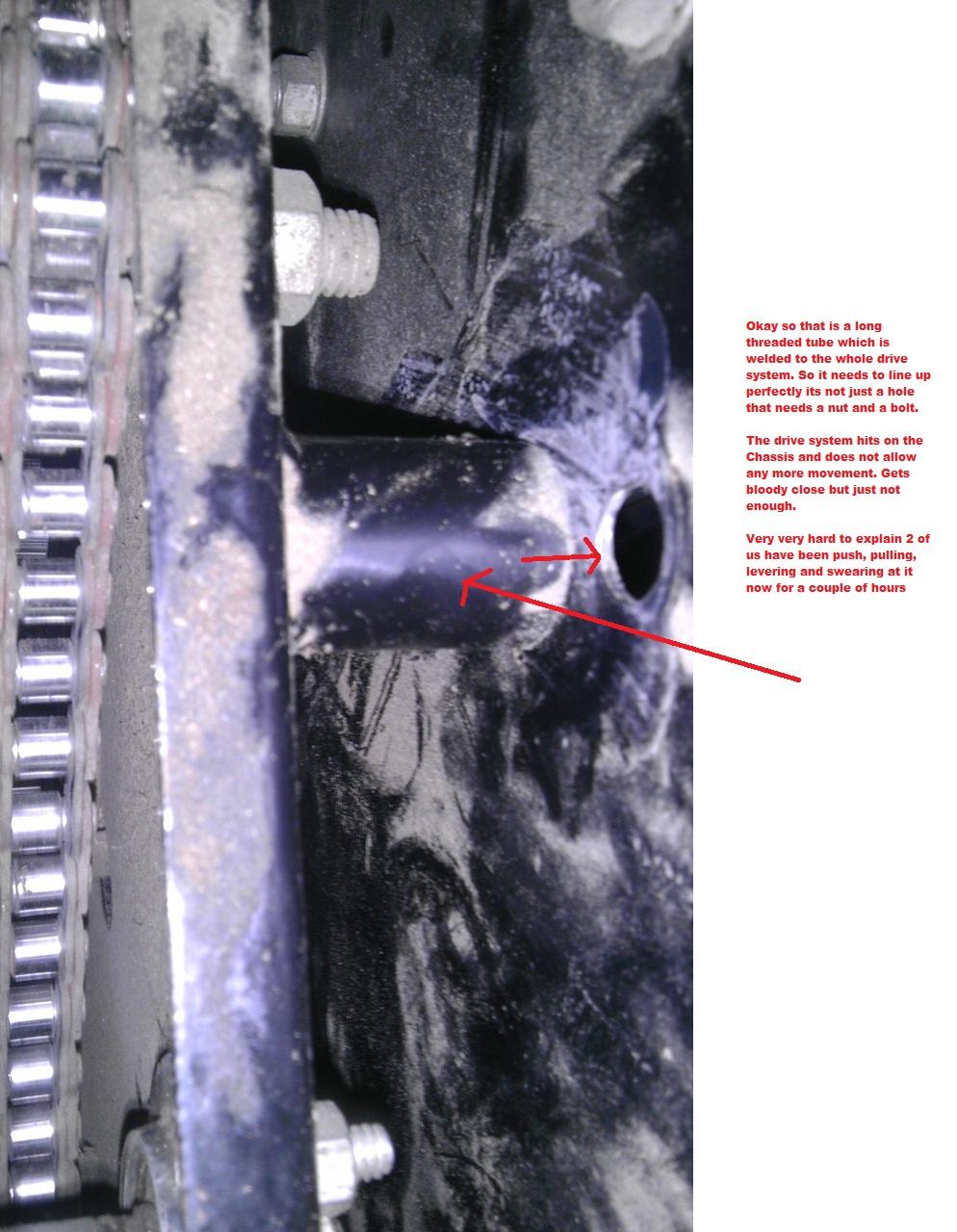

Well, it seems you have to understand just what is keeping it from moving just a small amount in the required direction. You have one big advantage in this: you know it is possible without modifying anything, because it was done before.
Posts: 26
What is preventing it from moving is in the previous pictures. Metal on Metal not allowing it to move any further. I am going to take a hammer to it this morning to see if i can bend the metal enough to just get it in. Old ride-on something may have moved over time. (started typing this this morning)
Okay have just got my brain back online and have now removed the entire drive system. Far easier than i thought, would have made my life so much easier over the last few days.
More pictures to come
Posts: 26
Okay things have gone a little better today. Learnt a big lesson, i originally just pulled the drive discs out the back of the machine, it would have taken me an additional 3 minutes to have removed the whole drive system instead.
Due to the fact that i took no photos at the start of this little mission i have got a misplaced spring. I swear it was working off the brake rod but can not figure out where. If any one could upload a picture of a rover rancher auto drive it would be great so i can see if i can spot it.
Picture below shows spring on the left hand side. And no that is not where it belongs ive tried putting it in a few places.
I think ill be enjoying a few beers tonight if i can get this one last spring sorted out.
