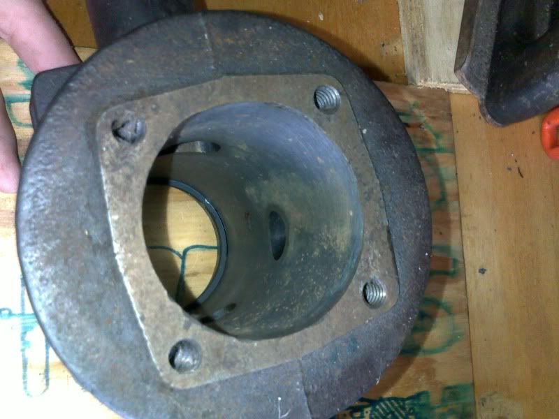

One Stuck Piston
[Linked Image from i31.photobucket.com]

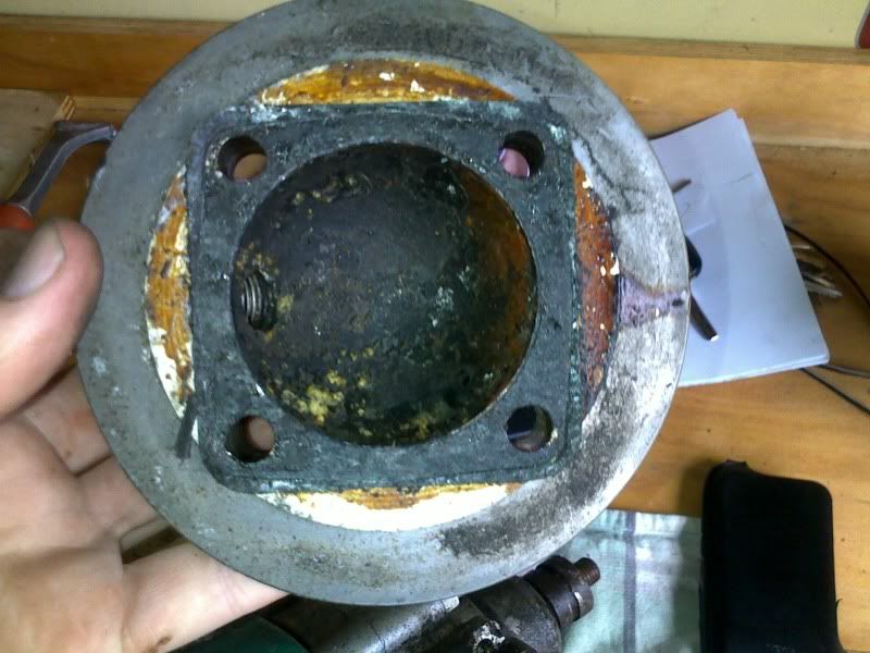

One Filthy Head

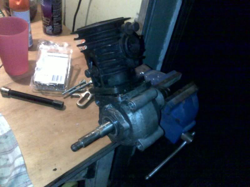

Half apart, just the main bits to go. Its missing the Key for the Keyway shown too.

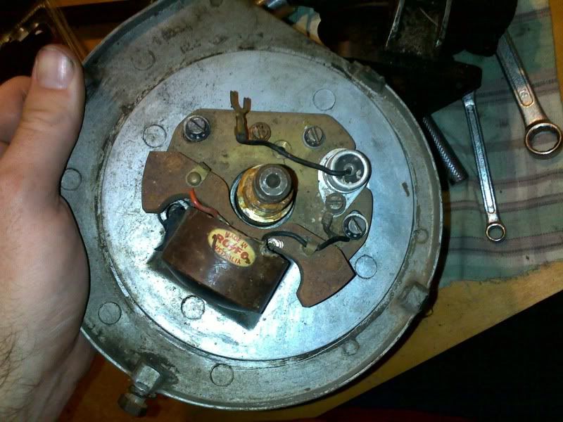

DOH, Broken Ignition wire. The Red one. It had electrical tape underneath it to, i assume thats where a wire runs too as there was a broken connection coming out underneath it where the tape was.

Any tips for removing the piston from the Cylinder? Also i am going to need a new head for it with a centre mounted spark plug.

Josh, no need for a centre mounted spark plug, just clean that head up.
Why do you want that piston? Looks like it has a hole in it anyway?

Yeah i'm already on that website, i dont want the Piston i just want it out of the cylinder so i can get the rod out.

Hmmmm, you may need a press to get that piston out. You could also chip away at it (break the alloy up) with a cold chisel. you may damage the barrel as well if you use a chisel but it looks like it needs a bore anyway.

Try putting some brake fluid in the cylinder and let it soak and you might find that it will release it enough to get it out. cheers2

I've done the oil for afew days, still wont budge, might have to heat it up then drop it into some cold water to get it out.
