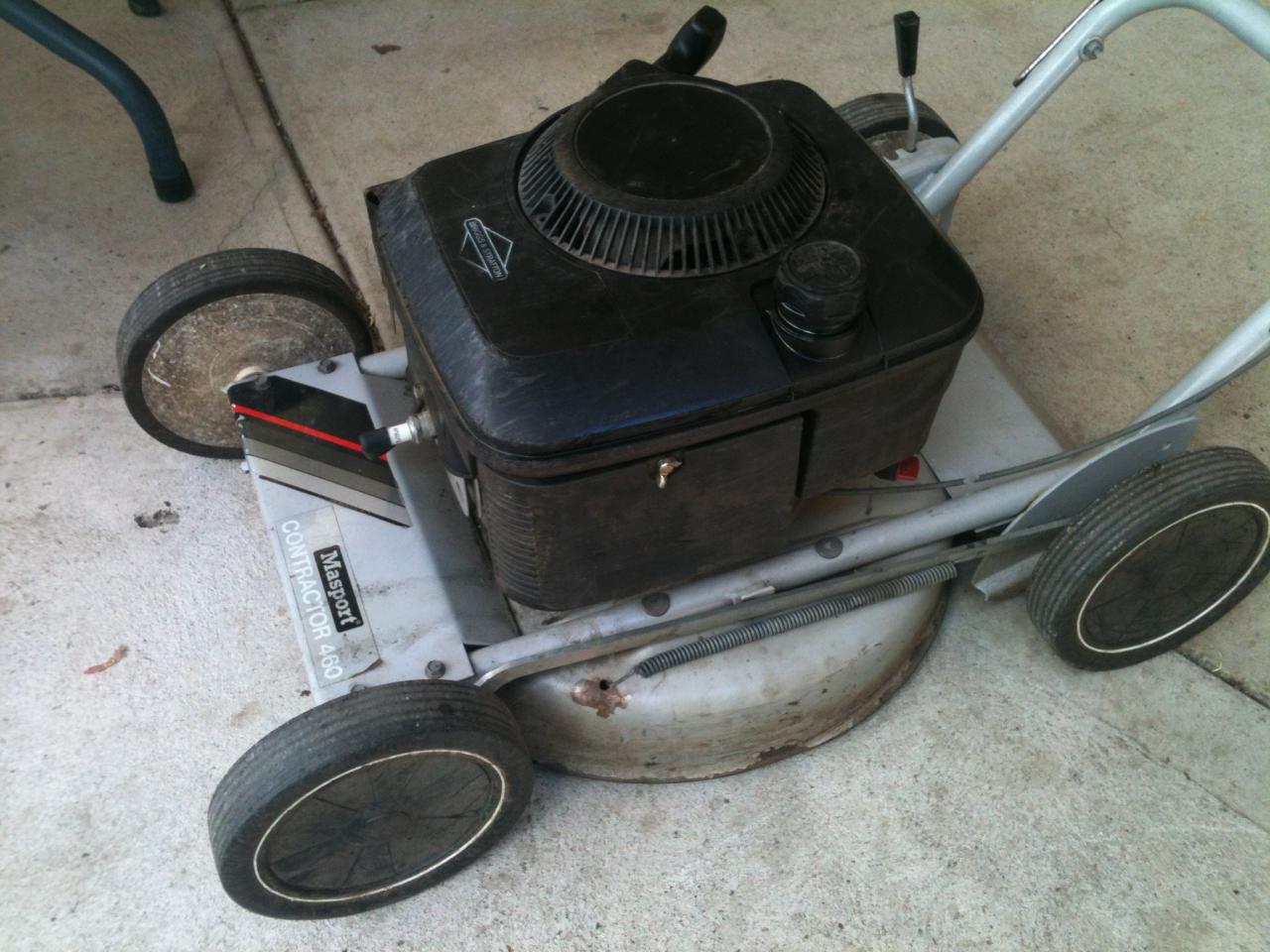

Its a masport contractor with a 2 stroke briggs model:95722, type:0220-01, code:891006.

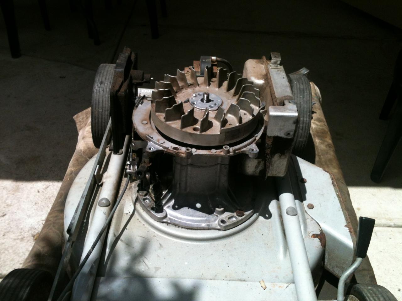

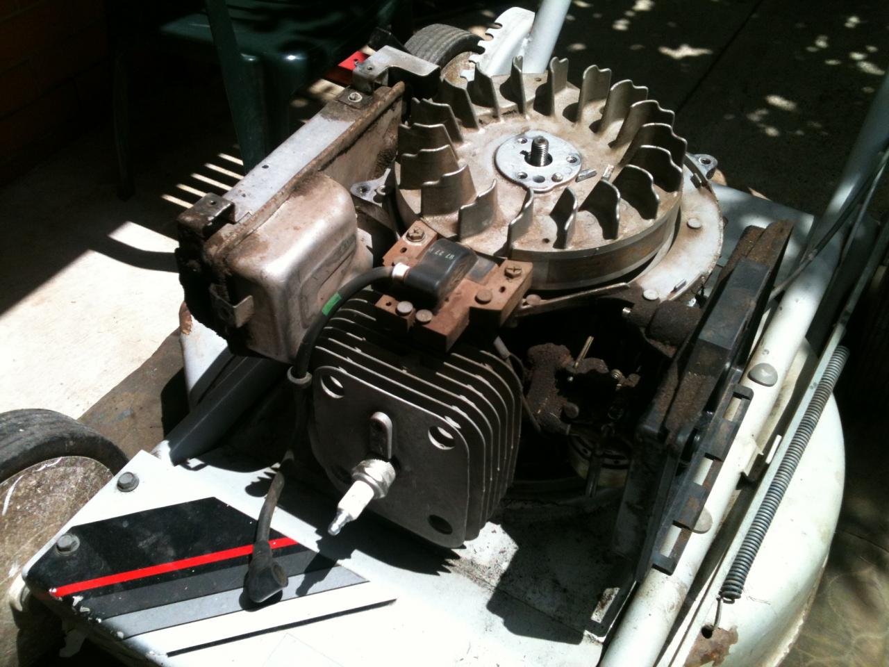

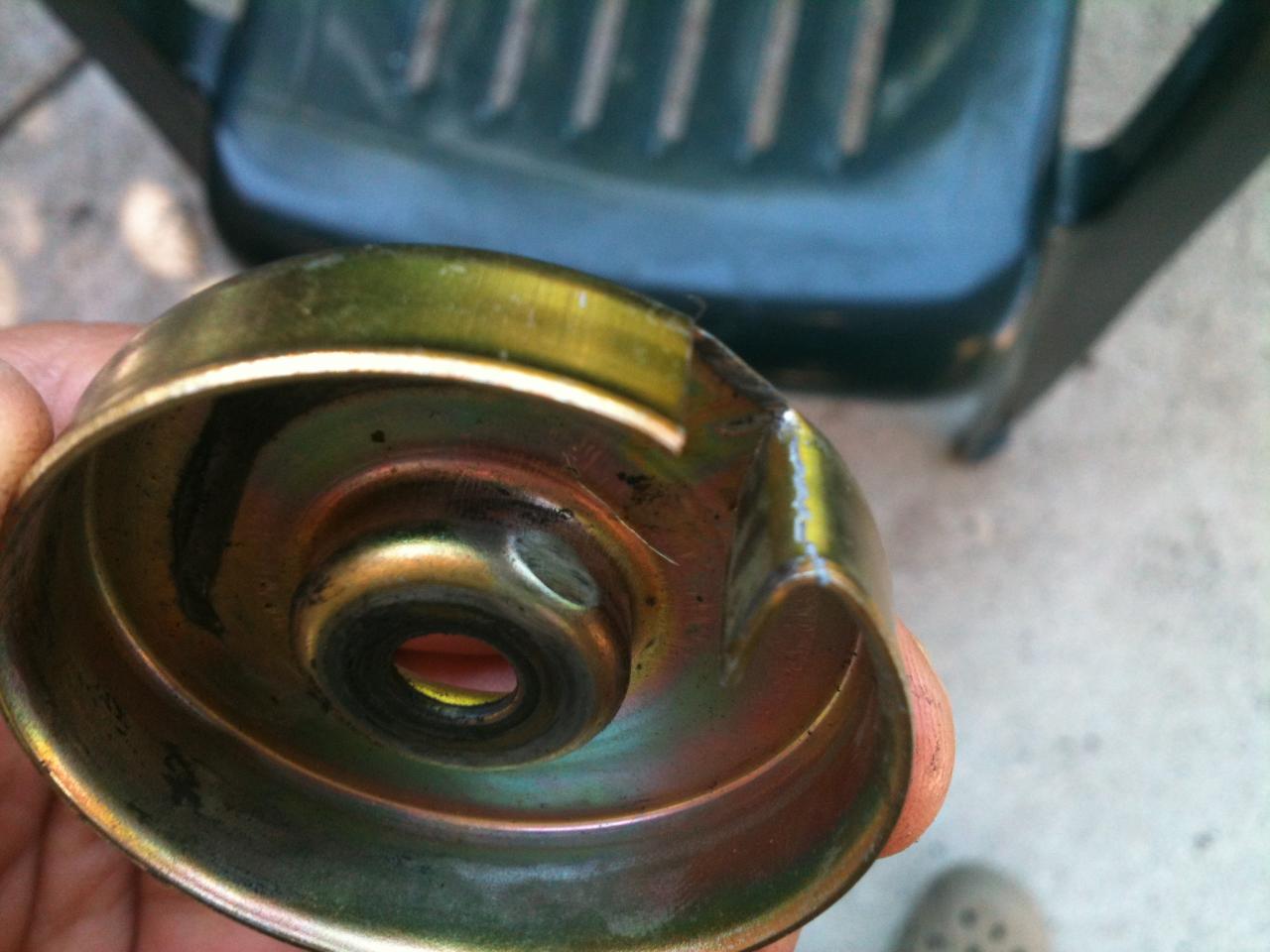

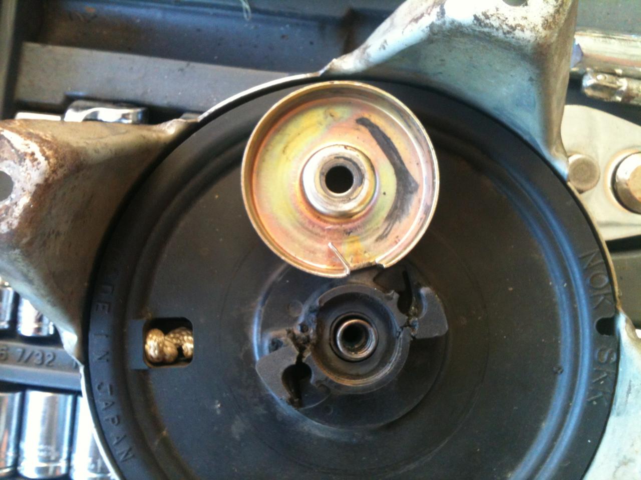

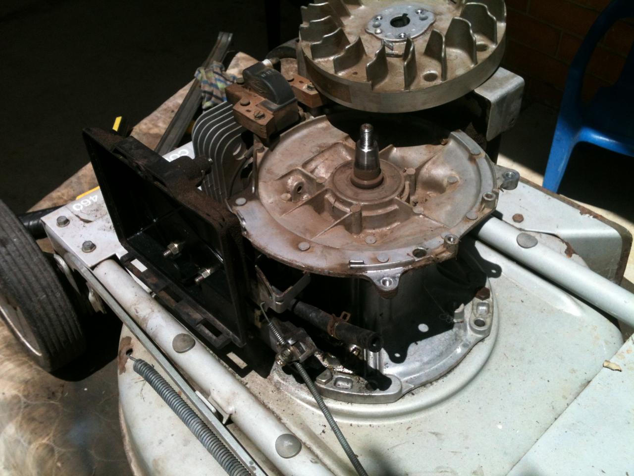

I've added quite a few pictures from different angles for members to peruse. As can be seen in the 4th pic, yes, the flywheel key was sheared and was out about 20 degrees. Its a half moon shaped key which measures up the same size as an earlier rover blade boss key. Now i have to find a new starter pulley as the old one cracked around the pawls because of the kickback (any ideas where to source a new one locally would be helpful)

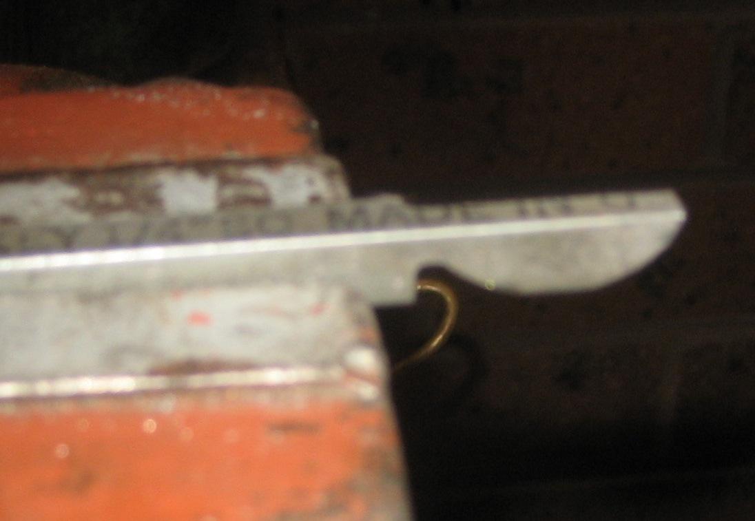

Briggs flywheel keys are usually made out of zinc so they can be sheared when the blade impacts something with enough force so that if the key did not shear, the crankshaft would break. If you have to make your own Woodruff key replacement, zinc will be hard to come by and you may have to make it out of aluminium. Do not use a steel key, such as the blade boss key, or the next time you hit something your crankshaft will fail in torsion. I think you have little chance of buying parts for that engine, but to find out for sure you should send a PM to Bruce, the Outdoorking site-owner: he will know for sure.
Here is the last Woodruff key I had to make - must be nearly a year ago now:
It is fairly straightforward filing.

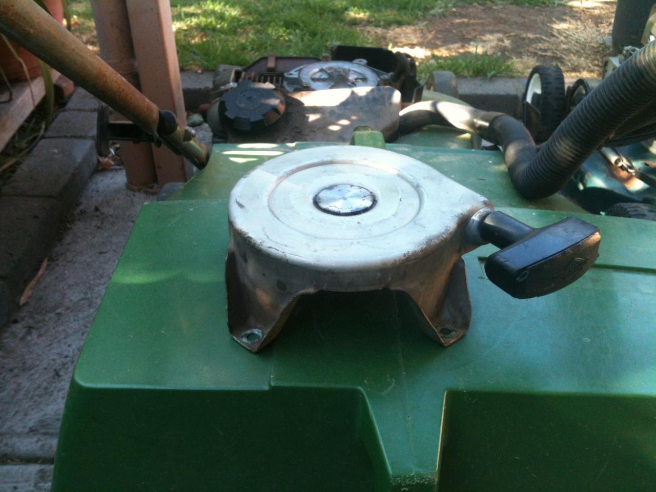

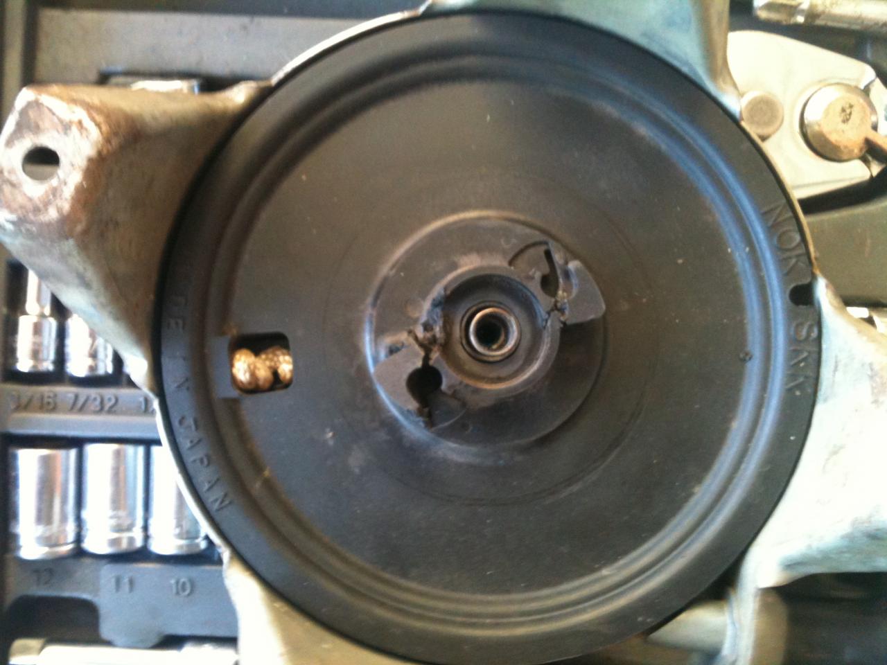

Thanks Joe, here are some pics of the starter, This unit only runs 1 dog as is evident by the 1 notch in the retainer. The retainer also has a hairline crack because it bent all the way around when it let go(as per pics). I bent it back around but it will inevitably snap off. The pulley has snapped both the mounts(they obviously have 2 so when one lets go you can use the other). The good news is these parts are available locally, the bad news is they come at a premium. Pulley $36, retainer $30. The key is affordable at $4. i would definately be interesed in a decent 2nd hand starter though. If you have anything thats remotely close let me know and we'll go from there. Nathan, i'd be interested to see a photo of the one you have.
The starter itself stands a lot taller than most "quantum" style starters and the starter cup is also considerably taller, althogh the mounting holes are equally spaced. A worst case scenario might be to modify the cup and starter off a quantum.
