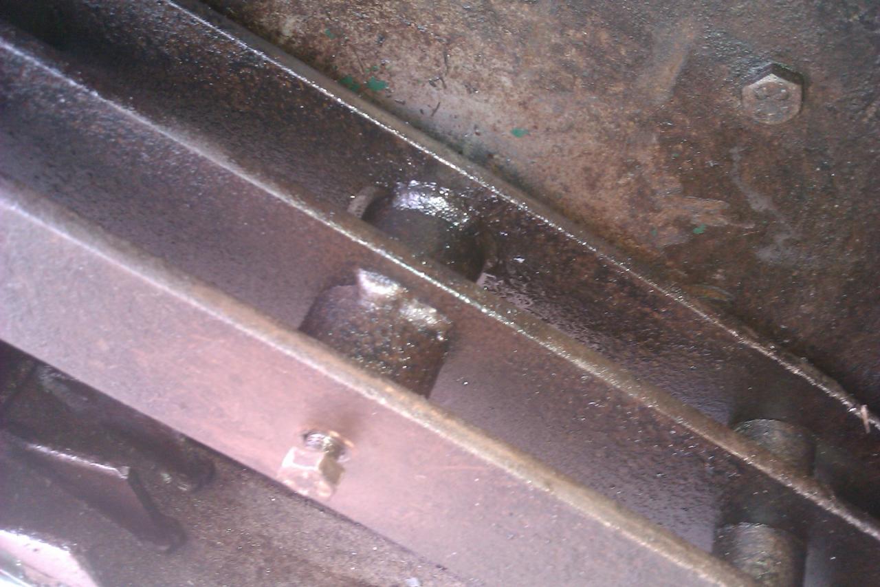

G'day Mutt. I can't help, but I'm tagging along with a similar problem. I've bought a well used Masport chipper/mulcher, I believe 1994 model, with a 5hp B&S. The blade assembly is in need of repair (see photos), and the crankshaft oil seals need replacing, probably due to the blade condition. I'm wondering whether anyone has one, or is familiar with them. The three blades have been welded to two bosses, which in turn are keyed to the shaft with what I believe are standard B&S keys, half round in shape. These had long since failed, as had most of the welds. It's hard to believe these welds were OE, as they are so poor, yet I can't see any other means of attaching them to the bosses. I'm considering re welding the blade assembly, then using grub screws through the bosses, set into the shaft, perhaps two to each boss, and wondered what anyone's thoughts were. I'd be grateful to hear back. [Linked Image]

I suggest you should not increase the drive torque capacity beyond what those two Woodruff keys can transmit, or you will break the crankshaft. The keys are supposed to shear when the machine is overloaded, that is an essential protective measure Briggs and Stratton have provided for their engine.
It does not look badly made to me, and I note that the keys failed, as they were supposed to, without much damage to the blades. Remember that the blades will wear (the machine looks as if it has been used very little or very lightly, in your pictures) and it looks as if when that happens the next step would be to break or grind away those tack-welds so you can replace them with new pieces of spring steel with three small holes in each. You would re-use the original spacers.
Joined: Dec 2012
Posts: 17
OK, thank you. I think I would have trouble replacing those blades, wouldn't I, given that they have the key way punched in them? I was guessing that the amount of slack in the keys and the welds, would have overloaded the system via vibration.
It looked to me as if the two collars with the keyways in them are positioned to coincide with the keys. The blades have to have big enough slots in them to allow the whole assembly to slide over the crankshaft, but they do not need to be fitted keyways - they can be filed roughly, since they are not driven by the keys.
The Woodruff keys should be a decent fit in the crankshaft and the collars. Those are all properly machined keyways, so good fits should be achievable. As you said, if there was a great deal of slack in the keyways, there could be a form of chattering that would hammer the parts, deforming them and causing premature failure. Keys and keyways must always be well-fitted, to work properly.
I do not know what you mean by slack in the welds.

Oh, by that I meant the slack created by loose keyways and failed welds. Half of the welds were just surface metal, with no penetration at all, so I expect would have failed early. If I re weld the blade assembly, and all else is OK, any thoughts on having the blade assembly balanced? And should I expect a damaged crankshaft bearing, given the leaking seal?

If it works the way I think it does, the keyed collars are driven by the keys in the crankshaft, and the blades are driven by the small welds joining the keyed collars to the blades. Those welds should be stronger than the crankshaft keys, but easy to break each time you need to replace the blades. An alternative would be to omit the welds and drive the blades only with friction from the sides of the keyed collars, in the same way as Victa lawnmower blade plates are driven. I think I'd use the small welds, since I'd dislike opening up the cutter housing every five minutes to remove some slightly oversize piece of sapling that had become wound around everything.
With only a 5 hp engine, I see this as just a thin sapling shredder, not something you feed tree branches into.

Masport tell me that parts are unavailable, so given that I didn't pay too much for it, I just hope to get it running OK, while planning never to replace the blades again.
If it works properly, by the time it wears out its blades you'll be having so much fun with it you'll happily make up a new set of blades from spring-steel strip. It looks like it should be just a few minutes work to cut the pieces of strip to length and drill three holes in each.

OH, OK. I'm quite happy to have a go at that. I guess the material is just salvaged car springs from the wreckers? I've also been thinking that I can just turn the blades over for new edges. My biggest question may be the key ways in the spacers. If they are OK, and they do look OK, then it's new keys, better welding and replace or turn over the blades. I'll need to have the keys in my hand to check the keyways, so soon after Christmas I should be at that stage.

The blades, sleeve and spacers are available and note that the unit is the same as a Rover chipper. Also note that the blade boss is not welded. [Linked Image]

That is interesting. The main difference seems to be in item 5, which appears to be the means of transferring torque to the blades. The relevant holes aren't shown in the blades, but the spacers and bolts are. It seems a much more definite means of driving the blades than the Masport's; maybe a later modification. Maybe I could modify the Masport?

I am pretty sure that the Rover is the same unit just badged different but will have to check with Masport or Rover when they return in the new year. The engine would be the same I am sure. Check the measurements HERE and if they are ok you should be able to make the change.
Note that I don't think the one you have is original because the welding on the spacer could cause issues like grumpy said about the crankshaft being damaged. The bolts are there for a purpose and that is that they should shear off and not damage the crankshaft and the key should shear as well.
