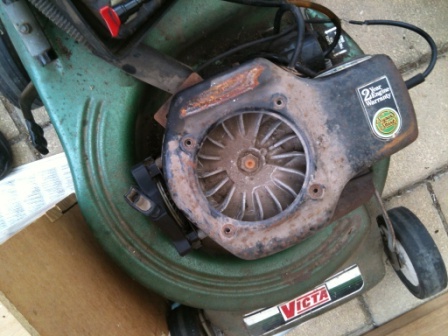

I can't see it. Here's a photo taken from above, do I need to keep stripping it down? [Linked Image]
Yes, keep stripping mate! wink
As Joe has said, take off the black cowling that you are now looking at, the decomp valve is the round thing on the top of the cylinder head above the spark plug.
Don't forget to post a pic of what's under the cowling. grin
the black cover is what joe meant by 'coweling' remove that too , 2 bolts/nuts on the head .2 small bolts on each side then you will see it . be carefull of the vaccum hose , it might break the SMALL connection on the carb ! be sure to remove it 1st from the gov' fitting on the coweling . just above the carb , a round looking jigger with a small hose from it to the carb'
