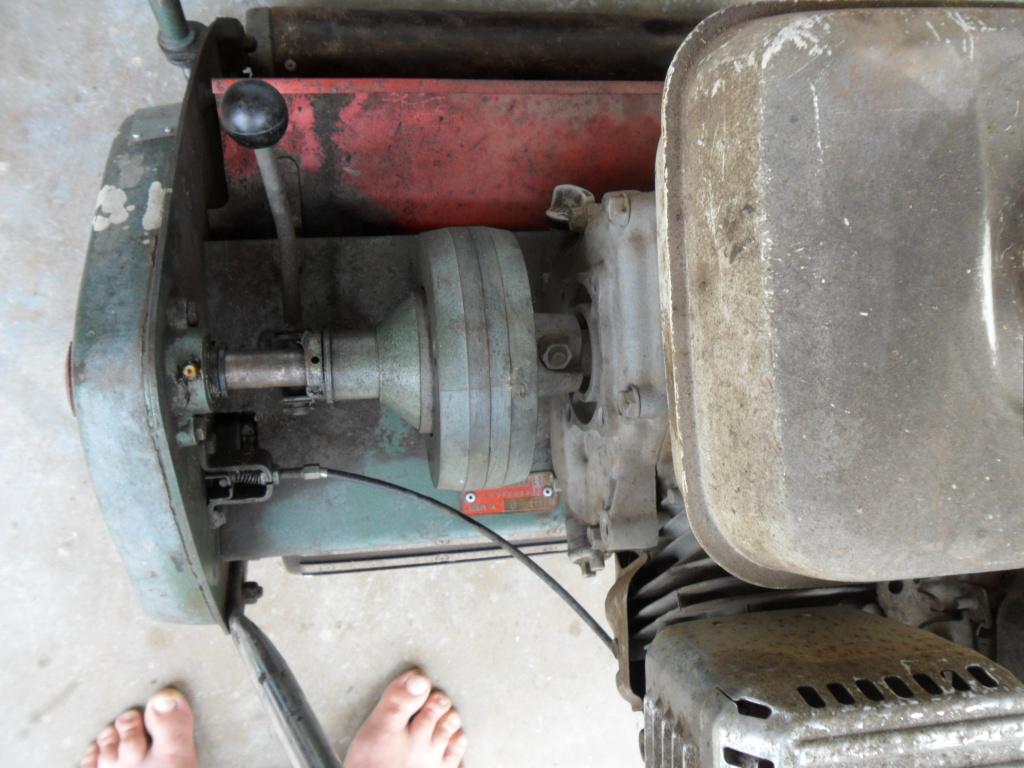

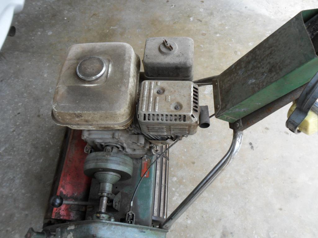

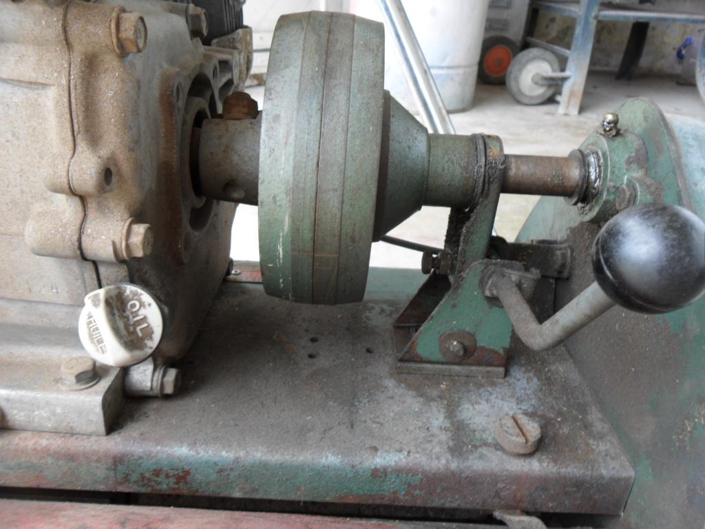

I put a 5HP Honda GX 140 on my 1968 SB45 in 1980 - and No - it didn't damage the mower and it has been in constant (domestic) use since 1980 with the 5HP Honda.
Yes - the exhaust is a pest - so I welded a short copper tube elbow on to the muffler to direct the exhaust out to the left.
The installation is a big / fiddly job but if you are carefull with the mark out detail - it works out OK. I have attached a series of "happy snaps" of my SB 45 "beast" with its 5HP honda onboard. These will show you how / where we mounted the Honda on to the solid engine deck and relocation of the clutch assembly etc.
For some further comment / explainations as to what was involved - have a look at my Thread "How Much Meat Do I Need on SB 45 Reel" in this forum and discussions / response to "Grumpy" 23 November 2012.
Best of luck and hope it works out OK

Yes Grumpy you are correct - all that fiddling around with the Honda engine location / relocate clutch was due to the need to have the engine entirely inboard of the chasis. If an overhang wasn't going to be an issue - then changing to the GX140 would have been a straight bolt on job.
My muffler conversion was just a silver solder braise exercise with some 1" thin wall copper tube - its been there since 1980/1981? as I had the same problem with the exhaust blowing up into my face, which is the pits.- The elbow fixed it - not pretty I know - but it works and has stayed together for 30+ years
