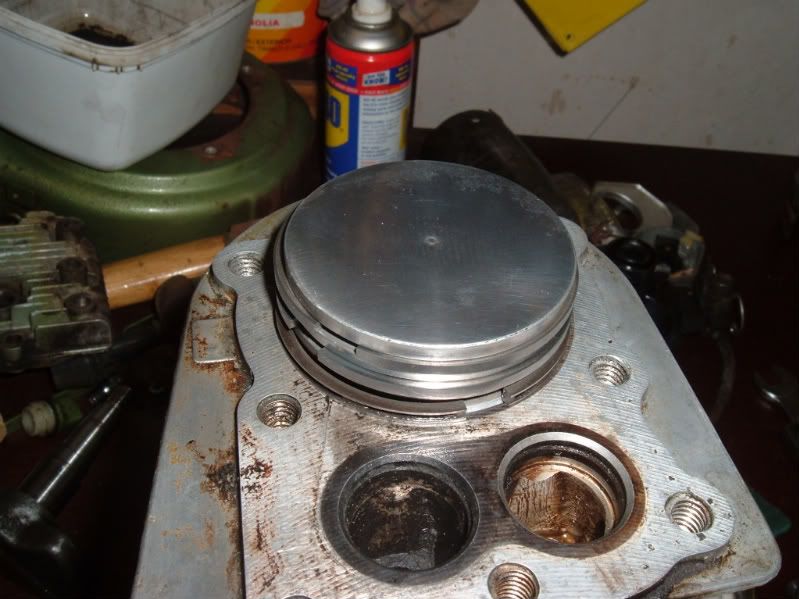

Well I tore into the engine this afternoon. There was a heap of sludge in the bottom of the crank case, mainly cloging up the oil drain plug holes. The valves and piston had reasonable amount of carbon buildup on them. This has all been cleaned off, the rings still have a servicable gap on them, so no need to try and find new ones. The piston looks really nice now, I couldn't resist and polished to top of it...
[Linked Image from i27.photobucket.com]
Next up will be to lap the valves into their seats, the inlet looks fairly good already, but the exhaust does need a bit a attension.
I am now in a bit of an undecided state of mind... Do I strip the whole thing and try to restore it all to as new condition, or just service what needs to be serviced and leave the rest as is... I think I'm leaning towards the later as I do plan on using the mower, not putting it on show. And if I do a full resto, I'll end up being worried about using it in case I scratch it.
I agree the exhaust valve seat looks as if it needs lapping. Don't forget to check the tappet clearances - especially after lapping, they may need to be increased by removing a small amount of metal from the end of the valve stems.
Personally I don't see much sense in doing a full restoration on a mower you are going to use regularly, but what I do like to do, is fix any part I have to work on so it won't need to be fixed again. If you tidy up the engine mechanically, all you would have to do in a later restoration is make the outside look pretty: the inside would already be good. I also like to ensure that nothing will deteriorate while I own it. That probably means de-rusting any parts that might get pitted without attention, and doing a rudimentary paint job (zinc chromate primer and brush-applied rough colour coat) to keep it from rusting again. However we probably all have different ideas of what is a sensible job of preserving the machine. I think Deejay enjoys polishing his restored SB after each use, and generally treating it like a new car whenever he drives it.
