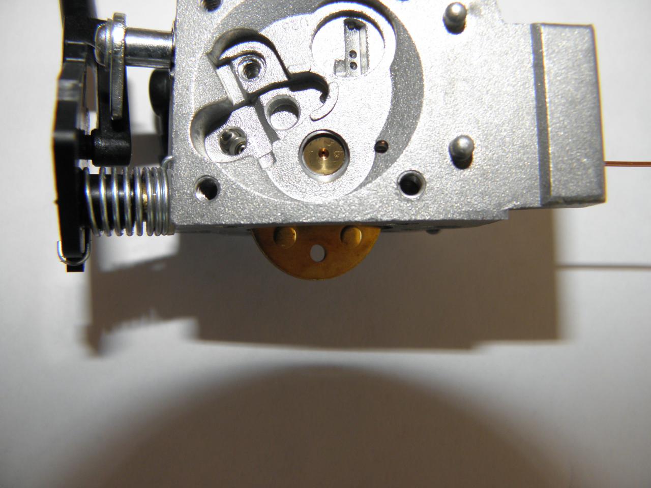

I must admit that this carby has me a little puzzled. I have attached some images for your advice and comment. I appreciate that the exploded view covera the whole WT series, as my carby is much simpler and has no manual priming gear. The carby image shows the main block and the choke and throttle shaft assemblies only. For interest I have inserted a copper wire through the power needle seat as far as it will go. (Wire diameter is 0.67 mm.) You will see that it passes across the main jet fuel pick up hole to the right of the main jet check valve/block?. It appears to enter a side opening in the base of the main jet block, which seems to be solidly blocked.
Compressed air and carby cleaner fluid will not pass through the main jet when fed from either the power needle passage or the base of the block which can be seen in the image. The base of the main jet block bears the number 34, and has a small hole at its centre. An even smaller diam. hole is centered on this one.
Looking at the Walbro manual images which illustrate operation at idle and full throttle, a check valve is shown preventing main jet fuel flow at idle. As a check vale is usually operated by pressure difference across the valve, can you tell where such a unit would be sited in this carby - maybe the valve is stuck shut? As the fuel appears to enter the main jet block from the side and not the bottom, can you suggest a means of cleaning it while it is pressed in place in the carby block?

You placed your air tube in the same place as shown on the top of Page 15? By my reading, that might not work on a WT. Look at this diagram from Page 2 of the WT manual:
It seems to me if you blow in the hole surrounded by the green circle, you won't achieve much because it is blocked off below the main jet. If you blow in the hole surrounded by the yellow circle, and you have the high speed mixture screw backed out several turns, it should pass air. If it doesn't, it may be time to take physical action regarding a possible blockage.
Note that if the diagram is correct, you also can't drive the main jet out from the green circle hole, because the plug is pressed in against a shoulder, and the bore the main jet is pressed into is smaller.
To amplify what I've said above, there is a small block of metal which incorporates the non-return valve, and has the main jet pressed into it. This block is pressed into the carburetor body from below (i.e. from the metering chamber) until it reaches a stop, which ensures that it projects the right distance into the venturi. From the workshop manual it looks as if this may be one of the cases where to remove that block, you are supposed to drill a hole in it from the metering chamber, then screw in the self-tapper-like thread on the end of the little slide hammer puller that is included in Walbro's toolkit. You extract the original block, then you drive or press in a new block. However I don't see why you would want to do that until you had tried blowing air or carb cleaner into the yellow-circle drilling, to see whether it comes out through the main jet. If it does, all is good. If it doesn't, after some head-scratching it might be time to resort to the slide-hammer puller, provided you can get one, plus you can get another jet block cheaper than you can get another WT carburetor from a junked chainsaw. However I'm guessing that if you blast some carb cleaner into the yellow circle passage, it will come out through the main jet and all will be well.

Thanks for your post. FINALLY, I can get cleaner fluid to pass from the yellow-ringed opening through the main jet into the venturi. I will alternate between using the fluid and compressed air to ensure that the jet passage is as clean as possible prior to carby reassembly. As the main jet diameter is probably quite small, (maybe order 0.5 mm)attempting to blow air by mouth results in a fair amount of back pressure, which makes it a little difficult to judge if the jet passage is fully clear/open. Experience required? The same holds true for the use of suction to judge to if the check valve is operating correctly.
