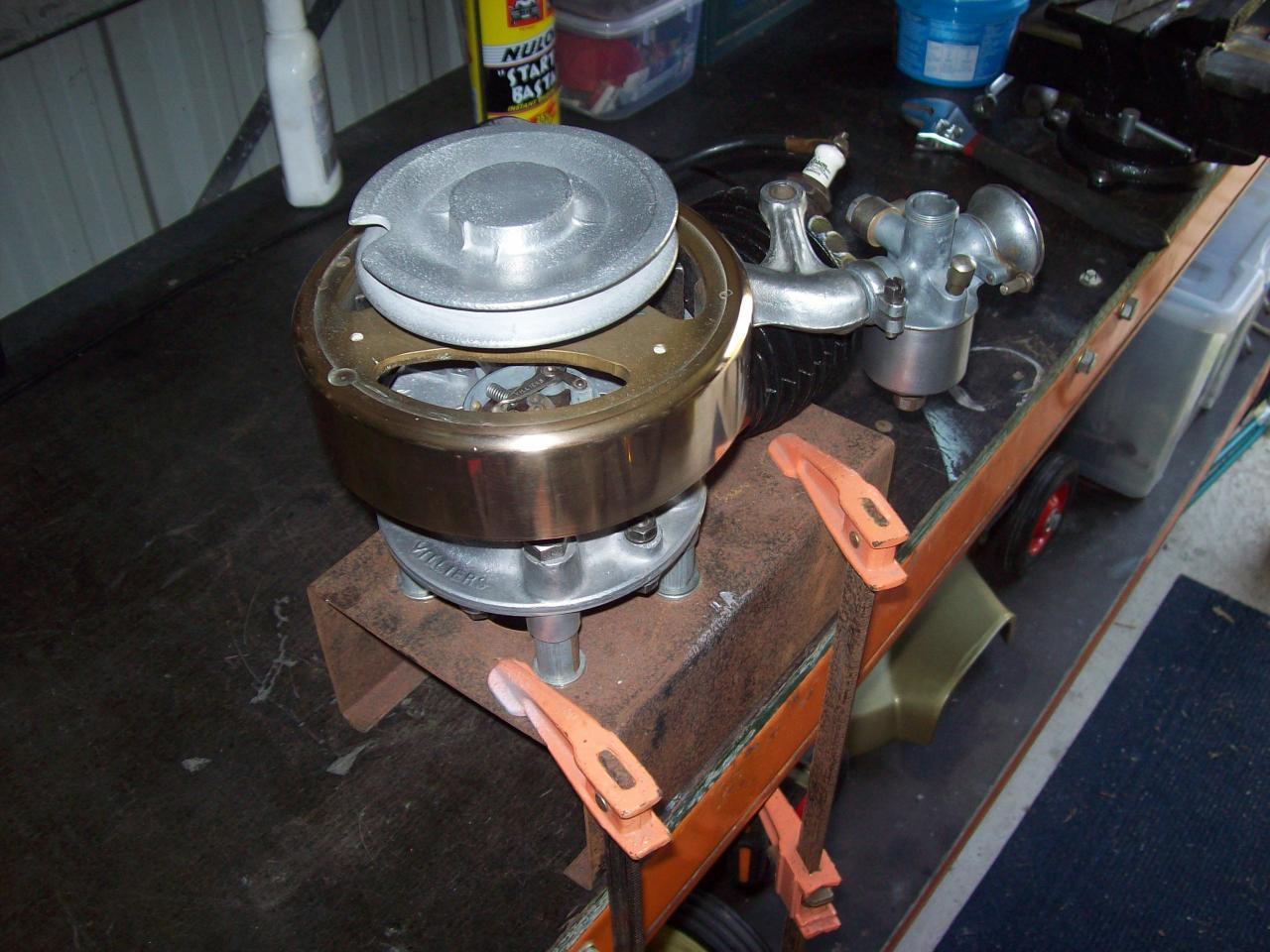

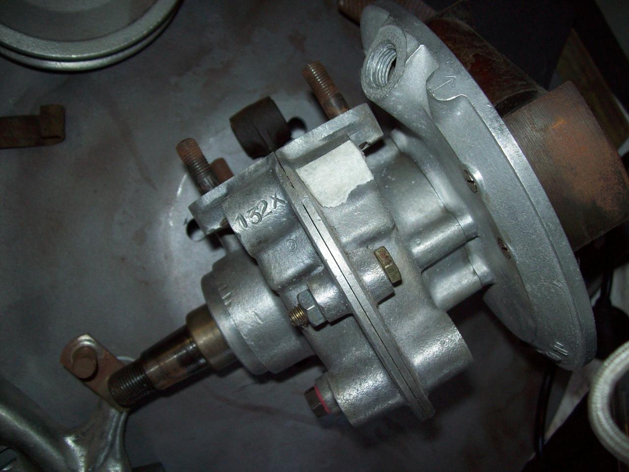

A quick peek at the first progress pics of my next project,Late 54"Victa Model 2 Fan mower,Ive noticed a lack of earlier models so over time I will put up a few of the real early ones some complete some restored and some in progress:)
As some of you know these are very rare,and while there a couple on you tube and some images ive not seen anyone post one in progress(correct me if im wrong)All parts are correct.Clingcast pully,fan manifold,carby and engine.Base has been blasted and the sides lead wiped and reshaped.Parts remaining are new rings and gasket kit(melbourne)new throttle cable...thats about it.Oh the Fan...Well,ermm she is very shy and doesnt like her photo taken.lols naaaa just kidding,its in storage and will be the last piece to be put on.The "Crowning Jewel" so to speak)lols.As the mower nears completion all parts will be displayed and explained for those who havnt seen this model before:)...Next model is............Model 1 Rotomo unrestored original....Ill post pics soon.Hope you all enjoy:)[Linked Image]

Is it possible to get a close up inside the ignition box, that looks like quite an interesting set up, from here I'm under the impression the points are controlled by a lever to the cam?

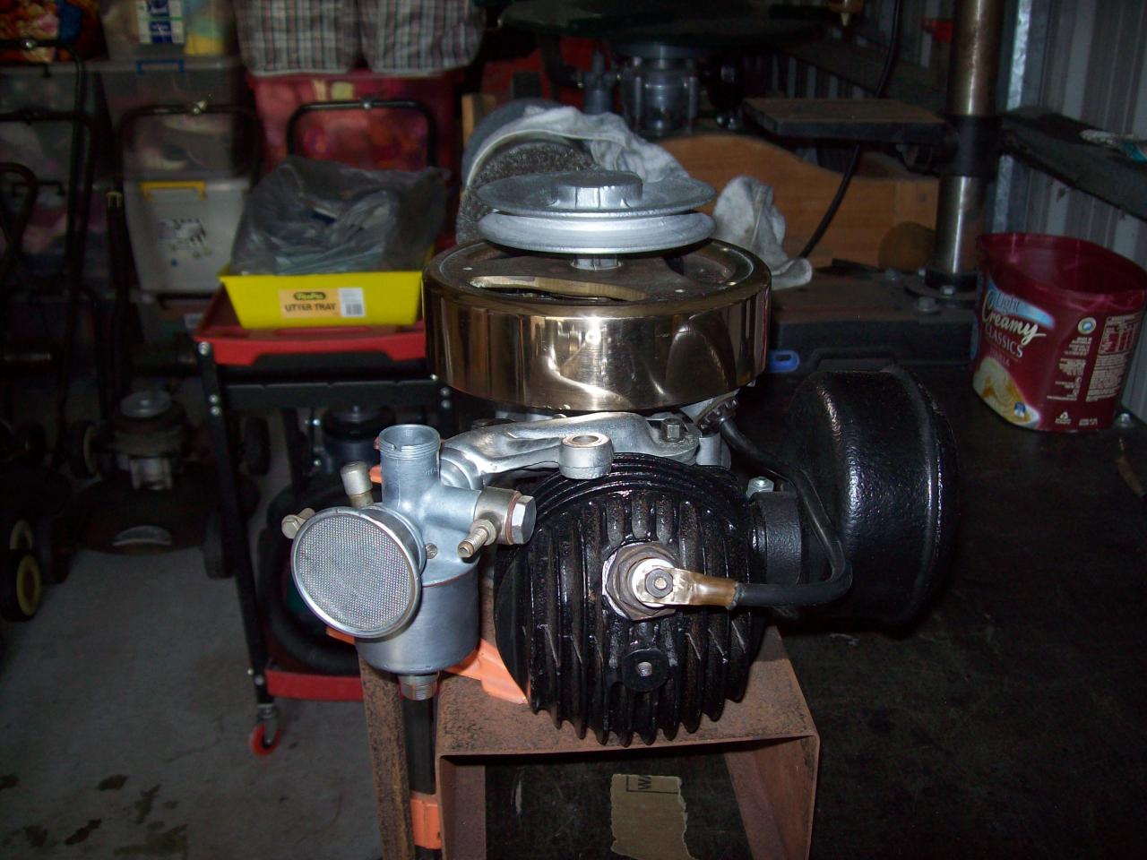

Finally got this old relic running,and very happy with the results.She runs beautifully:)So Ill strip her back down and blast the barrel and repaint,and tidy up all the little bits before fitment.Coil was shot,rebuilt the points assy.piston is at 30 thou with very little use thank god.new rings gaskets.plug is period and works fine.shimmed the crankshaft so it has minimal play.Need top cover and throttle return spring for the carby.And of course the Fan.Throttle control is like new just might fit a new cable.Wheels have been lead wiped and in putty.The base is now complete and painted.ready to rework the axles and brackets.Tank and bars are fine+badge need painting.Wants....Fan assy have original braket,top flywheel cover,carby return spring,and tyres??? Might just lathe some up if i cant get originals?Think thats it.Hopefully soon things will progress quicker and we can all see it complete....Hopefully! lols

good job looks new, the brass flywheel looks awesome...
I have a very similar engine fitted horizontally to a funny little reel mower here, and another similar engine fitted to one of my motorbikes, the way I polished the flywheel on the bike to have a similar finish was pretty stupid and unsafe so I wont say how I did it here, but they polihsh up well eh? wink

Thanks heaps Guys.Chris,the fly wheel was lathe polished a few years ago,but ive had it sitting since then,the engine will be stripped down again and repainted and polished.And Joe Dont be shy,how do you think I gave this a quick polish?????Dangerous??? Bleh The fumes in the shed were worse...lmao.
