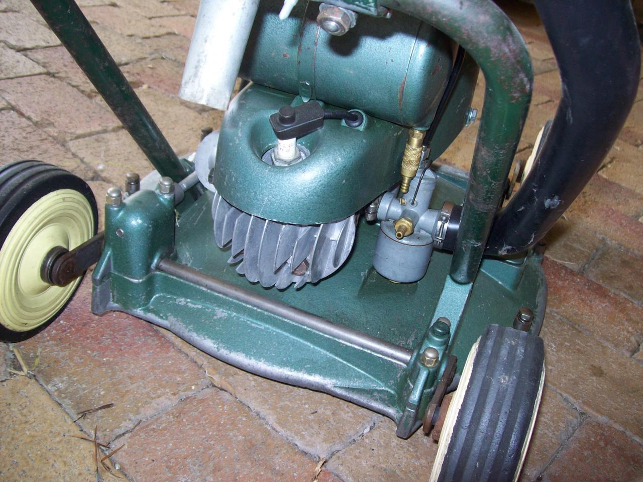

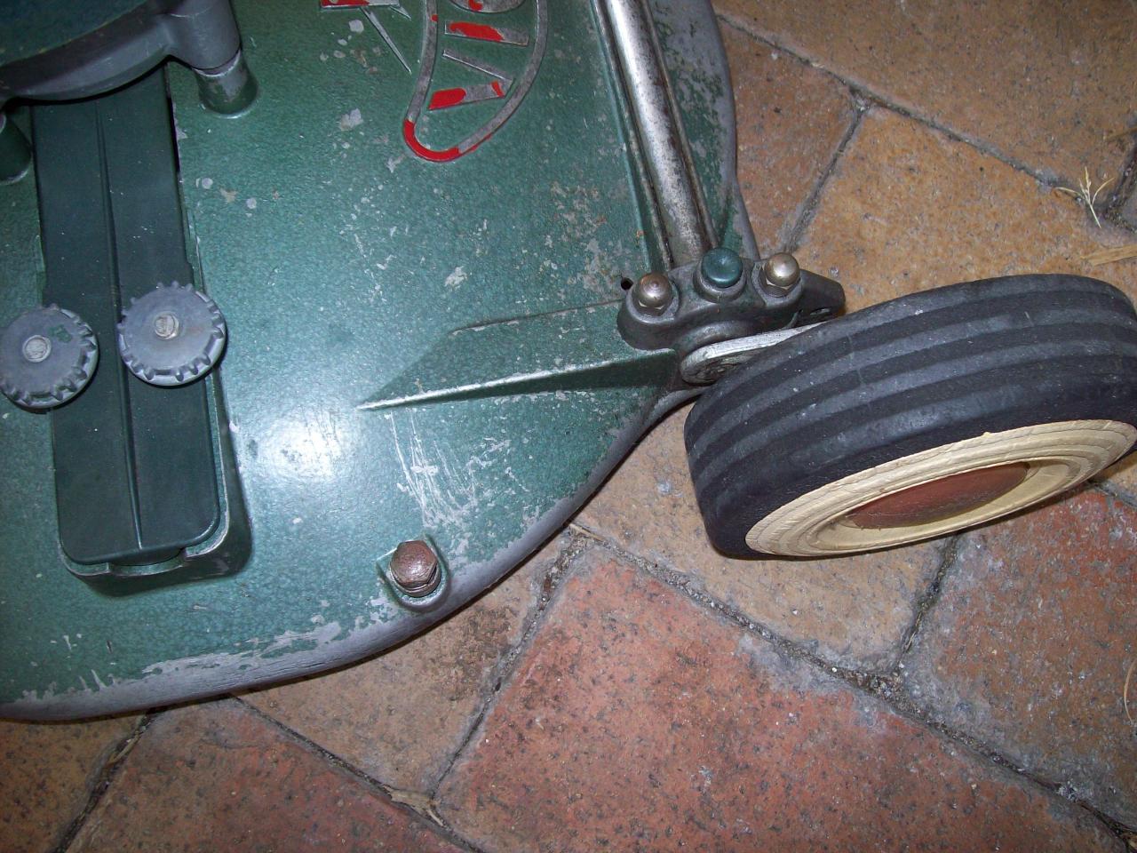

Hi all, great forum
Picked up this 18 last week from the auctions, no one seemed to be interested so I bought it for a song.
I need to I.D. the old girl (year, model, etc) before I begin the resto, so if anyone could help with that I'd greatly appreciate it.
The mower turns over and runs, none too well but runs it does!! The period 'strut' attached to the handle appears to only hold the handle in the upright position, as the fold bracket doesn't do up tight and slips. There are no cracks visible on the handle tubes or the bracket.
I gave it a bit of a steam clean to get rid of years of oil and dirt/grass.
Engine No #110107 with the number #3 stamped under it on the lower case.
After researching on here I believe it is a 'Predicta' converted to a later model setup? I've gone a bit crazy with the pics 'cos I'm a bit excited to have it!!
I've added the 'Before' shot, as I picked it up

This is the one you referred to in the other post Second cut?.Well what can I say?.You Have for almost certain a beautiful little reverted Model 4 Predicta.Less of course its main bits.The engine no puts it in the very early class,being approx one of the first thousand built.Its running the hammer axle housings and oil nips,which again denotes the early style.As ive stated before,with the exception of the purpose built model 4 STDs.The predicta was often reverted back to its base form because of parts/operation failures and issues.Either way this is a very nice example of one of the reverted models and NOT a model 4 STD.As for parts to make it complete,the front and rear predicta setup and side skirts/bolts/springs,are very expensive and hard to come by.If it is left like this which personally I would do,until you come across the other bits,you will need
New choke,yours is correct but broken.
pull knob for the starter,
new or a good set of SH wheels
correct.cigar fuel tap.
also I cannot see your throttle.
Dont think ive missed anything,
All else appears correct even the red crank case drain plug.
So this is/was without a doubt a genuine model 4 predicta.
And huffs,Yours is a few hundred earlier than mine..pokes tongue out*
Lovely little buy second cut,very happy to see more come back to life,whether they be 100% genuine or a revert,they are still a great model.
Oh I forgot,Date code for this should be "1957" since yours is a very early model.
Also I looked again at the engine no,I looked quickly and thought it to be 111,107 when I posted,
but its actually 110,107 which If im not mistaken,would make it aproximately mower no 107...How cool!!!! never seen one this early before..Gimmmmeeeeeeeeeeeeeeeeee grrrrr!!! lols.

[Censored] secondcut good work.Yes I would have to agree with Blue on this I do believe that your mower was released as a Model 4 Automatic.I can see that due to a few things engine number,correct edger gaurd correct colour of axle towers and the correct fuel cap.It's a shame the flaps are not on there,but if I was you I would start the search.It may take a while to find,other things will be easyer like cigar fuel tap.Still hard to find but are out there.Again well done and hope you enjoy your rare find.
