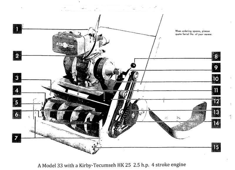

The Model 33 Mark 1 Scotty was first introduced in 1960 and is a 16" machine with a Villiers 98cc, Mark 3 'Midget'...2 Stroke engine and all chain driven and a segmented wooden front roller. wink
The Model 33 Mark 2 (also 16") was fitted with a Kirby Tecumseh HK25, 2.5Hp... 4 Stroke engine and was belt and chain driven and the metal front roller and alloy end caps.

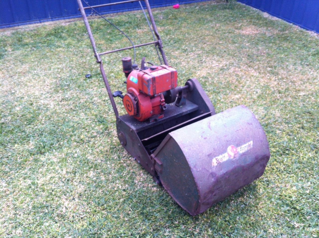

Here's a pic (sorry about the quality, its the only one I have)

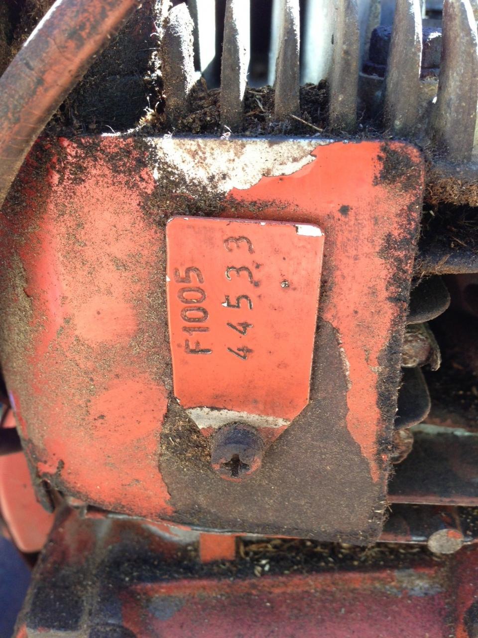

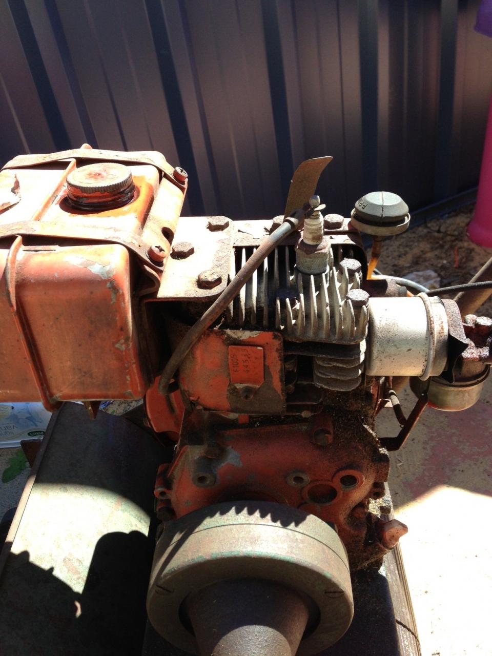

Thanks again for the replies, here is pictures as requested. I might buy a new engine for it next week once I have worked out exactly which one to use but I think I will use a B&S engine, at least this will keep the old girl going for another 50 years.
Grumpy, it didn't sieze due to lack of attention. I have only used it a few times since getting it back from the mower shop after new bearings, belt, bottom blade and a sharpen. I think they even changed the cork on the clutch as well. The engine unfortunately when I bought it was tired to start with, although it was extremely easy to start, it had hardly any compression and didn't sound too healthy. I did drop and change the oil before I used it the first time but I dont think there was much life left in it. I am going to give it a birthday over the next few months and have started drawing up the catcher so I can fabricate a new one.
Thanks for clearing that up, Brett. From time to time an engine seizes despite sufficient lubrication. In cases of extreme wear, for instance, a piston ring can have become so thin radially that it slips out of the groove in the piston, and jams between piston and cylinder bore. An extraordinary case of "dusting" (running without an air filter, leading to dust being inhaled with the intake air, and then acting as an abrasive between piston and bore) can also cause seizure. So can running with no cooling fan, or with cooling fins blocked by dried grass clippings or wasp nests.
While I don't like those Kirby Lauson engines, I have no complaints about their durability - they last just as long as Briggs or Honda engines. However, in my limited experience with them, it seems even longer than it is. If you get the right Briggs engine, you should be pleased by the change.
