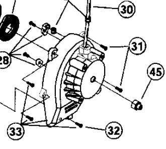

Hi Guys,
I pulled my Bolens Model BL3100 blower vac out to clean up the paths and patio and found it wouldn't start, bit of diagnosis revealed that there was no spark and that the coil module assy was the problem, appears to have open curcuit primary. I have 2 questions for the guru's: how do you remove the drive nut so that the pull start assy can be removed and get access so that the coil assy can be removed, and does anyone know where I can obtain a replacement coil Pt# 753-04463? I have looked on the net and there does not appear to be any suppliers in Oz.
Thanks Keith
Hi Keith,
I take it you want to remove Item 45? Can you post a photograph please? I don't have anywhere near enough information at this point. Just taking a superficial look at the diagram, it looks as if that nut holds the recoil starter together. If it does, why can't you just remove the screws around the perimeter of the plastic cover, and lift off the whole cover and starter assembly, with the nut still holding it all together? That sounds like the conventional way for it to work.
With regard to the replacement ignition module, have you checked the Outdoorking online store? If it isn't listed, you could send a PM to Bruce quoting the part number as well as the model identification, and see if he can help. If he can't, and there is no local supplier, the usual approach is just to buy it from an overseas supplier (being careful to find one with low shipping charges, which usually means one in Hong Kong or Thailand).
Joined: Sep 2003
Posts: 47
Hello Grumpy,

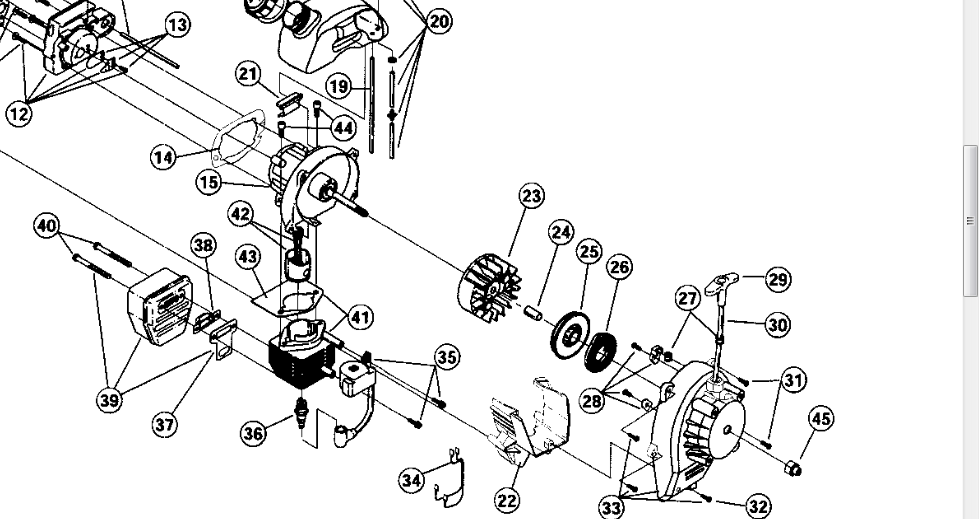

Thanks for the reply, the drive nut Item 45 is the one I need to remove. I have removed the screws Items 31,32,33 which hold the recoil assy onto the engine crankcase. The recoil assy to slide off the end of the crankshaft in one piece if nut 45 was not there. The drive nut 45 appears to be threaded onto the end of the shaft(??). I have tried hold the shaft with small vice grips (only ones I can get on shaft due to access) and applying both left and right hand pressure in case the thread is LH thread and it does not budge.
I have looked on Outdoorking online store and it does not appear. I found overseas suppliers of the ignition module in USA and UK, I will try get a quote from them after I get the drive nut off, bit pointless until then.
Cheers and thanks for the assistance, Keith.
Quite right Keith, it is attached to the crankshaft:
I still have trouble believing they have a hex nut rotating at 10,000 rpm close to the operator's fingers, but that is what the drawing seems to show.
I think the easy and practical way to remove Nut 45 is with a rattle gun. That should do it in much less than a second. If you don't have access to a rattle gun, if you put the longest available ring spanner on the nut and smack it in the anticlockwise direction with a sizable rubber hammer, it should be undone very easily indeed, given that the flywheel is attached to that shaft very close by.

Did the trick with the rattle gun, nut came straight off, slid spacer item 24 and recoil assy off end of crankshaft, removed 2 securing screws and bingo, ignition module removed.
The part number of the ignition module is 794-00008 which is diferrent to the ipb is 753-04463. The -00008 is also used in Ryobi and cadet vacs and MTD vacs as you said. The -04463 is available from Sears online store in USA, if I can't find one locally I will probably get it from them,
