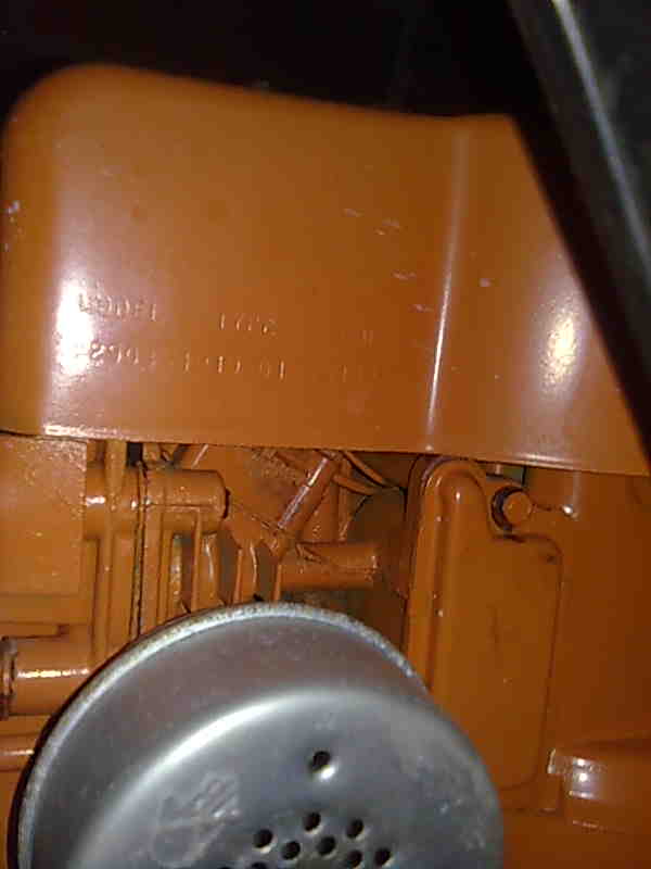

unless someone ground them off they are there leo , ont the tin top (coweling) just above the front of the muffler on the side of the engine , grab a rag n give it a good wipe down 1st then use a torch ? might be hard to see but they are there  . ![[Linked Image]](https://www.outdoorking-forum.com.au/forum/uploads/usergals/2012/10/full-5264-8286-image0047.jpg) dont worry about this muffler its different , but numbers will be there . maybe its been painted , so look close

Leo.
The picture you put up on page 2 with the red circle on the hot bit. I saved that and blew it up. Im pretty sure I can make out a 5.
Above the muffler, about the same height as the throttle cable, on the black engine cover/cowling, there is a number.
You are not making it easy for anyone to help you.

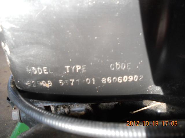

Hi Guys
I finally fund the numbers: Mode 02908 Type5671-01, code:86060902. I am not sure I got the correct No. since It is hard to see. And I will post pics soon.
Posts: 6,926 Likes: 11
That isn't a possible model number, Leo. See if it is by any chance a 92908 rather than 02908, and post a picture of the engine so we can verify that its appearance matches the number. (The picture will also be useful later in this thread.) If there is dirt on the number, wiping it with a rag wet with petrol or kerosene should clean it up.

Hi Grumpy here is the pics ![[Linked Image]](https://www.outdoorking-forum.com.au/forum/uploads/usergals/2012/10/full-6196-8378-dscn3541.jpg) ![[Linked Image]](https://www.outdoorking-forum.com.au/forum/uploads/usergals/2012/10/full-6196-8379-dscn3542.jpg)
Thanks Leo, your engine is a model 92908 made on the 9th of June, 1986. It is 9 cubic inches displacement (148 cubic centimeters), a third generation design, with a PulsaJet carburetor, plain main bearings, and a recoil starter. The 92908 had a vertical pull geared starter, and an automatic choke.
