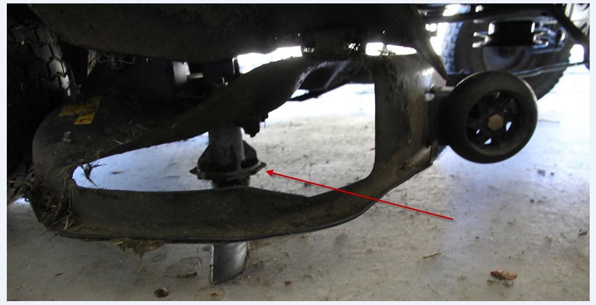

Okay, here's a photo. Taken from the right side, which is the broken blade side. You can see the blade itself sitting low, almost touching the ground? The arrow points to the piece which, on the other blade, sits flush with the deck - I think that piece is attached to the deck in a hexagon shape, attached to a circular hole in the deck, not sure how it's attached though, not welded.
I need more pictures, to understand what I'm looking at. It looks as if that pic is taken through the grass discharge chute, toward the blade. It also looks as if there is no blade plate, or swing-back blades, but rather a single one-piece blade ("ninja blade"), and its length is the full cutting-width of the mower. It may be mounted on a boss on the bottom of the shaft, and the bearing housing may extend all the way down from the center of the deck to that boss. The bearing housing would then be bolted to the deck, and the shaft would continue above the deck to the V belt pulley. The bearing housing may be sitting vertically, and only the blade is tilted. I need to see a picture of where the blade mounts on the boss on the bottom of the shaft, so I can see whether the blade is bent, or it has come loose on the boss and is in the last stages of falling off the mower. It may have dealt a fatal blow to the deck, above the right side of the grass chute, slicing into it several inches. When it did that it may have cut the belt.
Yes, i was holding up the grass discharge chute with my other hand.

So, this is a twin-cutter deck, and only one of the two cutter systems has been damaged - the other one is still able to rotate and the blade runs straight on that one?
I think you have said that the right-side bearing housing, complete with shaft, belt pulley and blade, is no longer attached to the deck. So, presumably either the mounting bolts fell off, or the housing or deck is broken where the two should be bolted together.
(This is a top view of your cutter bearing housing, showing the belt drive pulley and the mounting bolts that hold the housing to the deck.)
That suggests the reason the ninja blade is not parallel to the ground, is that the entire bearing housing is not vertical, but is tilted laterally relative to the deck. The ninja blade is still at right angles to the bearing housing? I can't see from the above photograph because it is lateral to the mower, and the tilt is lateral also and therefore does not show.
If that guessed description as to what has happened is correct, please ensure that the next batch of pictures show the top of the bearing housing, below the belt pulley, where it should be bolted to the deck but now isn't. I'm trying to figure out whether the bolts simply fell out, or the housing or deck broke, thus causing the two to separate.

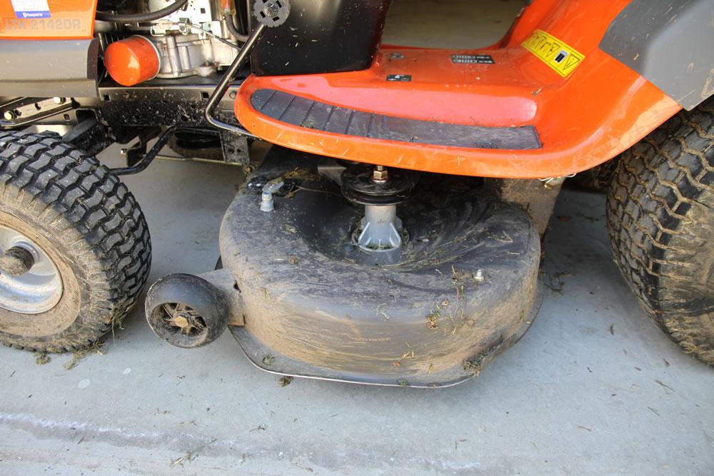

Here are two photos of the good undamaged side.
A long shot and a close up.

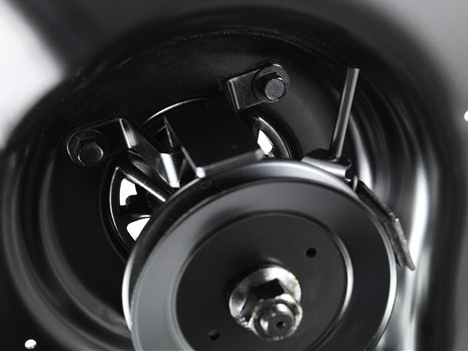

In the close up pic, you can see that the pulley is at the top of the shaft.
The shaft is bolted to the deck with four bolts, they're visible but not very clear in the photo. And the blade is attached to the shaft underneath the deck.
In the damaged side, the shaft has sheared off at the point of the four bolts. The four bolts are still attached to the deck, but the shaft is no longer attached to the deck and has dropped through the shaft hole in the deck.
As far as I can tell the deck is undamaged.
On the good side the blade seems okay, it spins cleanly and I can't see any damage.
On the damaged side the blade also seems okay, although it's hard to be sure.

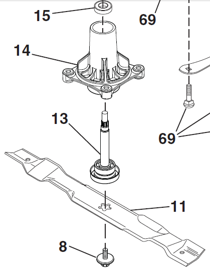

What I'm calling the "shaft" is the circular piece visible in the pic above that holds the pulley, is bolted to the deck, and holds the blade underneath. What is that really called, is that the bearing housing?
Yes, that is the bearing housing. The shaft is a round solid piece of steel inside it. The pulley is attached to the shaft, not the bearing housing. Here is a drawing of the assembly, from the illustrated parts list:
Item 13 is the shaft, Item 14 is the bearing housing. Item 15 is a ball bearing. There is another ball bearing already on Item 13 - looks as if you can't buy it separately from the shaft.

That diagram is really useful.
Number 14 is the broken piece. The bolt holes, along with the bolts, are still attached to the deck. The rest of number 14 is not.

There appear to be two damaged components: the bearing housing, which Husqvarna calls "Housing, Mandrel", part number 532 18 72-81, and the deck, which they call "Mower Deck Assembly, 42"", part number 532 43 98-17. There seems to be some ground for suspecting that the design of that housing is not good, and this may have been a factor in the fracture. The fracture in turn caused the destruction of the deck when the blade hit the top of the grass discharge port. When you have the complete housing assembly removed, and we see some close-up pics of the fractures of the attachment points, and the condition of the deck around the housing's mounting holes, we can discuss this further.
For your own interest you may care to download the entire illustrated parts list for your mower, from here:
http://m.husqvarna.com/ddoc/HUSI/HUSI2012_AAaa/HUSI2012_AAaa__96041023601.pdf

The feature inside the red circle looks like a huge gash in the deck to me. It may just be the camera angle - perhaps you could photograph it from a different angle so I can make a different interpretation?
If the blade is not damaged, I don't see what would have caused the Mandrel Housing to have broken. It is a fairly major component, produced by expensive tooling, so it seems unlikely they are regularly snapping like carrots on all the Husqvarna mowers out there, especially since I haven't seen any specific complaints about it.
Here is a suggested approach to dismantling the the Mandrel Housing - you need the right tools, plus care and patience, and I suggest you stop whenever in doubt and come back here with some photographs rather than applying brute force. The aluminium housing is easily damaged (not too important, since it's broken anyway) and the shaft and bearings are not all that robust either.
First, you will need to remove the belt pulley (32), which is held on by a retaining nut (33), but the pulley is also likely to be a tight fit on the shaft (13). According to the illustration there is no drive key. I suggest you hold the blade (wear gloves and wrap the blade in thick cloth as well) while you undo the nut with a suitable ring spanner or socket. See if the pulley can then be pulled or levered upward off the shaft. You also need to remove the spacer (31). Having removed those parts from the top, remove the bolt (8) that holds the blade on the shaft, by holding the blade again and using a socket spanner. You are then ready to remove the shaft (13) from the mandrel housing (14) by placing the housing over something like a block of metal with the right sized hole in it to clear the outside of the oil seal at the bottom of the shaft, while providing good support all the way around the housing. Normally you would then apply downward force to the top of the shaft with a hydraulic press, but I'm guessing you don't have one. If so, you will need to place a piece of hardwood on the top, threaded end of the shaft while supporting the full circumference of the bottom of the housing on the block of metal with the hole in it. Tap the top of the piece of hardwood with a hammer, to drive the shaft downward. There will be moderate resistance to moving the shaft because the top bearing (15) will be a tight fit on it, and the bottom bearing (shown on the diagram but not identified separately) will be tight in the housing. The shaft needs to slide through the top bearing, and will probably take the bottom bearing out with it when it moves downward. It is just possible though that it will slide through the bottom bearing as well as the top bearing, leaving both of them in the housing when it comes out.
If you can remove the shaft and bearings from the broken housing without damage, and if the deck is undamaged, you may just need a replacement Housing, Mandrel from your Husqvarna dealer to get the mower back into action.
