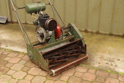

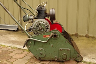

This year I've bought two Scott Bonnar reel mowers on ebay, a Supercut and a Model 43, both with 155cc Scott Bonnar engines and both from the early 1960s. I need a couple of fuctioning Magister Capacitator Discharge Units for these mowers. I tried three old units and none were any good. A friend has the technical background and interest to attempt to build some units. I've attached a letter which adds a little to the great information obtained by a Forum member from Motor Cycle 1963. I've also attached photos of the mowers. I'll let you know how we go with this.

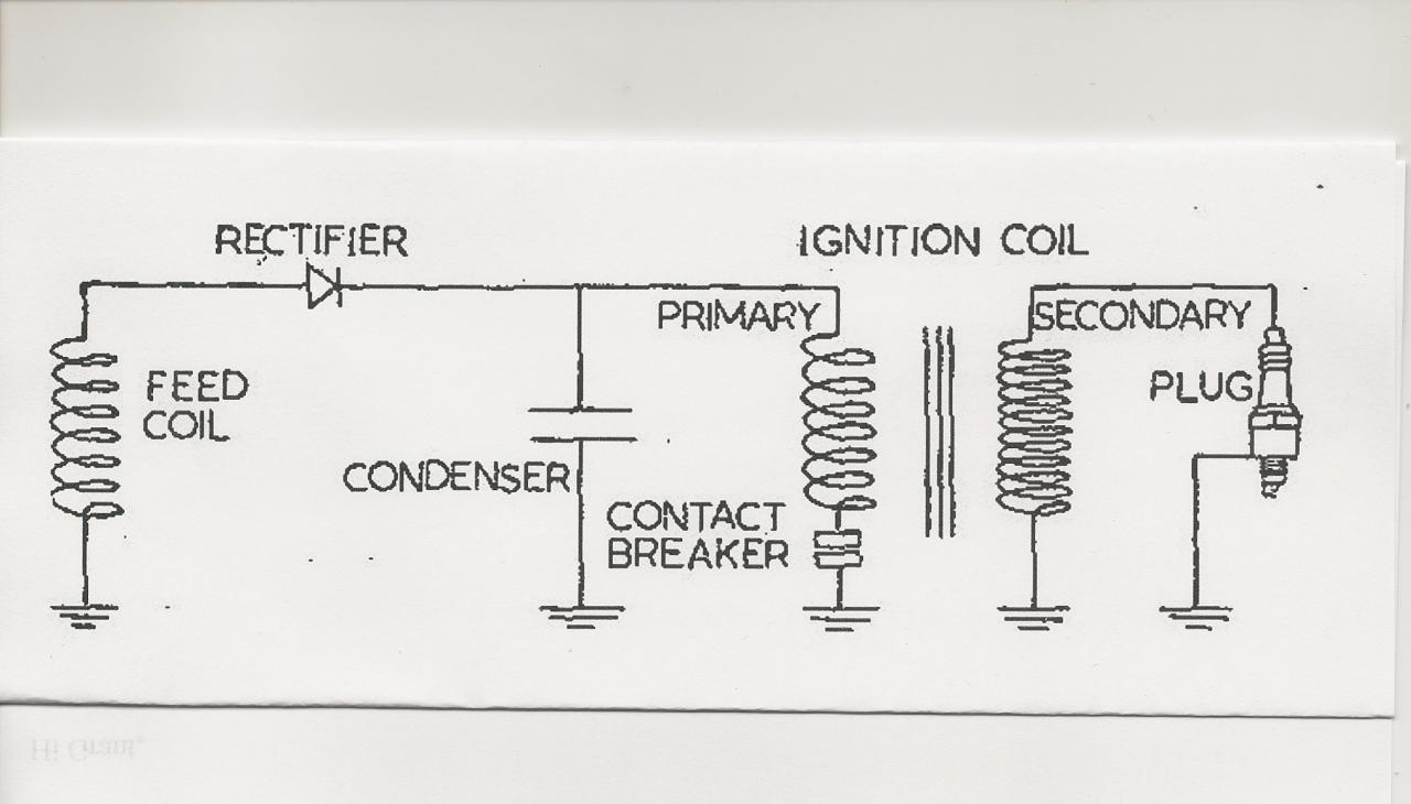

Just looked up in text book, with just one diode that is called a single phase half wave rectifier.
As Grumpy said, it is choppy dc, diode blocks the negative half cycle of the ac waveform produced.
Voltage across the load coil,(primary coil) would be, 0.45 x ac Voltage produced by your supply coil.

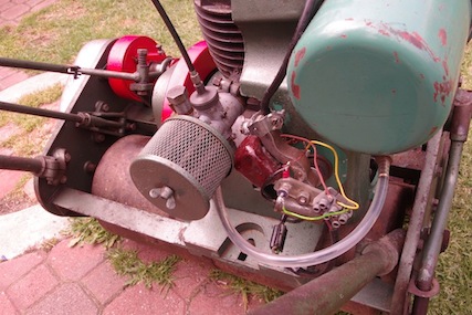

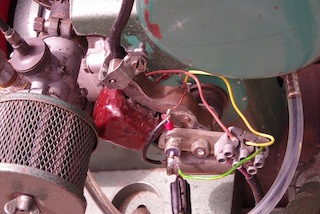

Thanks for your technical input which will help us refine the job. Ron made up the trial Capacitor Discharge Unit shown in the photos using items from his shed. The engine pictured runs well with the unit and ticks over very slowly when idling. However, the spark is not impressive.
You can identify the main items: the coil is from I think a Suffolk 4 stroke with 3 leads from the coil, the condenser [capacitor] is a .22uf normally used in small engines and also a diode [rectifier].
These 3 items are wired up as in the diagram and connected to the original 3 leads coming from the flywheel unit: feed coil, points and earth.
The next step is to assemble a tidy looking unit contained in a plastic box. [Linked Image]
Thanks for that progress report, Grant. So you are using the original Magister feed coil? Can you measure and report the voltage across the condenser when the engine is running? Is the 0.22 microfarad condenser a standard Kettering ignition condenser?

Ron's Capacitor Discharge Induction set-up uses the original Magister feed coil and points, and the condenser we used in the external unit is a standard Kettering type. It would be interesting to see a voltage measure across the condenser and I'll see what I can get. Presumably the high voltage pulse through the coil is "stored" in the condenser and this part should be critical for the unit to work effectively and to last. Regarding the high apparent failure rate of the external units, it is possibile that in miniaturising the original unit, the coil itself was too small or fragile for the job.

looking at your ignition diagram, the capacitor would have to be polarised, i.e. have a positive terminal, as it is applied to rectified dc voltage.
I will let you know, this the first time I have been exposed to this set up with a feed coil.
The normal mower set up, the capacitior is applied to ac voltage, so would not be a polarised type.
Just something I noticed.
It will not be an electrolytic capacitor Mark. The Magister is a sort of el cheapo Capacitive Discharge Ignition - the capacitor is the hardest working component in the system, and it experiences wild voltage swings and high currents during each spark event. It may or may not actually have reverse voltage applied, but it covers a wide voltage range. Normally the capacitor is an encapsulated plastic type.
Note also that CDI capacitors typically run at 300 Volts, and very small 300 V electrolytic capacitors are not a common component. This is not the reason electrolytics aren't used (they are filtering capacitors, unsuited to complete discharge and recharge 400 times per second, in the case of a CDI on a V8 at 6,000 rpm) but it would be a problem even if this type of capacitor were otherwise suitable.

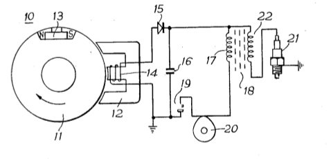

This is the circuit diagram from US Patent 3037148, class 'Ignition Systems for Internal Combustion Engines', filed 28 Dec 1959, granted May 1962.
Invented by George Gayler, and assigned to Wipac Development Ltd.
The major components here are :
11. Flywheel
12. Feed Coil stator
13. Flywheel magnet
14. Feed Coil ~ 4-5,000 turns
15. Rectifier diode
16. Condenser/capacitor, 0.2 microfarad
17. Primary winding of 18
18. Voltage transformer coil, 70:1 turns ratio
19. Contact points
20. Points cam
21. Spark plug
22. Secondary winding of 18
The three Magister module low tension wires are connections from the feed coil 14 [to rectifier 15], points 19 [to the primary of the transformer coil 17], and chassis earth. This isn't shown very clearly in the circuit diagram as drawn, though. The next patent listed here, 3175122, does a better job of showing 'modular' construction.
Note that the transformer coil shown here is wired a bit differently ['autotransformer' configuration] to the production Magister in grumpy's earlier post, but the patent covers both variants. Production 'Magister' ignitions would very likely have differed a bit in construction detail from the patent examples; these aren't rigid specs. Production units would have been optimised for the mass production processes in use, and the situation they were to be used in.
The essential bits from this patent, summarised:
Operation: The capacitor is charged with the contact points open. When the points close, the capacitor discharges through the primary winding of the transformer coil, inducing a high voltage in the secondary winding and causing a discharge across the electrode gap of the spark plug.
The Feed Coil - details for two examples are given:
Type 1 was 5,000 turns of 36SWG aluminium wire. This generated increasing voltage to a peak of 250V at 2,000rpm, then declining to 225V at 3,000rpm.
Type 2 was 4,000 turns of 34SWG copper wire. This also generated 250V at 2,000rpm, but then kept on increasing, to 325V at 3,000rpm.
The transformer coil
- specification of 70:1 turns ratio, and inductance of 20 microhenries measured across the primary winding.
Gayler, and a Reginald Penn as coinventor, filed another patent in this class on the same date, which covers operation of this ignition circuit, and several variants of it, from any AC current source; US Patent 3175122, granted March 1965. The low voltage alternator variants had two transformer coils.
The construction of the transformer coil is most probably along the lines of yet another patent, also filed on 28th Dec 1959, but not granted until August 1965. Inventor was Reginald Penn, US Patent 3202950, class 'Step-Up Voltage Transformer having High Tension Lead'.
This describes a very compact cylindrical transformer, wound on an insulating tubular former with a ferrite core, and the primary winding wound over the secondary.
In the patent, the 'working example' dimensions of the former tube are given as 0.75" long, 0.13" ID, 0.15" OD. Over this is wound the 47SWG enamelled copper wire secondary; described as one layer of three turns plus 15 layers of 193 turns, with paper insulation between layers. Then the primary winding, of 33 turns of 36SWG wire. This gives a turns ratio of ~88:1.
Again this was a 'concept' example, and not necessarily exactly the same as the production units. But it does look a very good match dimensionally for the known Magister examples.

Perfect....Thank you gadge,provided the trans coil is obtainable this should be fairly easy.
I dont need to make the feed coil since its already there and looks to be example 2 since mine is copper.
Ill show this to my boy and see what he thinks...if the coil is small enough i may even be able to reuse the original casing and reseal it smile
Thankyou for your efforts...Outstanding!

Thanks Gadge, that has validated the interpretation we had of the Magister (that it is simply a crude capacitive discharge ignition system, with a very small charge capacity and therefore a very small capacitor). More importantly, it has confirmed that it uses a typical charge voltage (about 300 Volts) and has given component values and coil-winding data. There seems no obstacle now to anyone with sufficient enthusiasm, repairing or restoring Magister systems.
I'm a bit doubtful about the wisdom of having used aluminium wire on the first version of the feed coil, partly because it is about three times the bulk of copper for the same conductivity level, and partly because unless it is high purity, it is difficult to protect from corrosion over the long term. However from the restorer's point of view, if the feed coil armature has room for aluminium (as, it seems, it must), there should be scads of room to rewind it in copper.
Personally I'd still like to know more about the physical layout of the encapsulated parts in that bakelite "earphone" housing. It will also be interesting to see whether people find convenient ways to remove the epoxy or whateve that potting material is, without damaging the earphone housing.
Yes its epoxy resin and I heated the unit to get the components out. Casing is fine and ok to reuse,the components are not. My initial thought was an epoxy covering,unfortunately the Whole system is filled. The wires,switch contact and HT screw go in,then the components are fitted and soldered,then the whole unit is flooded with resin.
I can see no way possible for failure due to moisture as initially thought. Instead id be more inclined to say it was due to possible overheating.
anyways im gonna give it a go....Not a job id recomend as far as redoing the original,but ill try anything. I think the manufacture of a new unit by restorers may be a better proposition and could be integrated into the system neatly....
Complete system in the flesh.....sealed unit has been stripped of components.
So it can be done...what remains to be seen,is whether the parts can be sourced and then fitted to its original housing. I am however optimistic it can be done.
Nice pictures, Blue. If you test the original components, you should easily find which ones work and which ones don't. The most likely component to fail, is the capacitor (condenser). I'm guessing that you will put it back together with some more convenient type of protective material than the original - maybe some RTV silicone adhesive?
Yes possibly,but I do have easy flow epoxy and might is it just to secure the parts as silastic will be more destructive to the unit if removal is necessary. Ill make a cover plate and seal that.
Agreed on the Condenser/capacitor Grumps as it had a weak spark before I stripped It.
did everything to boost it...new lead points checked and rechecked and all connectiins redone....but barely any change.
One thing im curious about is the switch and BM strip. I always assumed it eas a cut out and closed on overheating....but in a prior post it says its a switch,which on dismantking proves this...BUT... I only got spark when the strip was not touching the switch contact.
Anyways lets see what happens as we go along
Thanks Again Gadge and Grumps for your help and input
