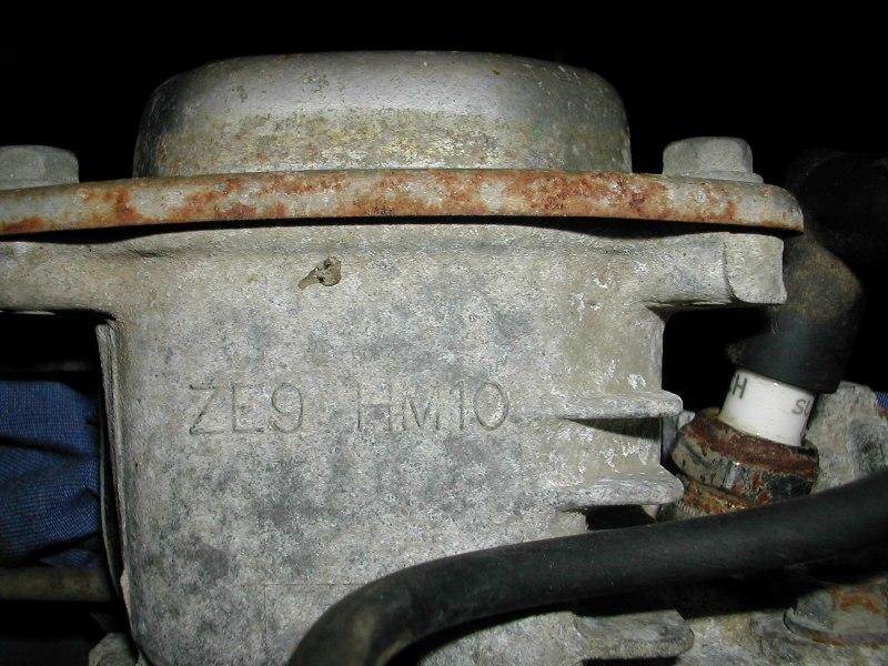

This mower has fell into my hands, only the second one Ive ever had.
My father claimed the first one, it was a GXV160.
I have looked for numbers, see below:
Cant see any of the prefixes mentioned above though.
Sticker on the base reads: MZBG-5090195
19 inch blade disc.
I will be giving this one some attention starting today.
Johno, it sounds as if my information on the Honda codes is incomplete, or that code you have found is something else, not an Engine Type.
Mark, this is where you find the serial number:
(Illustration from Honda workshop manual)
Joined: Feb 2011
Posts: 510
Thanks Grumpy, I woundnt have found those, the numbers are nearly gone.
My GXV140 numbers are:
GJAB 7717698
MAH*
This engine is made in the USA, I found it written in between the flywheel fins.
If my information is correct Mark, all GXV140 engines have the GJAB prefix, which in turn means they were made in USA. Once again, I've never heard of MAH*, except that it happens to be below the engine number prefix on my HRU195 as well as yours. It is possible it, like Johno's MAJ*, is some kind of export identifier.
Joined: Feb 2011
Posts: 510
My apologies to all. I realise what I have done now.
