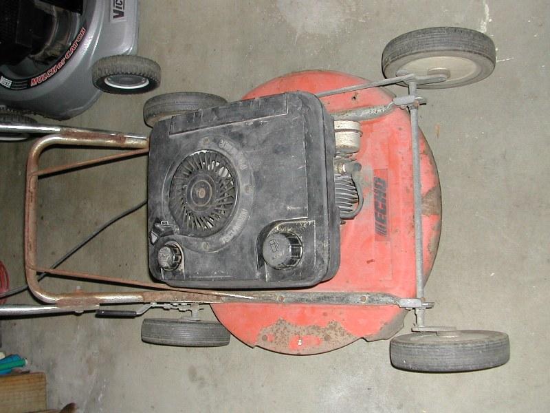

Just thought I would share a pic of my 2 Suzuki's.
These are great for slopes/trimm mower.
A nicely running engine sounds like a Ferrari, they are light to push and use very little fuel.
I drill new mounting holes and swing the boss and blade plate across.
They make a nice looking BigBobs.

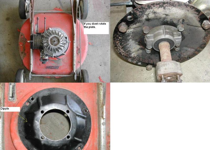

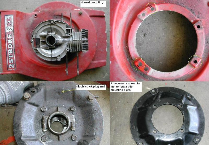

You have saved me some time & effort, I have started the next 21 inch base powered by a Suzuki 2 stroke.
The last 2 of these I did a while ago now & like a cave man just started drilling, when I didnt need to.
Didnt occur to me at the time that I could unbolt & spin the mounting plate.

I have placed a suzuki engine on a Flymo, Victa, Masport & the big bob base.
The only way the holes will line up, is with the plug pointing out to the side. (like in the image above).
So, this time I will take the mounting plate off, rotate it so the dipple is pointing over the grass shute, then rotate the engine so plug is facing forwards.
Hey, I dont have to gin around as much this time, its all good.
I just went out & placed a 4 stroke on the rover base it uses the other set of holes, so this means the reason the ROVER base has two sets of holes.
Is one set of holes is to accommodate the suzuki engine.
Actually i think you might find that its just that the suzuki base mounting plate is 90 deg around on its crank case mount for some reason.
If you put that same 4 stroke around plug to the side the holes will line up.

I placed a briggs engine on a rover base like in the image & the mounting holes line up with the Suzuki holes.
You will find that the briggs can be easily turned to hae the spark plug facing forard by using the other set of holes, some of the older rovers have the engines sideways like that most of the nwer ones have them facing forward. Same as the victa bases, there are two sets of holes for either orientation as some of the 4t's were sideways (and the powertorques used these holes also) while the others were forward facing...

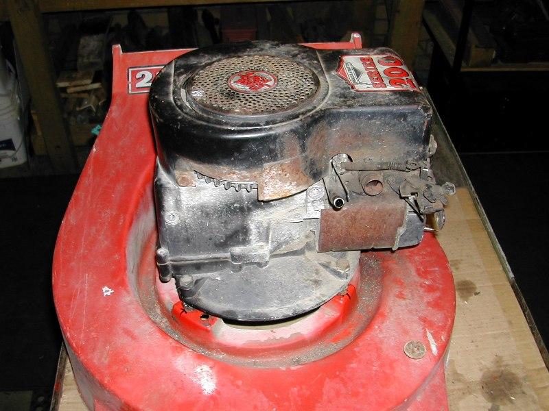

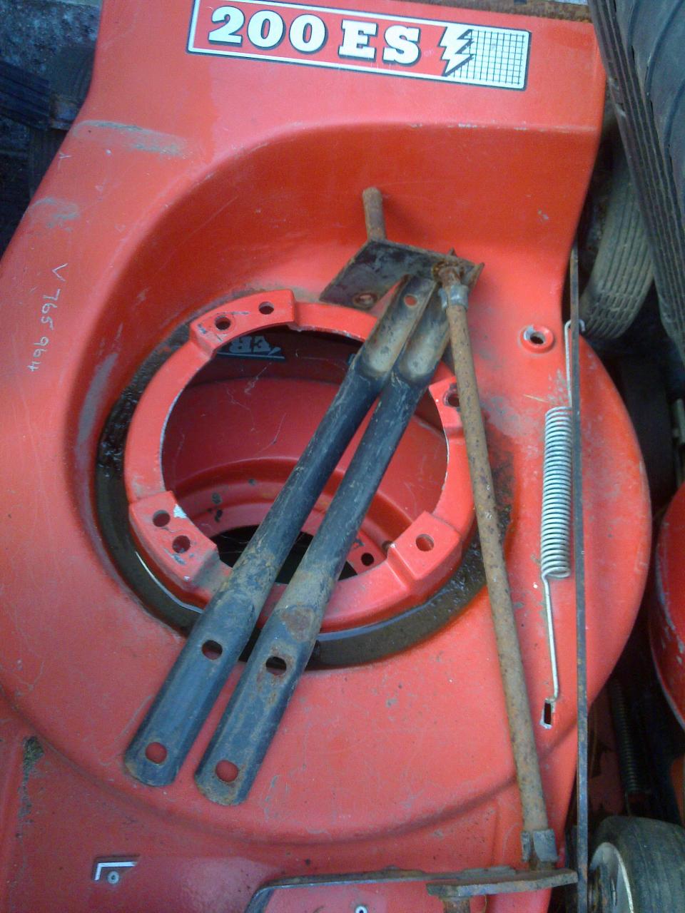

Heres the base on the top of my stack.
So they are dual drilled.
That one you posted up looks like its been drilled, i see shiny aluminium.
